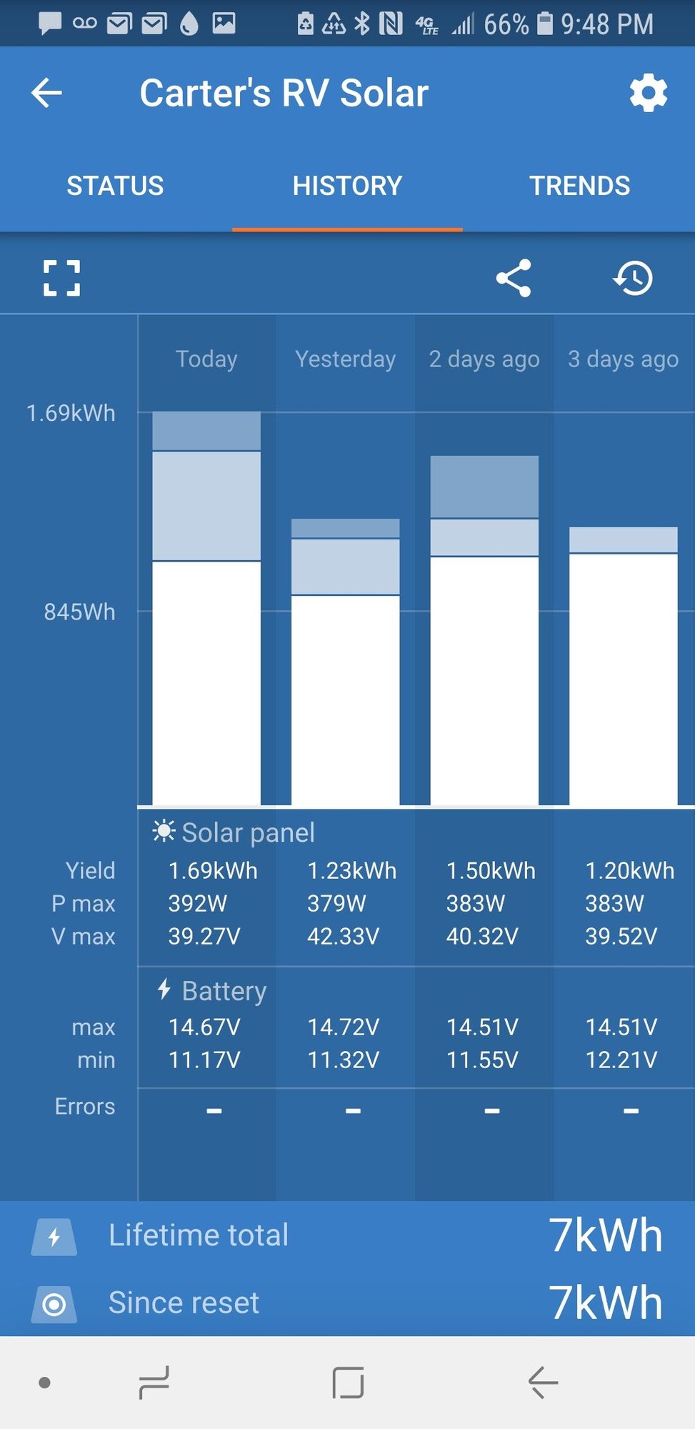

From: DFW
Silverton, Co
Silverton,Co boon-docking trip with 400 watts of solar.
Had a blast will be going back next year.
No Excursion hope y'all let me keep posting...
The view from our site.
a ittle fishing hole we found.
Daily solar production from 4x 100w panels. This was the game changer.
