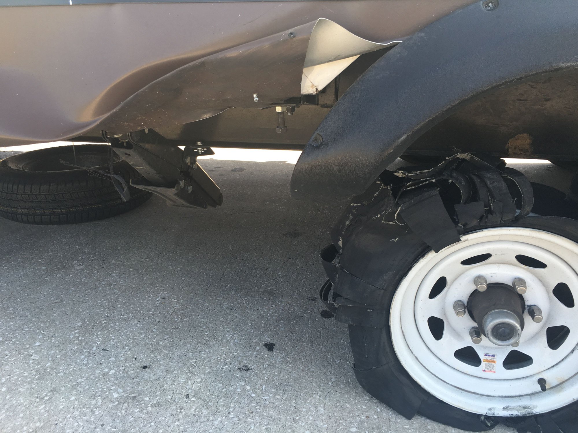

Tom we just made two big hauls one down to Key West and the other to Orlando. On the trip to the Keys we blew 3 stock tires on the TT and screwed up the steel wheel and marred up one Aluminium wheel. the Curb side of the trailer took some pretty good damage one time. On a previous trip I had a blow out and replaced it with a Dynatrail Tire E rated with a 75 mph speed rating. The Dynatrails are made by Doublecoin. I now have 5 tires all in load range E that are made by 5 different Manufactures Including a Maxxis. When on the road there is very few tire shops that carry more than one ST tire. At least that was my experience. FWIW i am **** about checking tire pressures in the morning before we leave and checking temps at every stop. Which is usually 250 miles
On the trip to Orlando there was no problems with the tires at all and we drove straight home from there.(12 hrs)

Kelly, I'll be most likely going with the Sailun S637 in 235/80R16, they are listed as STs but are built more like a typical truck tire and are rated at 4,080lbs and 75 MPH. They are from China but out of an ISO rated factory and have very good reports from RV users running heavier rigs than ours.
We lost 1 of our TT's factory Power King ST tires back in July, luckily it didn't come apart and I found the broken belts and sidewall separation at home in the driveway. On Friday when getting some measurements for the items I ordered I found another tire with a bubble at the sidewall/tread shoulder, again on the inside sidewall but the same side as the other failed tire. These tires won't travel another inch under our TT.

I still find it hard to believe that Jayco or any manufacture would put this on their product. During the Key west trip I kept trying to purchase more tires at each blow out stop but it never worked out for me. I am also going to purchase a second spare. If I start having trouble with these tires I will follow your lead . Tire Blowouts Suck!!!
Worth every tire blow we had

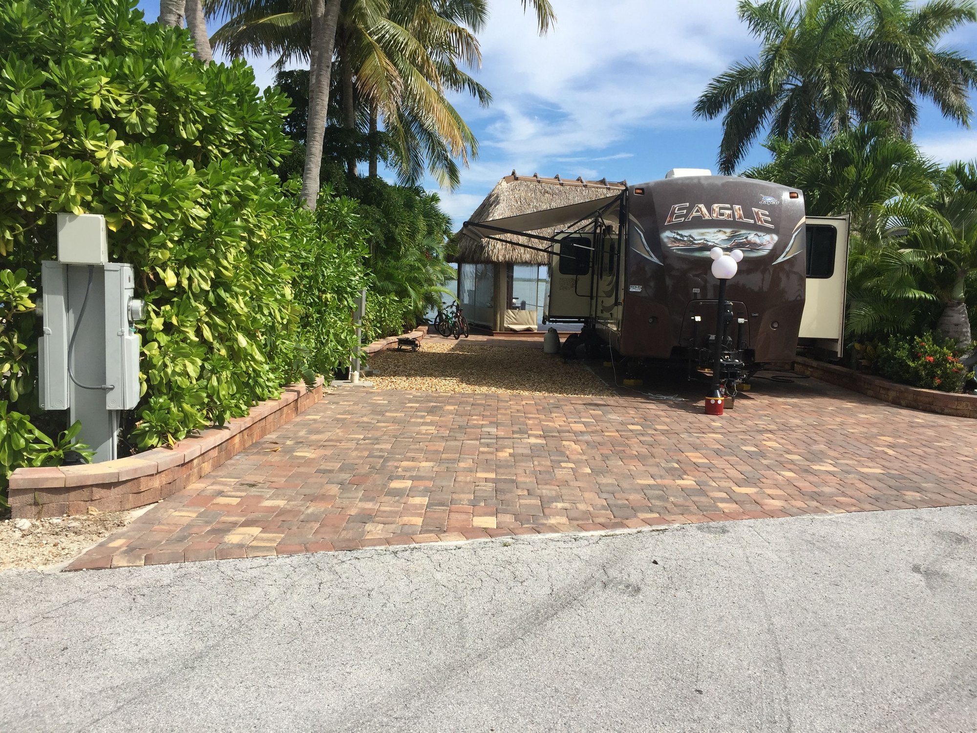

Private Tiki Hut on site Pretty Awesome
Key Largo John Pallencamp State park
