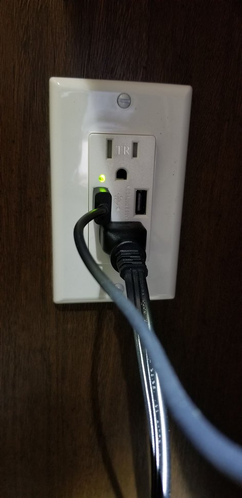

Thinking of this mod myself, Lowes has a black outlet for about $30. Do the USB ports charge ok?

Removed the original outlet next to my bed and replaced with one with 2 usb plugs. Less of a spider web now.

On mine, the USBs are 2.1 amps each. Certainly charges my Samsung phone fine, but won't do the 'quick charge' or 'rapid charge', whatever Samsung calls it. I did have to trim the hole larger to fit the single gang box in the hole, where the factory RV outlet was not in a box at all. I should have done this long ago. I will be getting another to put in the outdoor kitchen where we charge when we are sitting outside.

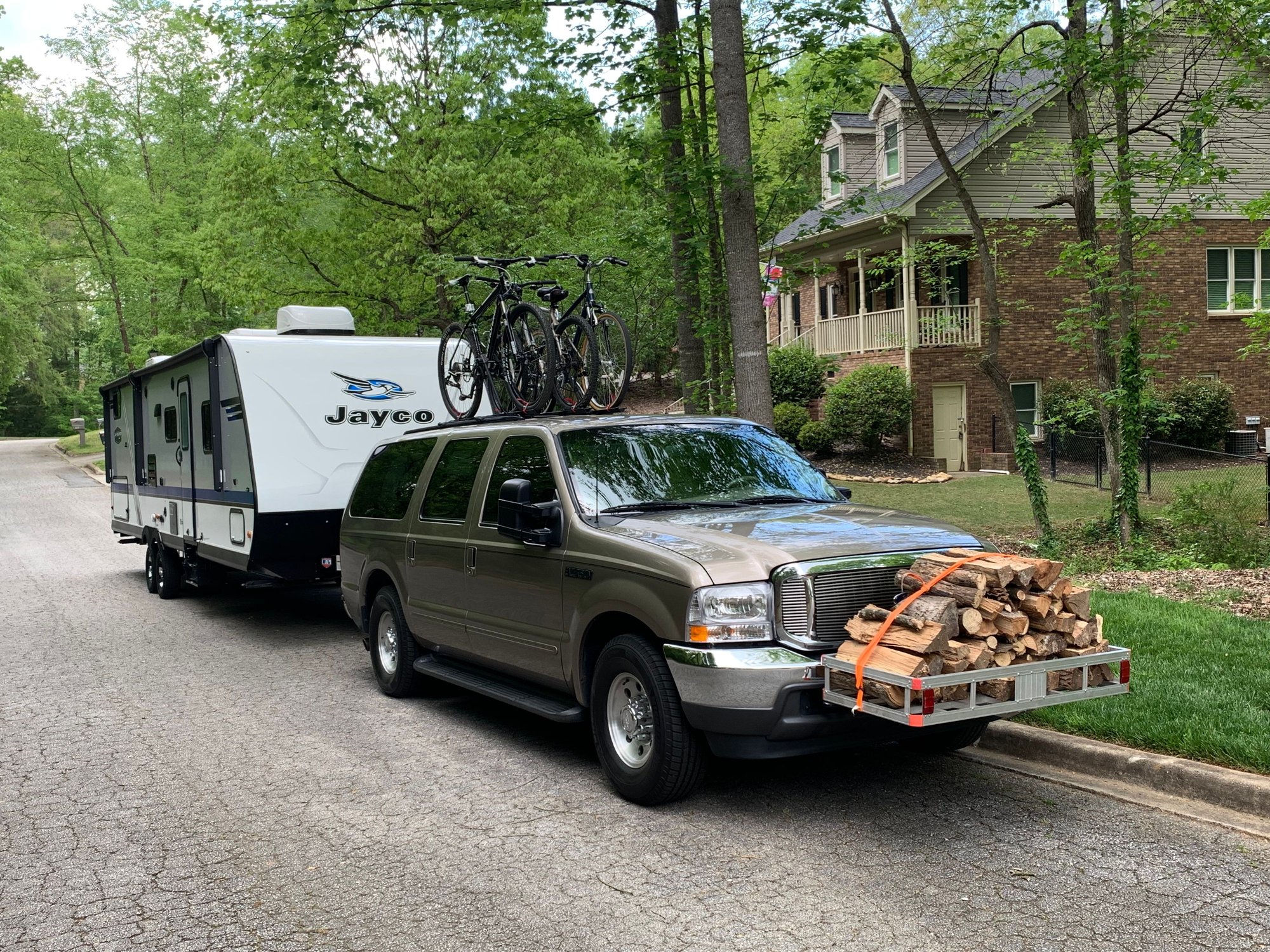

Hitched and ready to go for a Easter weekend camping trip at the local US Core of Engineers park at Twin Lakes on lake Hartwell in Anderson, SC

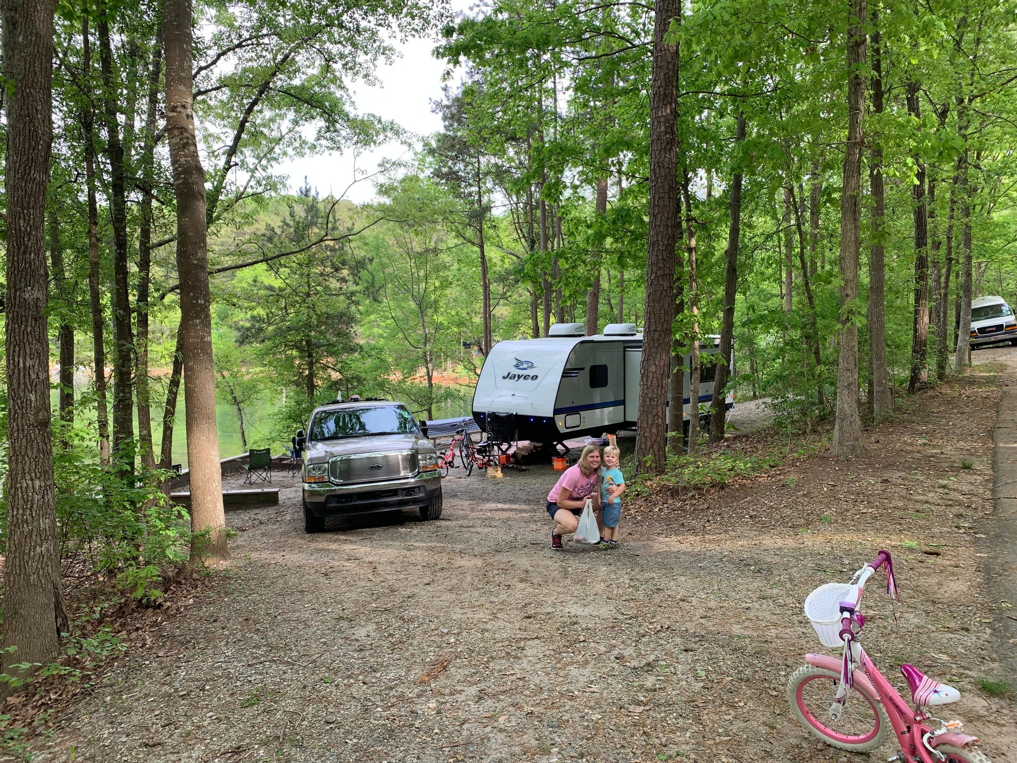

Setup and enjoying a nice cool evening, praying for the rain they are calling for won’t come!

Nice looking spot. I just watched the weather for Raleigh, you better batten down the hatches for severe weather.

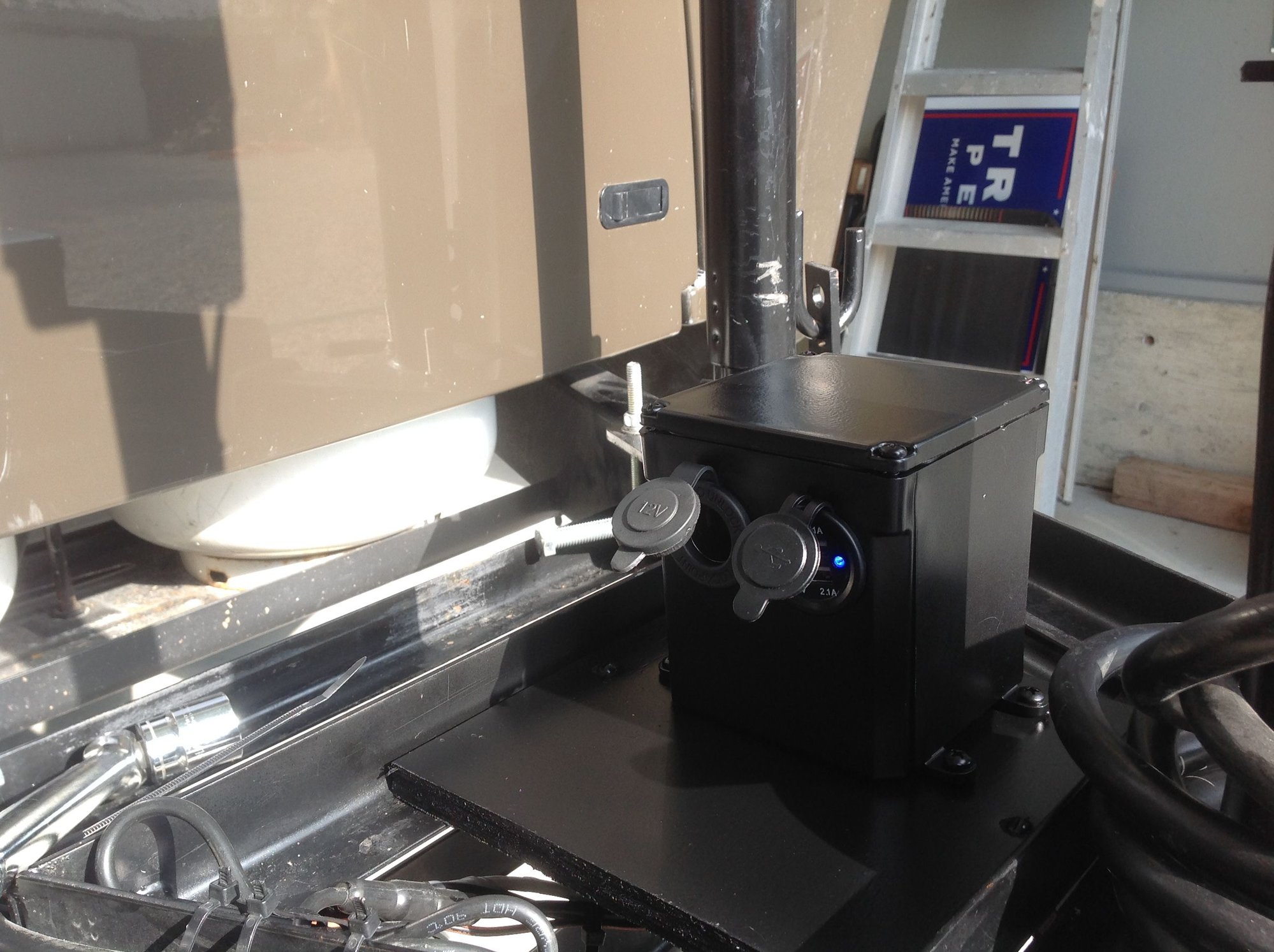

I have this wired into the 12v system.

Nice looking spot! We are not camping this weekend, the park we would go to is flooded, the Army Corp of Engineers can't release the water fast enough.
Doesn't the wood on the front impede airflow to your radiator?

Yes it does/would, but this trip was only 15 miles from the house and no major hills or anything so I wasn’t worried about it. I have an auxiliary trans temp gauge so I kept an eye on that to monitor cooling efficiency. I would not do it for a longer trip.

Time for a receiver on the back trailer bumper... if it's robust enough.

yes, that is another option, but I am already pushing the GVWR for my trailer which is 7500 and I would want the hitch bolted or welded to make sure it was strong enough.
