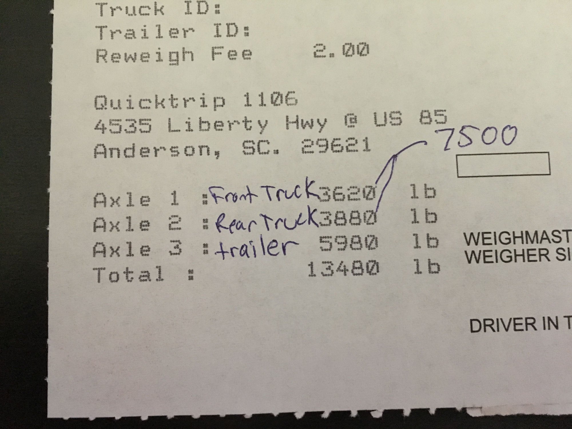

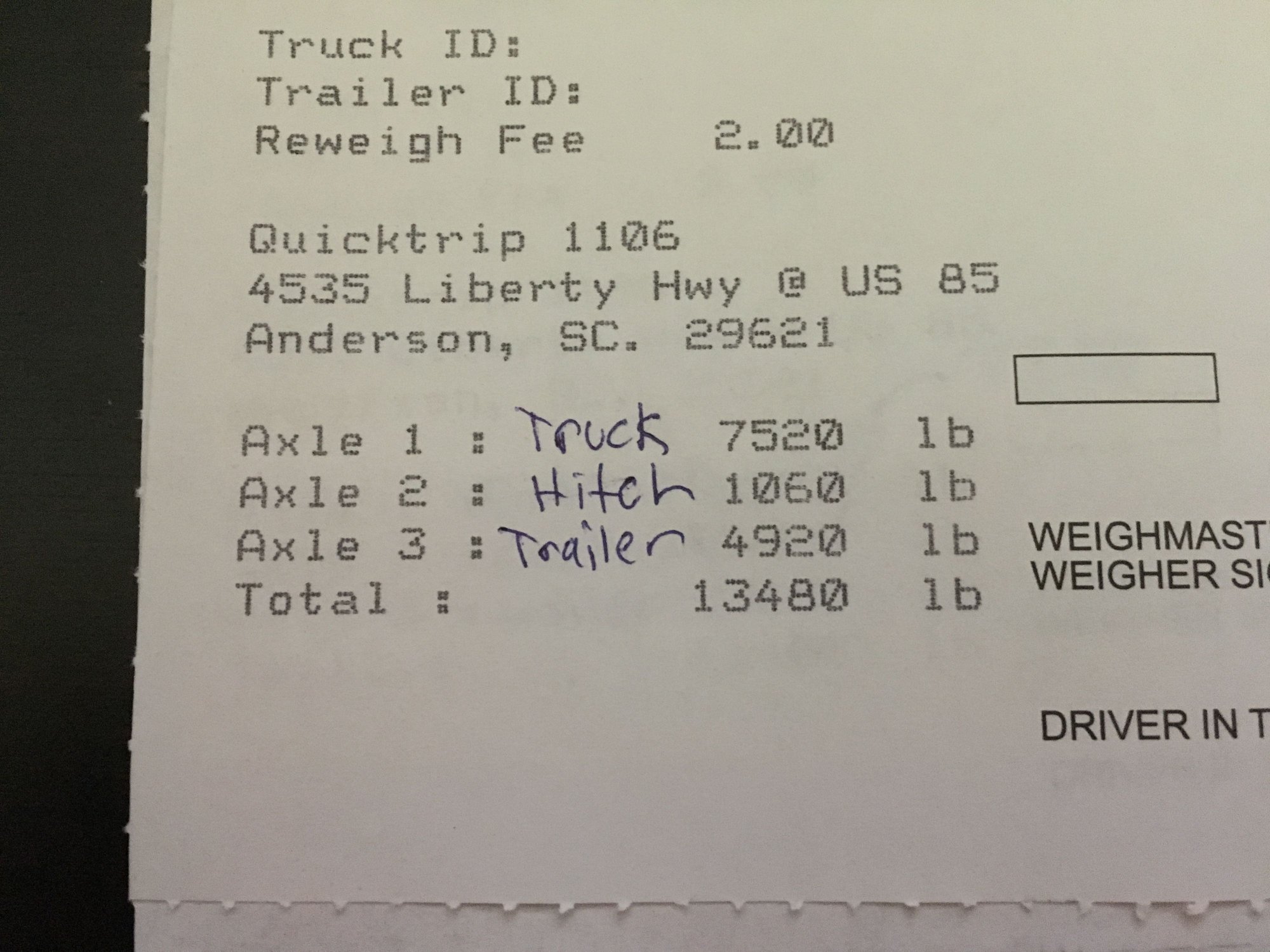

WD setup help..Scale Weights below
So I went to the scale today with the rig and family to get full weights. Before I left I took a pic of my WD bars sitting on almost level ground. To me it look like I may be over tensioning them, such that I do need the 1000# bars (I confirmed my current ones are 800# bars).
close up of bars before going to scales
pic of whole rig before going to scales
1st weigh: truck axles split and trailer on other scale
weigh 2: trucked detached from trailer on its own scale and trailer leveled with tongue on one scale and axles on the other
weigh 3: truck detached and entire trailer on one scale and truck axles each on their own scale
So after this I realized A I have too much tongue weight. Calculation works out to ~17% and with that tongue weight I need heavier bars. The problem I realized is that the way our trailer is made with a rear slide that pushes a queen bed out the back, all the storage is up front, so I have bikes, hitch gear, two spare tires, picnic table, etc. all stored in the front of the camper. I came home and adjusted some and the wife and I discussed that I could put bikes and or spare tires in the truck when towing, but my main question is would I be ok to simply get the 1000# bars and level the rig out for towing, or am I risking damage to the front axle of the trailer with the excessive tongue weight even if I can manage to distribute the weight to the truck better? Give me your thoughts. Other plan I have is to buy a receiver adapter for the rear bumper of the trailer and put the two adult bikes that are on top of the Ex onto the back of the trailer. They are at least 50# total, so that should help.
Thanks,
Kevin
Ideally, you want the front axle of the truck to weigh the same with or without the trailer. The bars you have don't look too tight at a glance, but they do seem to be giving their all.
I would not want the trailer tongue weight below 800 lbs. That 200 lb difference won't mean much to the trailer axle. I've never seen a top limit published for trailer tongue weights, but I doubt 1000 is a problem to the trailer frame or axles. In most cases, that extra tongue weight will just make it a bit more stable while towing.
The numbers say you need 1000 lb bars which is what I would do in your case. Move a couple things towards the back and I think you'll be good to go. I would not hang a couple bikes on the rear bumper of the trailer, those bumpers just aren't made for that sort of stress.

As long as the trailer can handle the 1,000 lbs tongue weight you should be ok.
Here's a better scale measure process:
1) Truck only - front+rear (wd bars in back of truck)
2) Truck + trailer (WD Hooked up) truck front, truck rear, trailer
This will tell you how the WD is working based on all three weights. For example if your front tires are getting unloaded and load on the rear axle.
3) Truck + trailer (WD not Hooked up - bars in back of truck) truck front, truck rear, trailer
This is used to calculate the tongue weight. With the WD bars hooked up some of the tongue weight is back on the TT tires.
For an initial WD setup.
1) go to flat surface.
2) Put masking tape over front tires
3) Mark a line: note height
4) Hook up trailer and NO WD
5) Note the height - will be higher
6) Adjust ball angle/chain links until the line goes back to either
a) The first line mark - or slightly higher - never lower.
or
b) 1/2 between the first two marks
Old Jul 2, 2017 | 12:34 PM

Thanks Exxwhy and tjmike for the feedback. I just ordered the 1000# bars and will try the next weigh up as recommended by tjmike. Also I will put kids bikes in the back of the Ex and move a few more things to the back of the trailer to see if I can take a little tongue weight off. I repost with new numbers in about 2 weeks as I will weigh on our way out on the 13th of July.
-Kevin
