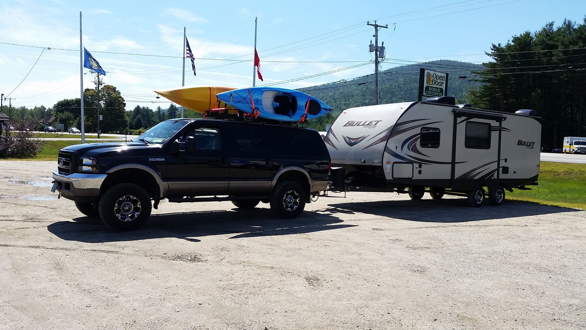

Stopped for lunch on the way home from a week in the mountains yesterday. Always seems like a couple more days camping would'a been just right.
We had great weather most of the week and were able to do some tubing and kayaking.
