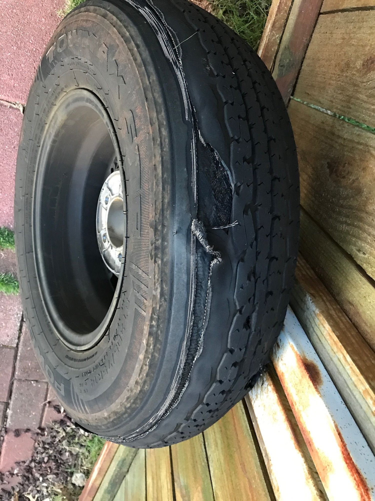

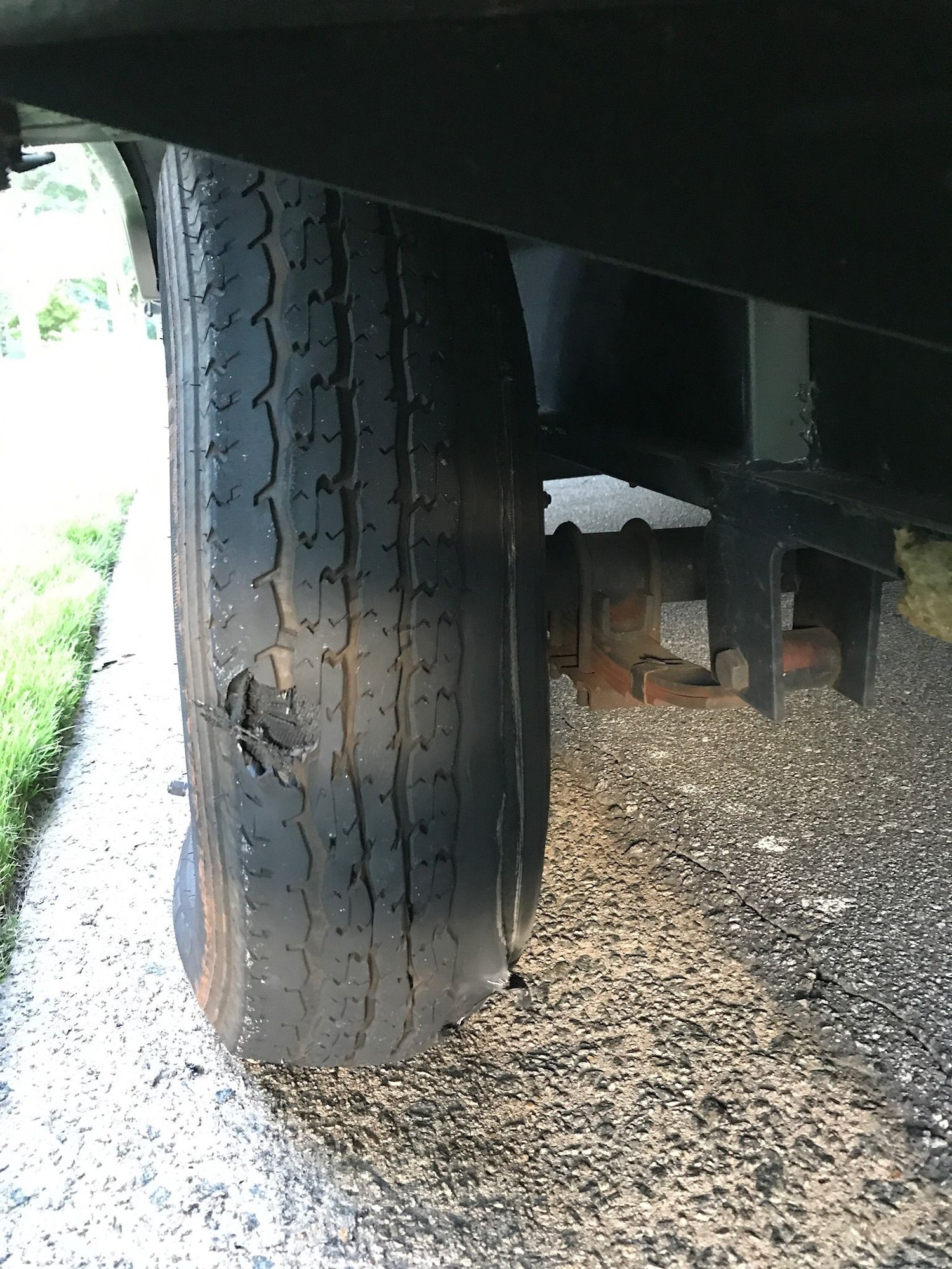

Walk around your rig at every stop. Our Tire Pressure Monitoring System showed no anomalies - never more than 5° over ambient.
I messaged with the resident towing Sherpa @WE3ZS because I remembered him having a similar situation, and he concurred that it was "belt separation" .
What my son saw
What I saw after removing the wheel.
What my son saw
It looks like a belt broke causing the tire to get physically distorted, which then led to very accelerated wear on the inside edge of the tread. As more internal damage took place the tread started to chunk off as the distortion became too great to stay attached. Look how round that tread face is, it should be flat across!
I have had a total of 5 ST tires that died in very similar ways, two actually looked worse. And none of them lost any air and the two that went after we installed the TPMS didn't get hot enough to trigger the alarm.
How old is that tire Mark? My most recent ones were 2 years and 40 weeks or so, they didn't even last to the super conservative 3 year replacement interval recommended by some.
My tires are always covered when we are home and the air pressure is checked before every trip and monitored under way with the TPMS.
What are your plans Mark? Are you contemplating some upgrades in either weight ratings, speed ratings or sizes? I went with a good amount of overkill on my TT with the hub/drum and wheel upgrade from 6 to 8 lugs and the crazy tough Load Range G Sailun S637 tires. So far with about 5k miles since March they have done very well.
This particular tire was dated "3513" I knew that when I bought the TT and my plans were to replace them before my annual pilgrimage to SoDak in the fall.
The TT is 2015 MY meaning it could have been built as early as March 2014.
I'm going up to load range D, while I like the idea of larger axles et al we are probably going to keep this rig 4-5 years and then either go to a 5er or a Class A.
Tires already ordered I'll have them, balanced with steel valve stems and do a walk around at each stop.

Is it possible you had the inside tire wear, which caused the separation? Is the inside of the tire worn on the other side of the axle? Just asking because this happened to me on a previous TT. The axle was underrated, and it bent, causing both tires to wear excessively on the inside. I didn't notice right away, because I had to stick my head under the trailer in order to see the wear.
What my son saw
No, not possible.
