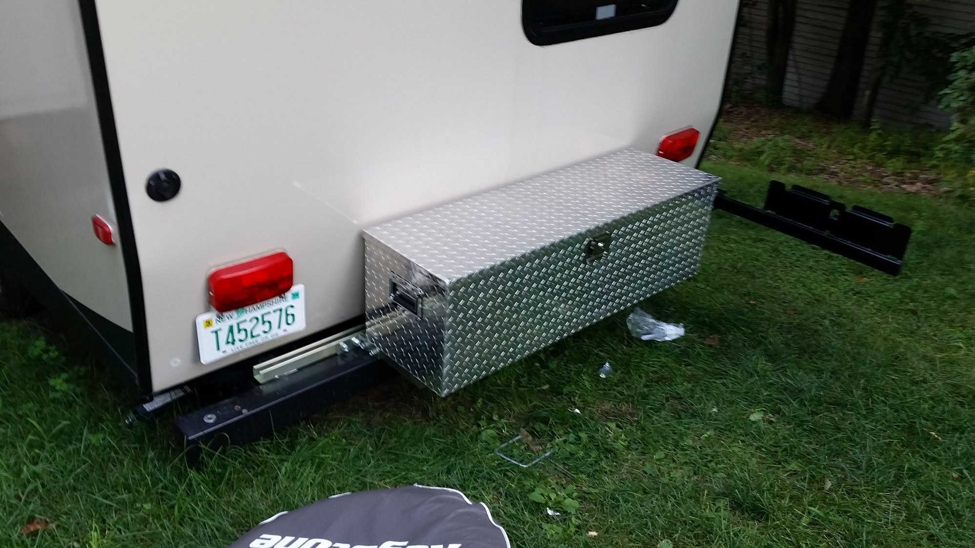

I switched from wood to the Camco legos because the wood absorbed water. I always cringed putting wet wood in my pass-through compartment. Of course, I also hated putting wet legos in ,y pass-through also.
I have recently removed my spare from the back of the TT and replaced it with a small aluminum box from Amazon. Only used for my two patio mats and legos, so no more wet stuff in the pass-through.
