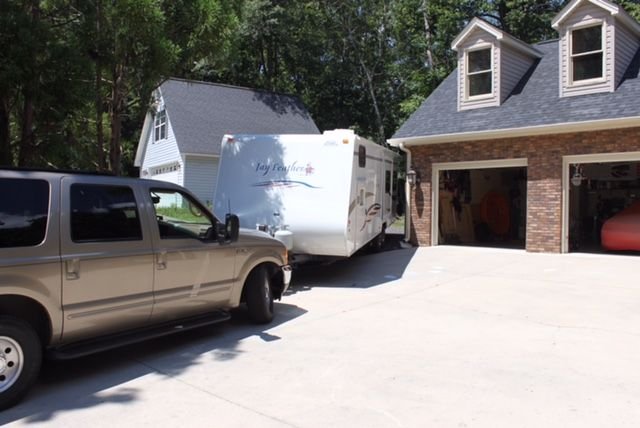

Front Hitch in action
So we have made 2 trips now with the Ex and new (to us) travel trailer. I adjusted the chains by one link to get a little more weight distribution, but I think I need to get to the scales to check tongue weight. Previous owner said that bars are only 800lb bars, but I am wondering if I need 1000lb bars. PO cautioned that you can do damage to the trailer frame if you use bars in excess of what is needed...can anyone confirm or deny that statement? So far towing experience has been good. I also tightened my sway control this last trip and I felt much less sway on the highway.
Here is my setup routine to get the TT out of its parking spot and to the road. The front hitch definitely makes this much easier, I just still have to have my wife as the spotter or I am likely to take out the garage/trailer on the passenger side of the truck .

I tow a lighter trailer than that Jayco, and have heavier bars. Type of hitch will be more important as the weight increases. Edit: and that is my twin I think except the front hitch

A good rule of thumb I like to use when specing out a WD hitch is to use the TT's GVWR (NOT the "dry" weight) then get spring bars that are rated for 15% of the GVWR. Since you will want to target 12/13% tongue weight it gives a little extra capacity for those longer heavier packed trips.
It could be possible to do damage with way too heavy of spring bars loaded way up on a light duty trailer frame but we are talking big differences in ratings. Not a common thing.
I think that you will need heavier bars than 800lbs with that size TT. The bars should have either a sticker or a stamping that shows their weight rating.
