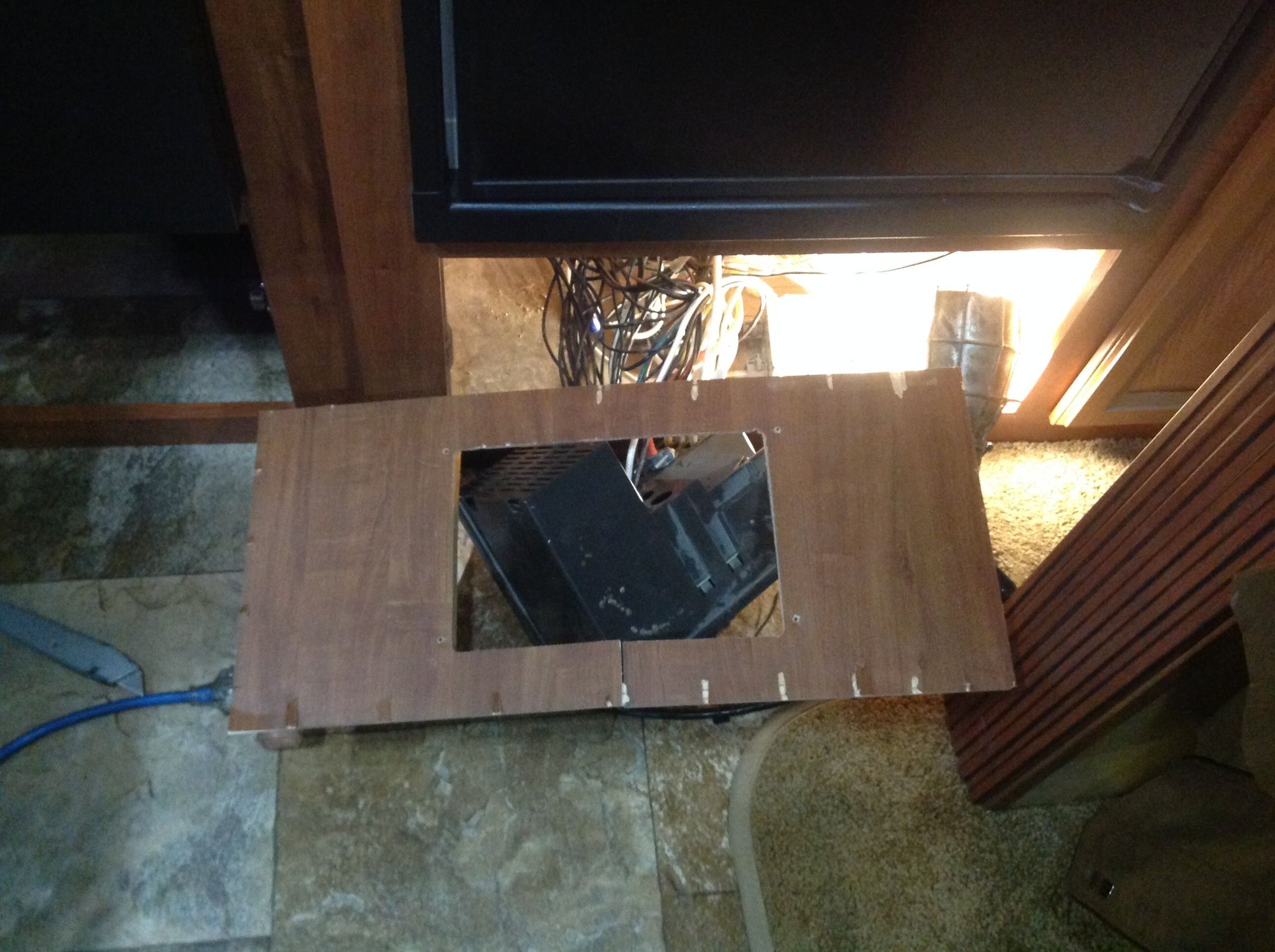

Finished my electrical upgrade, ready to go camp.
Electrical panel was securely fastened to this sturdy piece of 1/8" luan. The surge protector and deck mounted charger are going back in amongst the spaghetti.

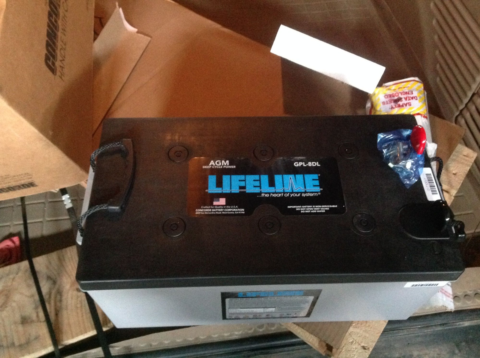

The thing that kickstarted this whole job was I had to get some weight off the tongue. The obvious choice was the 115 lbs of batteries. First thought was just stick em on the back bumper, but it just didn't look right. That's where the AGM battery came in. I wanted at least as much capacity as the 6 volt batts were giving me. Sizing up my available space and the cost of the batteries, went with the big dog. Couldn't bring myself to buy the Chinese knockoff for $200 less.

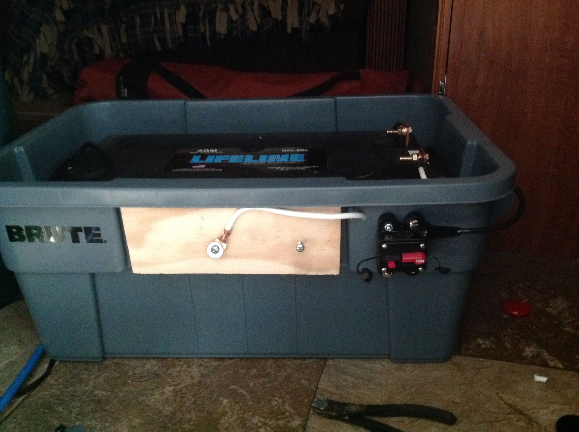

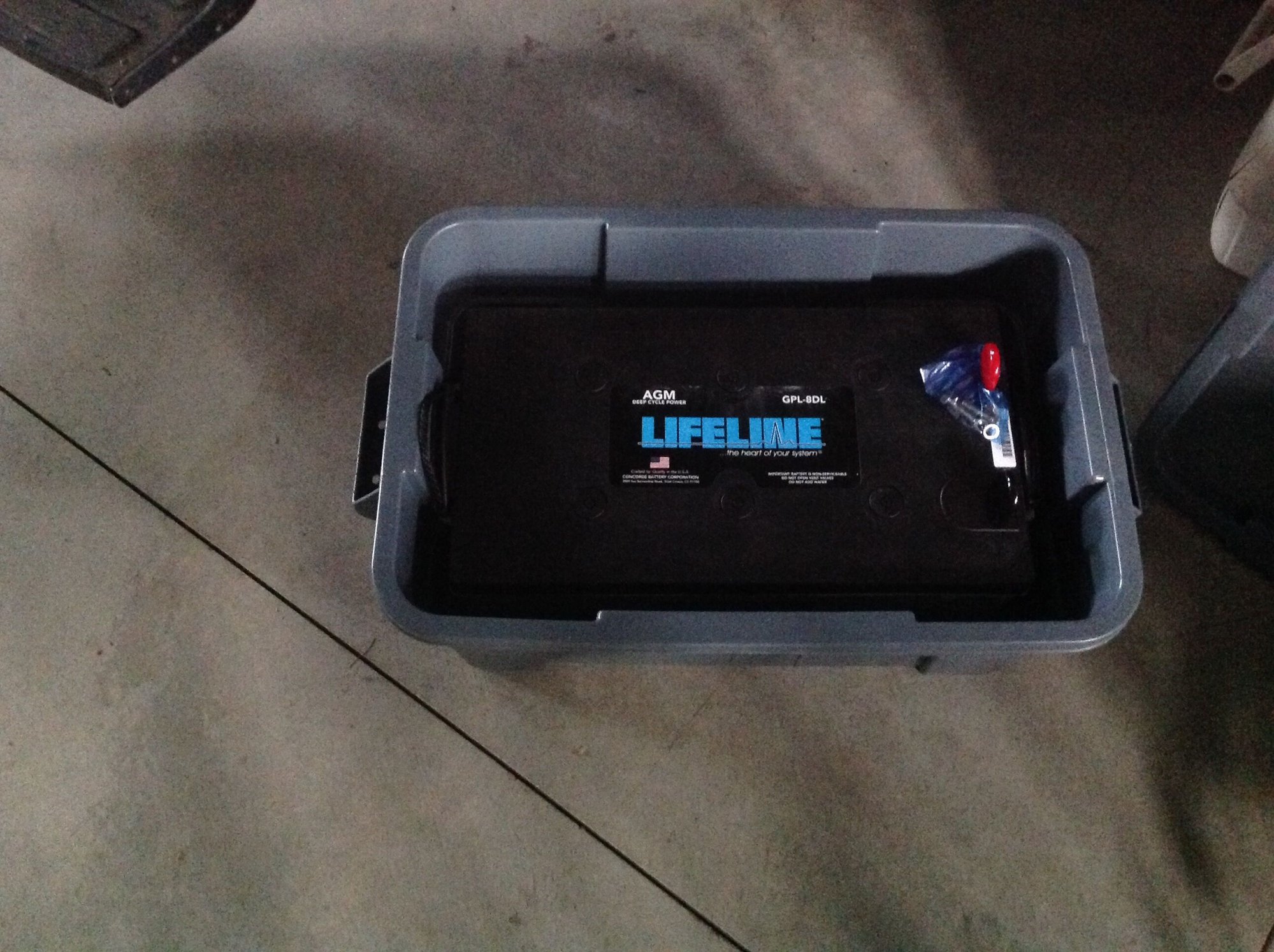

Found a bin that fit the battery and barely fits in the compartment.
It goes under the stove on the back wall. Was able to vent the bin through the outside shower, no new holes in the wall.
Added a 100 amp circuit breaker, also serves as a disconnect. The other box is for the shunt that is part of the trimetric battery monitor system, all the grounds go through the shunt. The feed that was coming from the front got a 30 amp breaker and is still hot for the jack and charging circuit from the truck. 6 gauge wires into the existing panel.

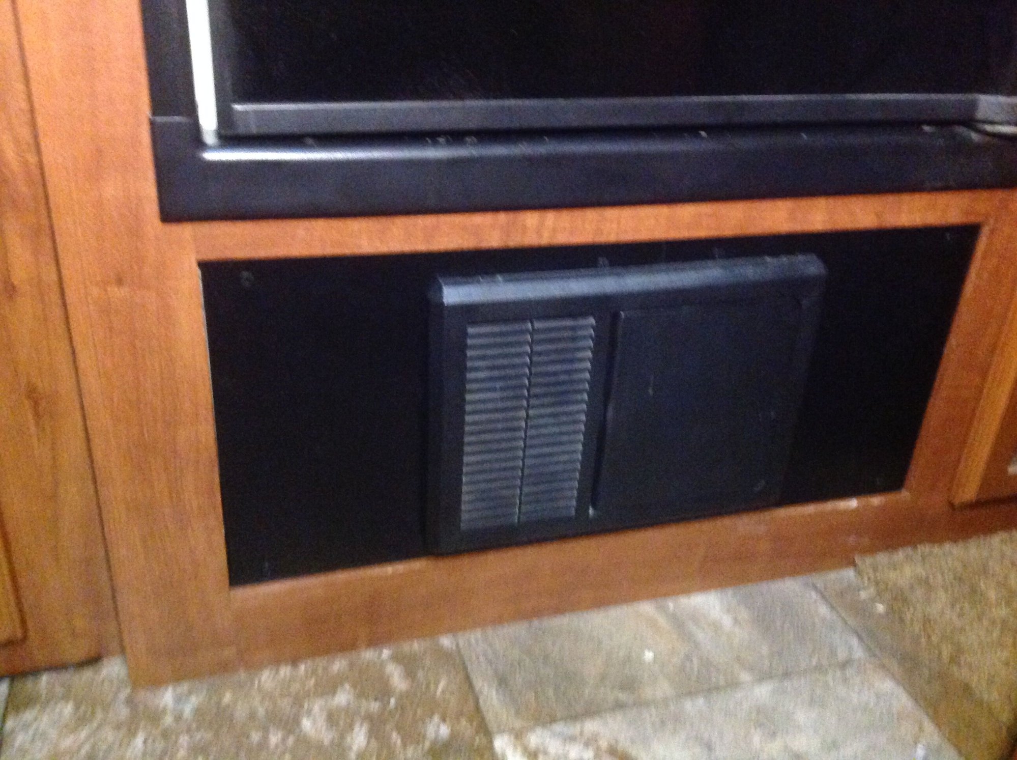

The luan was replaced with 1/2 plywood with lots and lots of paint on it, finished product looks good and works great.
Hoping this gets me back under 1400 lbs on the toungue. The math says it will.
