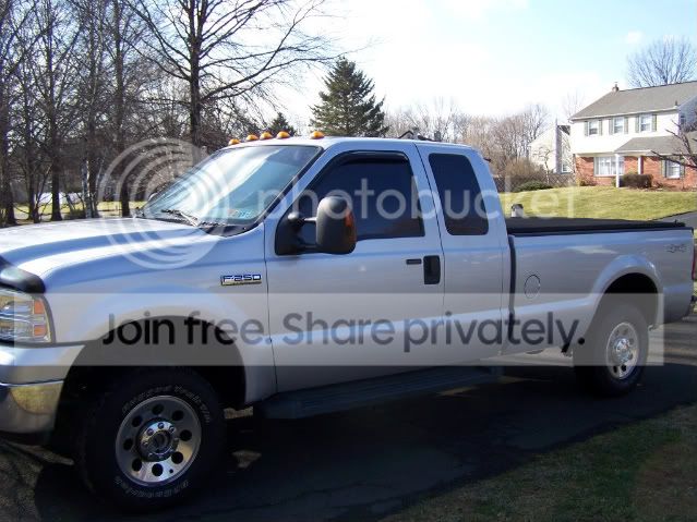

This is what I traded for the EX . Mint condition inside and out
