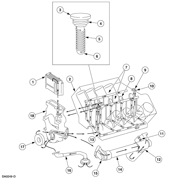

The IPR opens a drain to the c case ,relieving pressure in the heads . The res remains full ..Name:  7_3L%20LP%20lube%20oil%20system.jpg
Name:  High Pressure oil system.gif

thanks rick, that helped me out.
