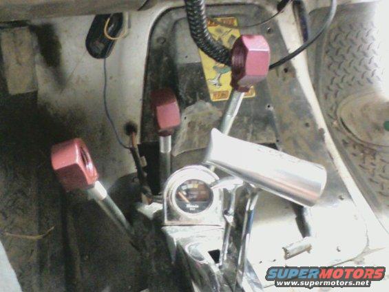

I cant find the pics of the linkage and the mounting, this is all I could find... I'll take some tonight and post them up for you to see....

riiight triple stick LOL...fuuuuun
