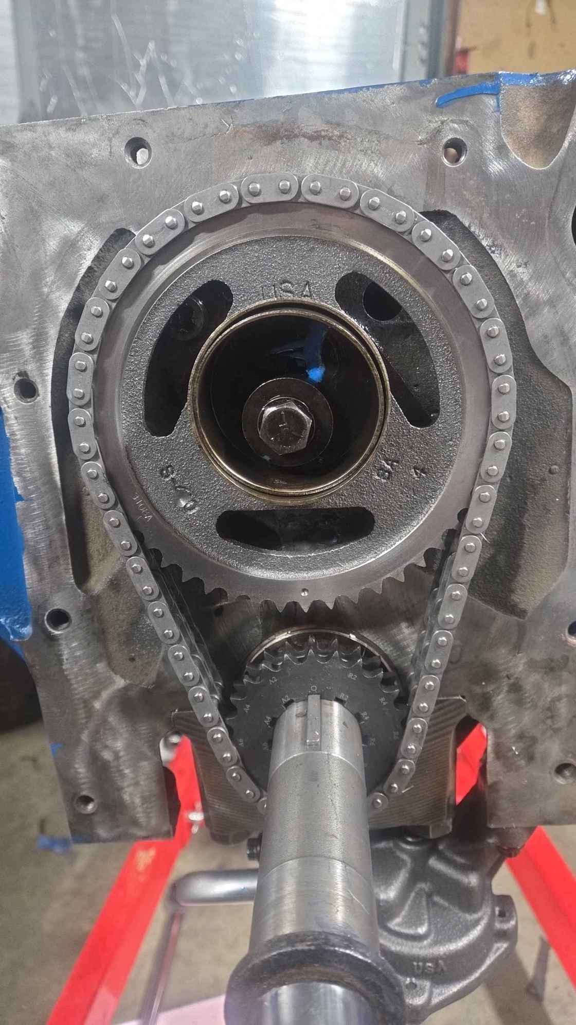

Here we are. It slid onto the pin after I cleaned it up. I had a durr moment, the cam thrust plate was on backwards so when I was spinning it it would have a hard stop at one point. Flipped it around had no issues. All bolts had locktite.

Is this how the fuel pump eccentric looked before you took it apart? I doesn't look right to me.
I have a different engine, but it uses a two piece eccentric and it didn't look like that.

that is not correct, you're right.
Might be the cam dowl holding it up or the tab out of the slot, whatever it is that's not going to work.

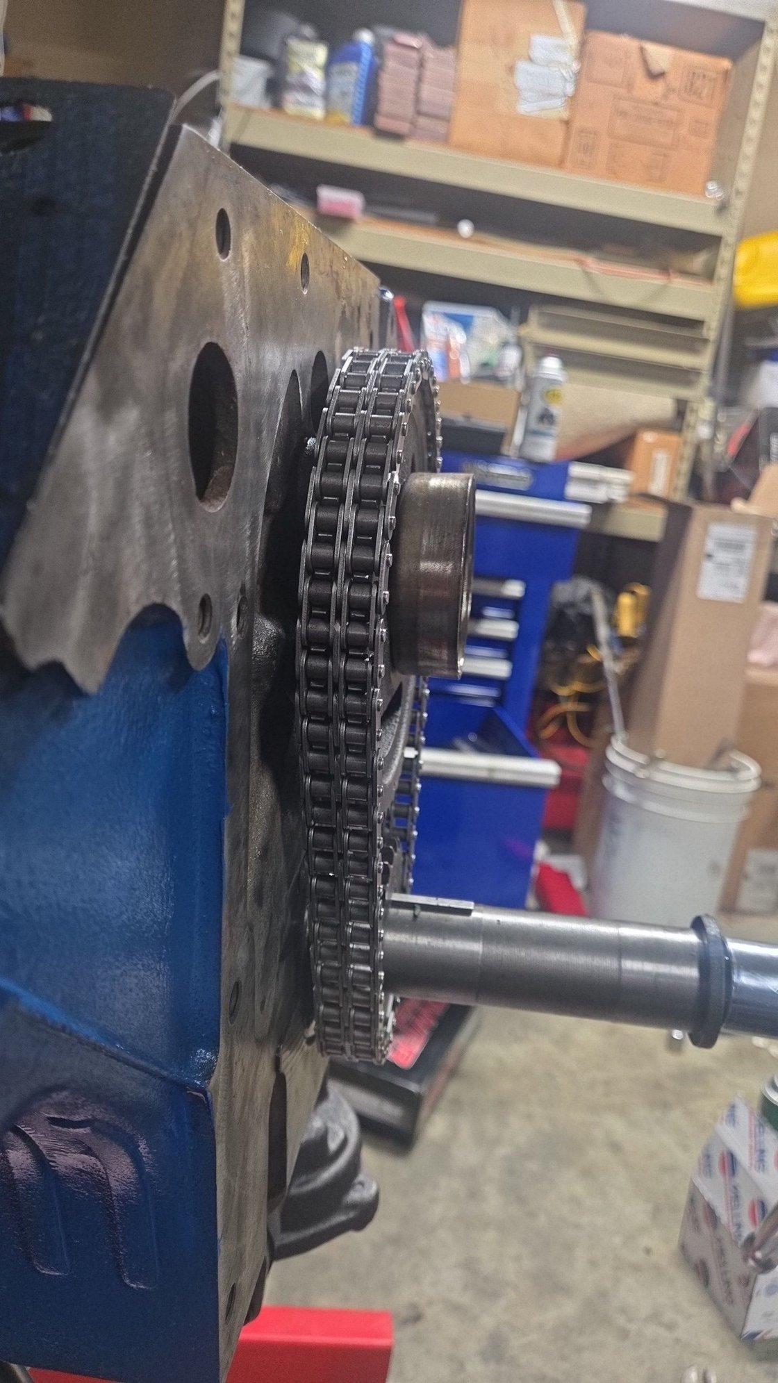

Lol. I didn't even notice that.. I'll look at it tomorrow. Here's how it looked when I took it apart

Oh. I have it flipped the wrong way.

I've got it fixed. Can't believe i overlooked that

That's better.
Things like that happen, but good it was caught now. Keep posting pictures, it never hurts to have multiple eyes on to catch little things like that.
Regardless, this is how you learn and hopefully avoid the same mistake in the future. Instead, you get to make new and more interesting mistakes.
Every single poster here has made little mistakes like that too, and if they say they never have, they're lying.
