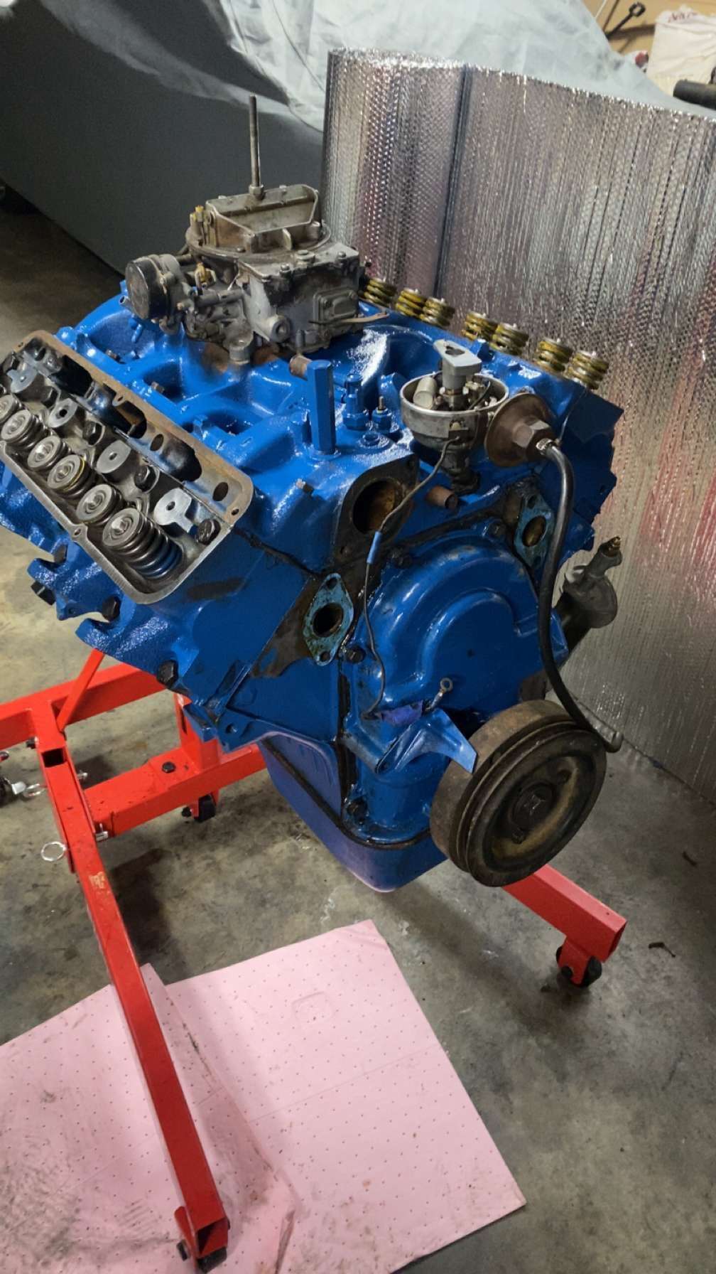

Really close to being able to put it in the truck.. I ended up using the lifters that came with the melling kit. Got the intake aligned and up there myself.
