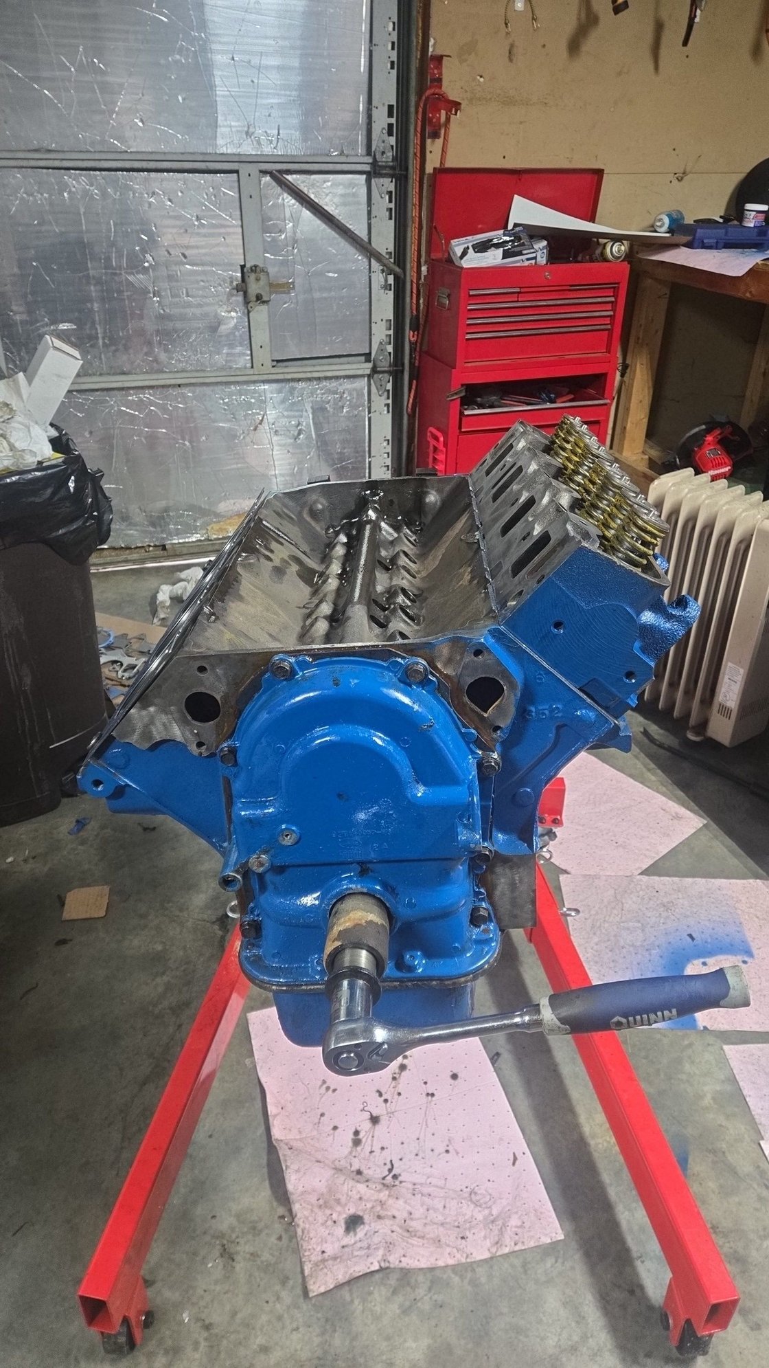

Old Jan 12, 2025 | 08:51 PM
  #221
xcox's Avatar
xcox
Joined: Sep 2024
Posts: 178
Likes: 32
Waiting on other head but other than that everything is torqued down. It's got air coming out of the plug holes so I must have done something right 😂😂
