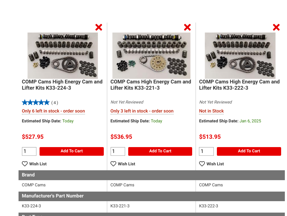

Here's another option to consider, it comes with timing chain, springs, retainers, keepers, cam and lifters. People can say what they will about Comp Cams, but they spend a lot of money on R&D and have studied what works together. Their K-Kits take a lot of guess work out of it and if we are being honest, are more convenient and usually less expensive than buying all components separately.
