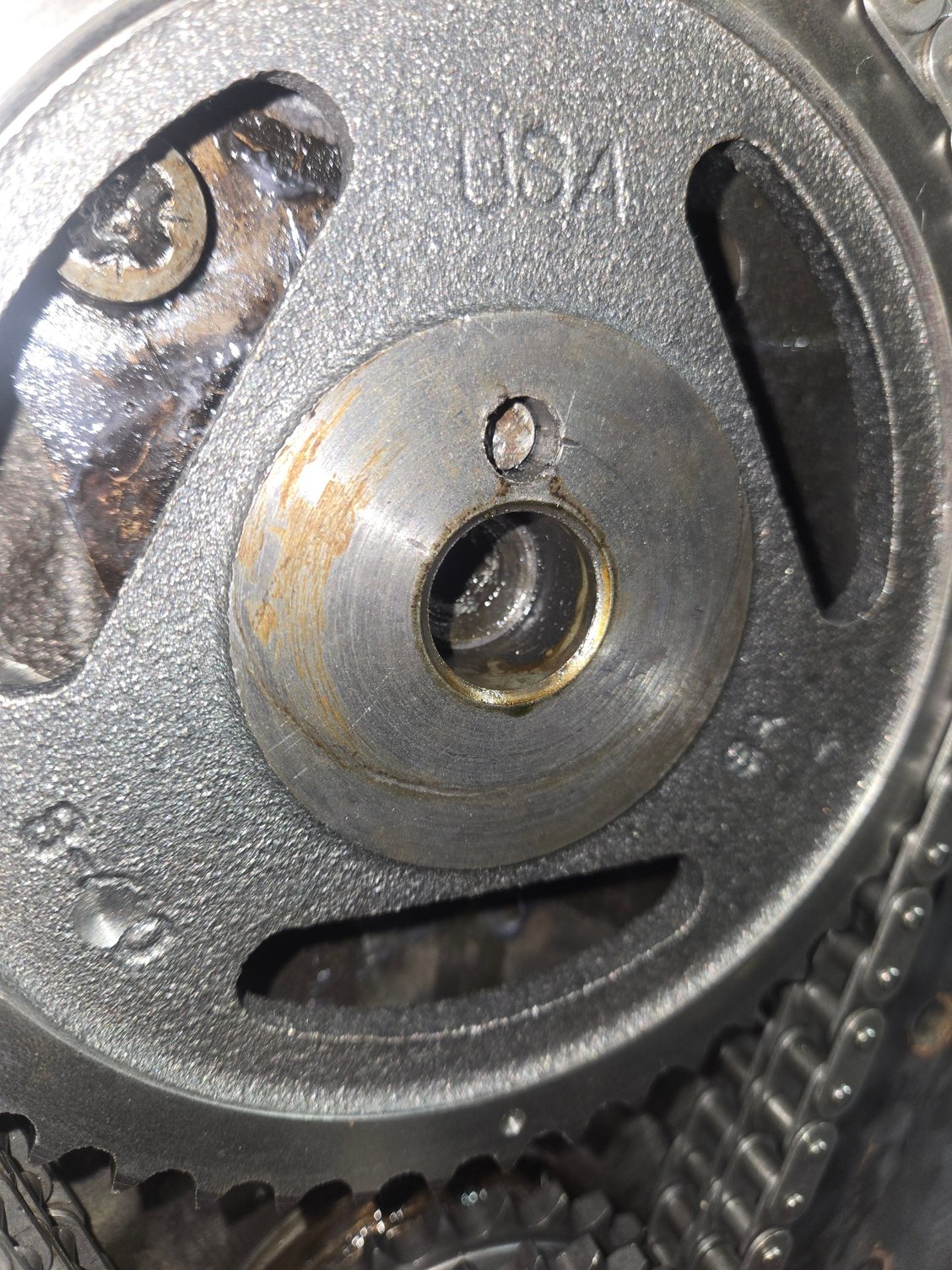

Question for you guys, I was going to put cover on and noticed this. Is the dowel pin supposed to be that far in?
Old Jan 9, 2025 | 11:11 PM
  #206
xcox's Avatar
xcox
Joined: Sep 2024
Posts: 178
Likes: 32
Will this be a problem? I'm under the assumption as long as the cam bolt doesn't come loose, it's not.

As long as gear is fully seated on cam that looks fine

So the tang on certain fuel pump eccentrics has a place to index.

yes. My eccentric is like that. I figure as long as the cam bolt doesn't come loose ill be fine
