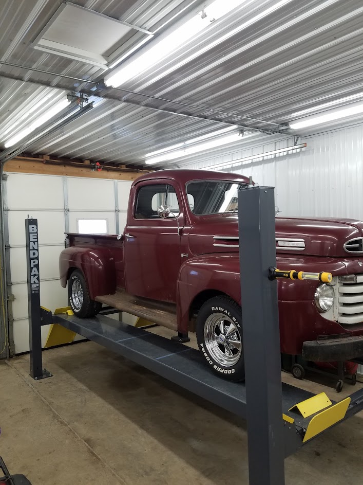

It's hard to beat continuous row lighting. Less shadows and easier on your eyes compared to bright smaller light sources. Many ways to go with LED. These are T8 with ballasts, but can be changed to LED. Also can rewire and use 4' 120 volt lamps that don't use a ballast. Pay attention to lamp color before buying. Notice rows are above walkways not above vehicle. I also switched lights above raised doors seperate, don't always need them on, specially when door is up. Good Luck

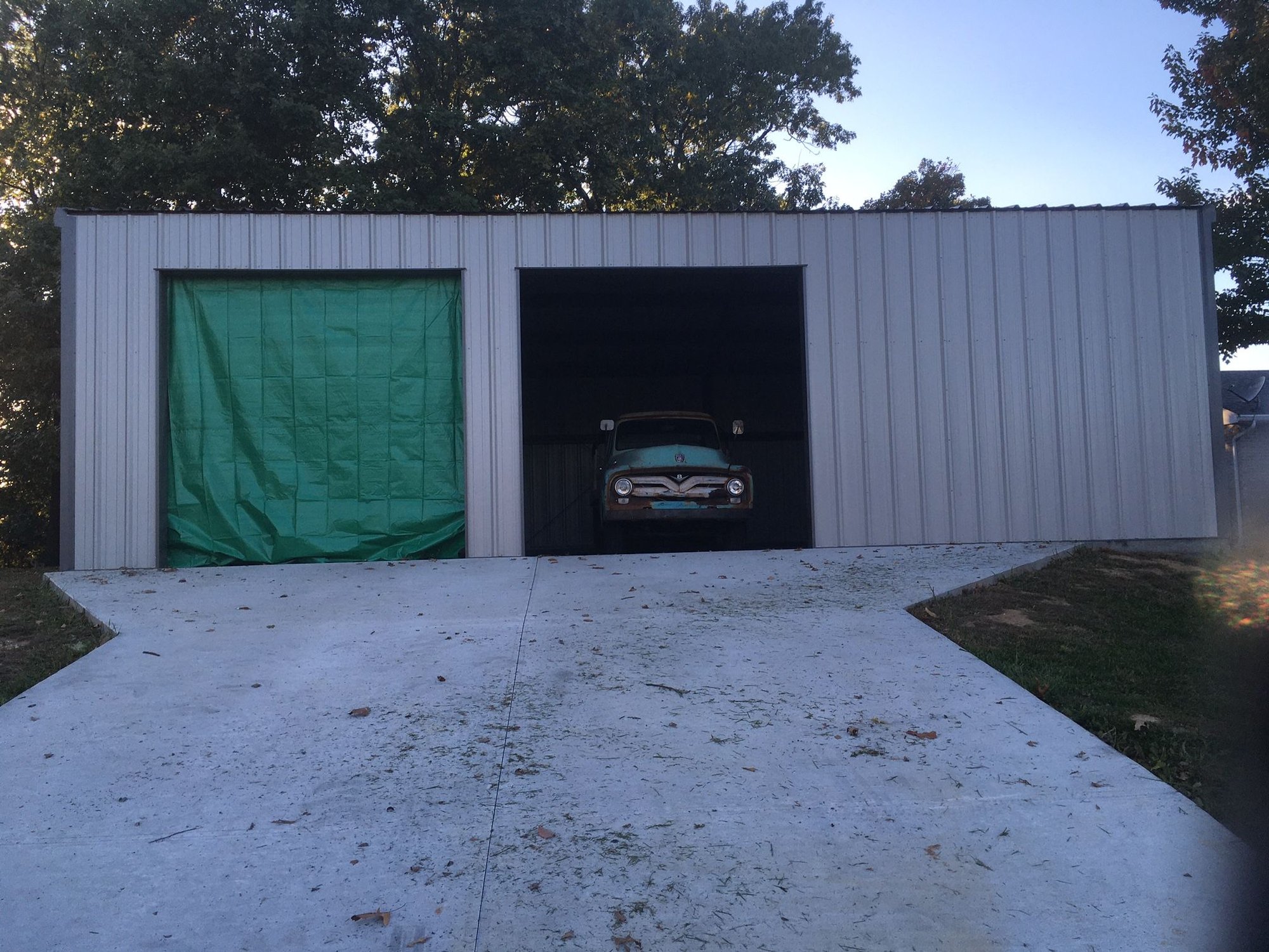

Shop is now "done". My crew is finished with their work. I put tarps over the garage doors to block weather and hide contents a bit.
Gutter guy will come by Friday or Saturday to give an estimate. Insulation will be mid to late November and I'm guessing garage doors will be in the first part of December.

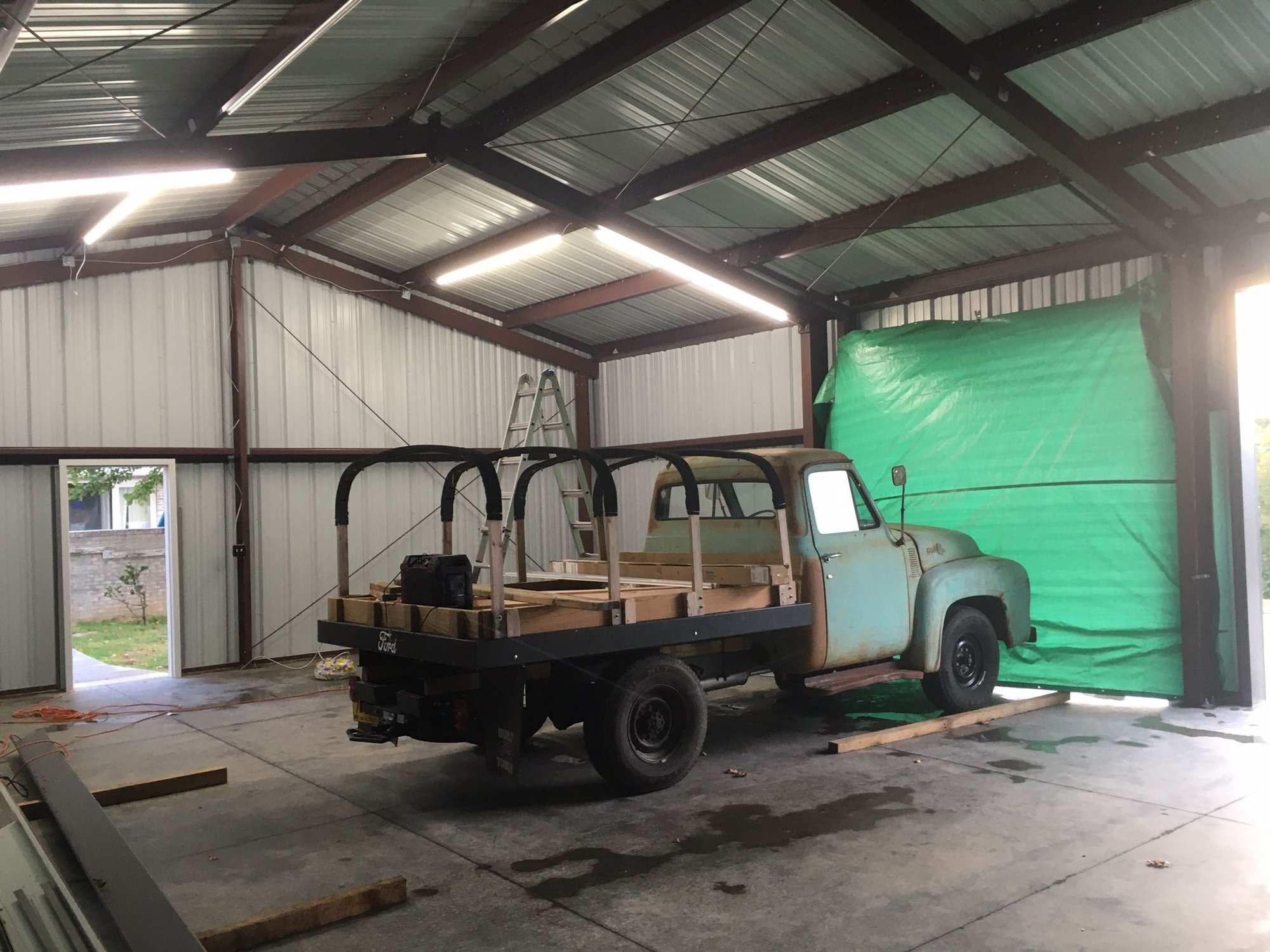

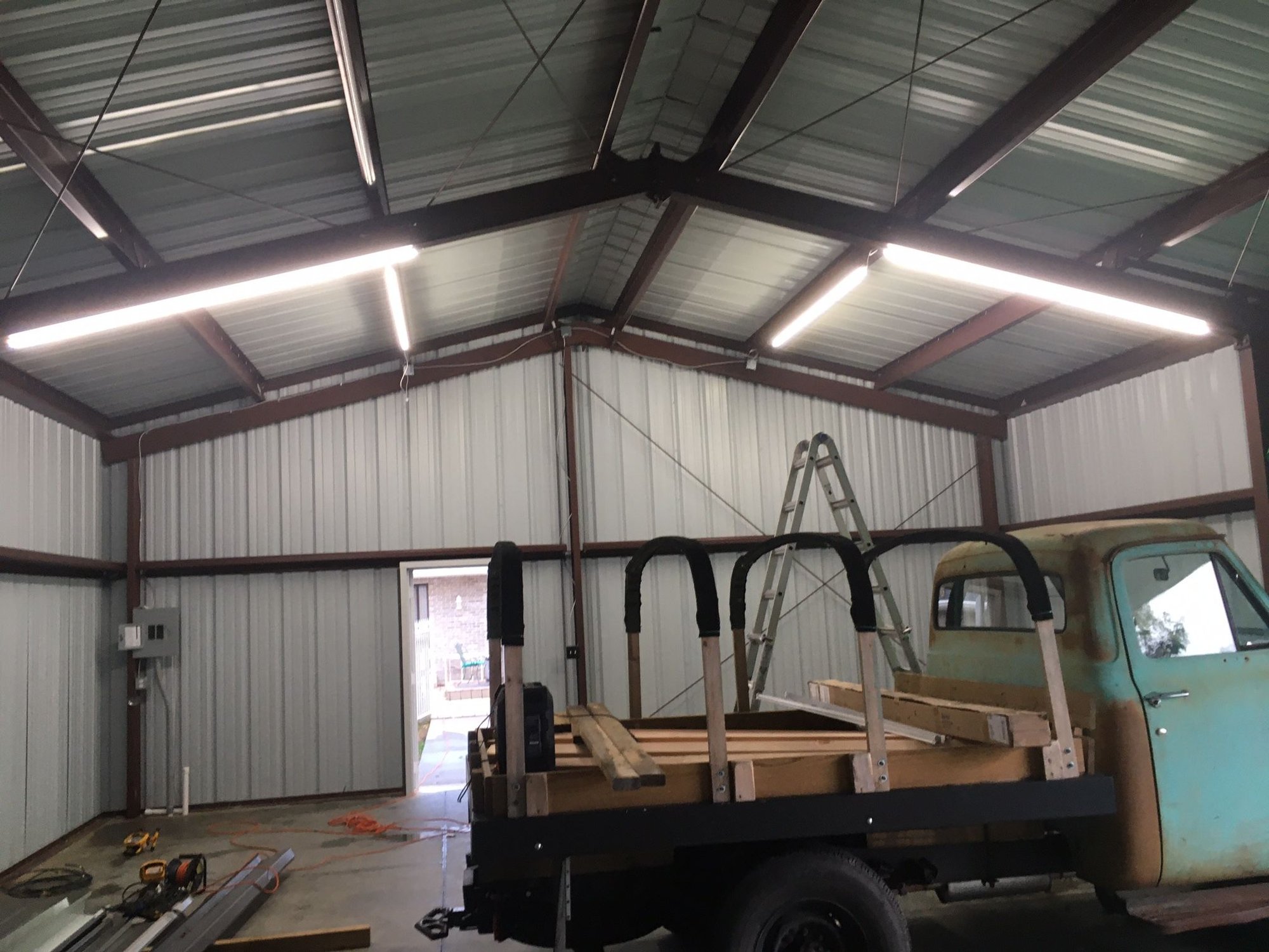

I now have some lights. I got 4 of the 10 lights wired up. I have ordered a couple of longer cables to link the lights. That will get them all power.
With just the 4 working there is a lot of light. It will be really bright with 10.
Now, the screw up. I wired the switch between the outlets. So of course the switch only works on one bank of lights. So, I will need to figure that out and run the wires properly. So for now my breaker is the switch.
I finished up and moved my van in the shop to protect it from the storm. We just had a little hail, but it wasn't too bad. Hopefully the bad weather has passed.
