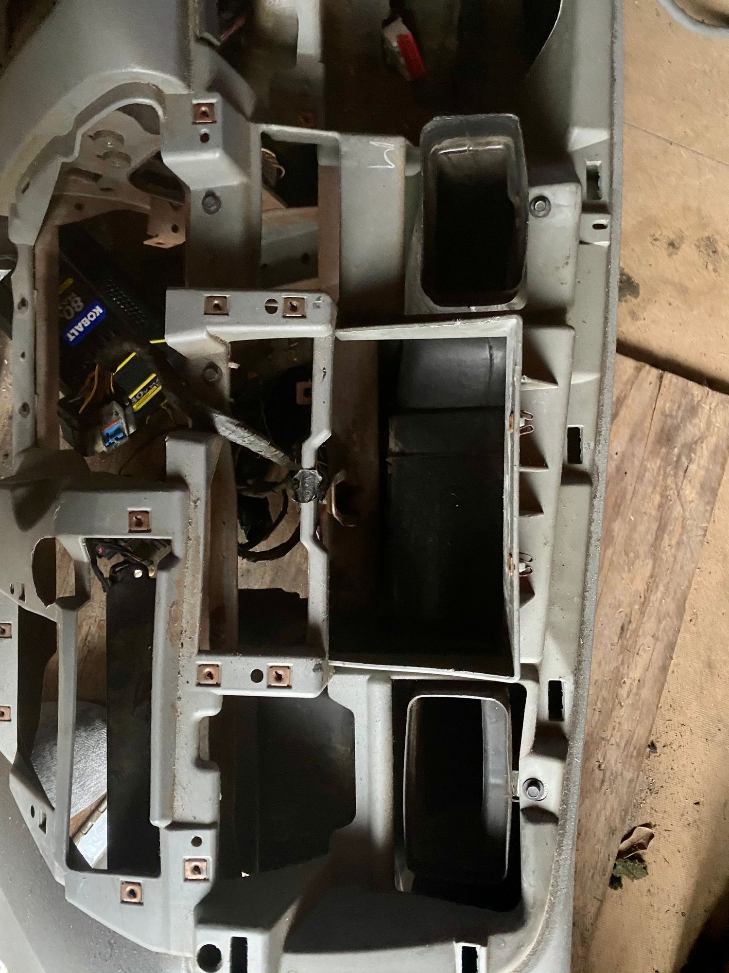

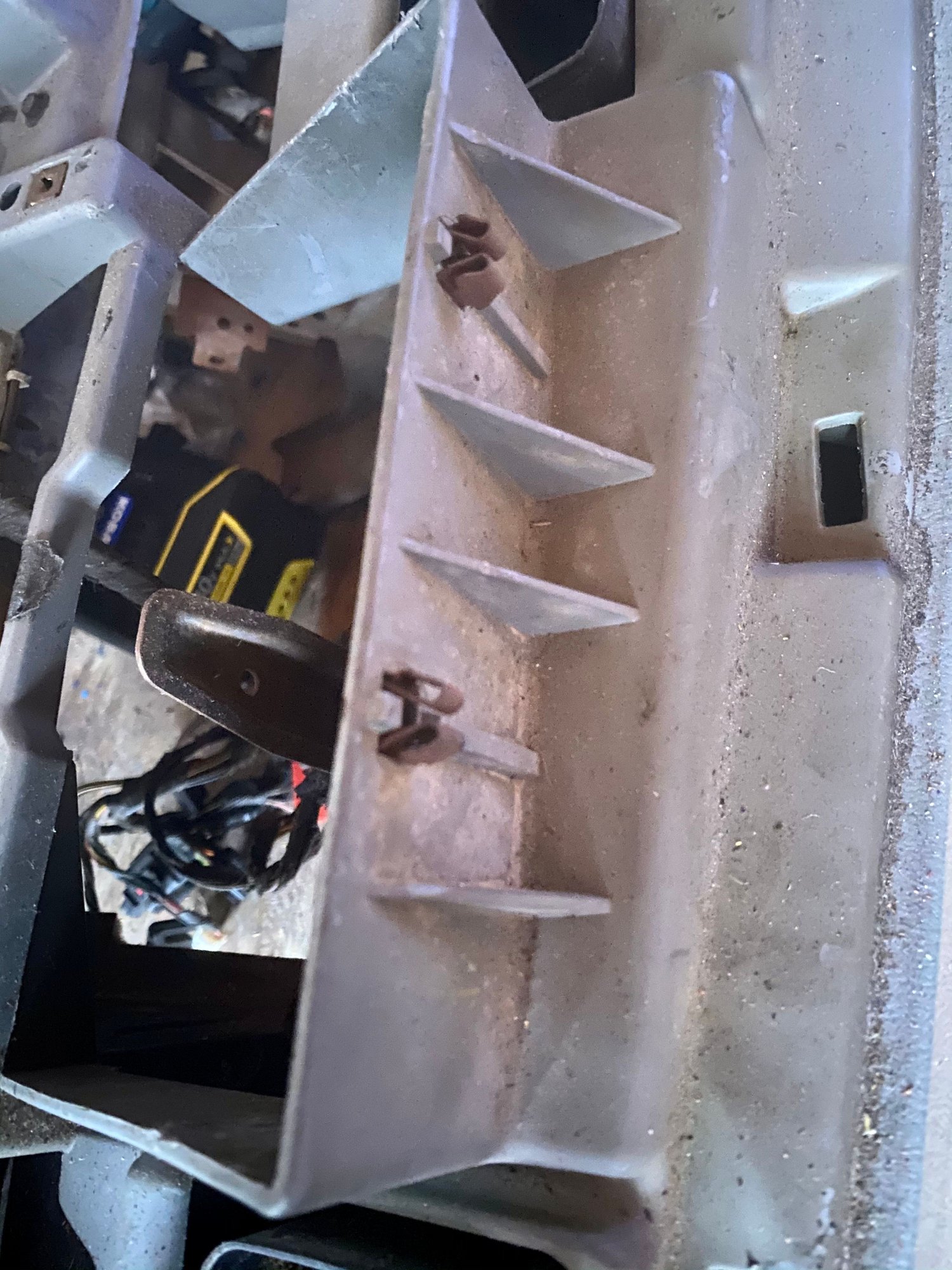

Here are the dah photos so people can see ahead of time what it looks like
Radio appears to rest on the metal plate in the middle

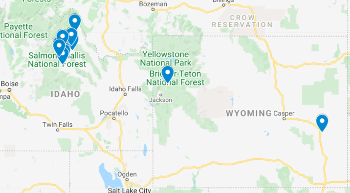

I have since learned that at the "My Maps Google site" I can create custom routes, note points of interest, etc... Below is a small snip for our out west stomping ground.
I can now easily get on Google Maps from the ATOTO, select My Maps and go to a set location that we have already scouted and planned out. I can also load up a custom route say if we want to go through LoLo MT or Ouray CO on the Million Dollar Highway (beautiful drive) instead of Jackson WY. We are spoiled by Google Maps so much that we are planning to purchase a Scosche fast charging cradle for the 2016 Ford Escape we inherited last year. Even though it has Ford Sync 3, we prefer the live Google Maps. The Escape has Android Auto, but I don't prefer that interface.

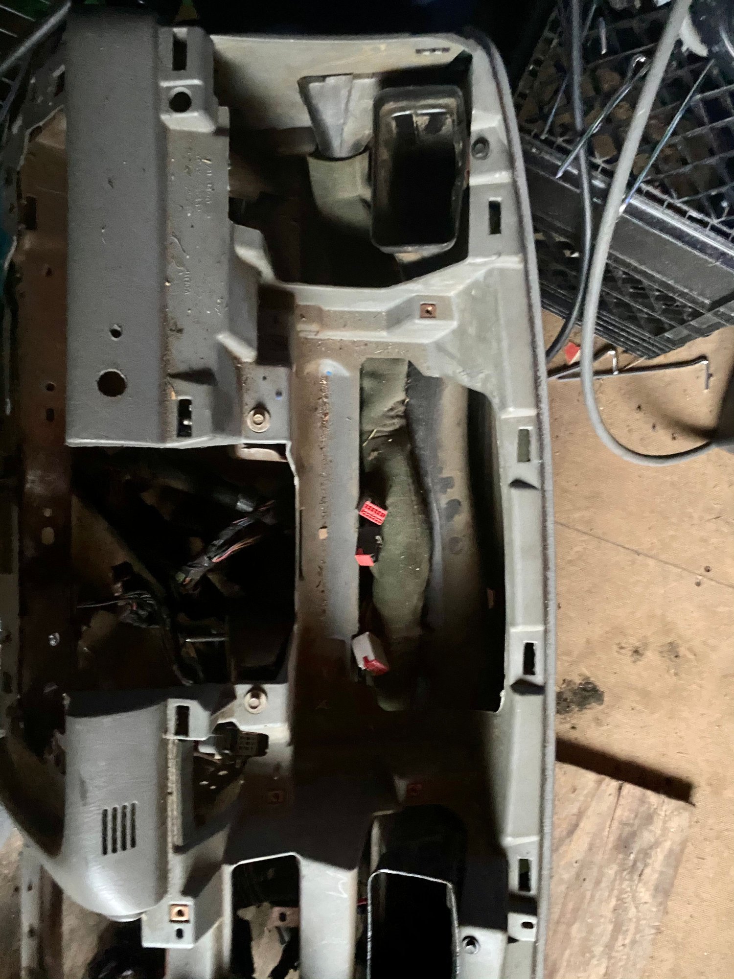

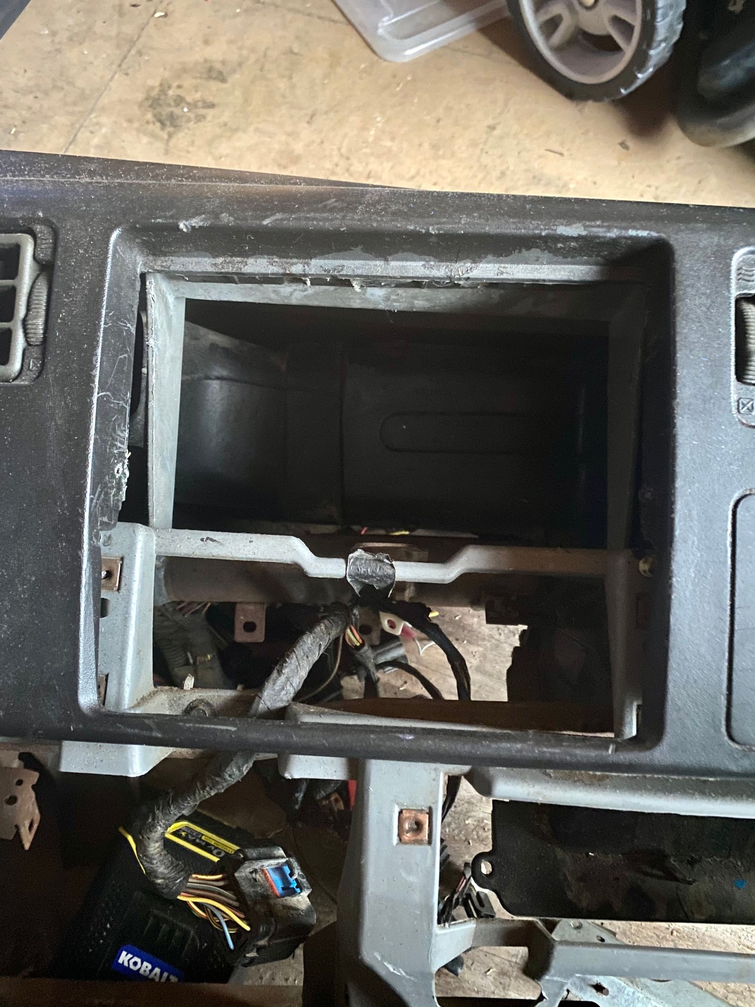

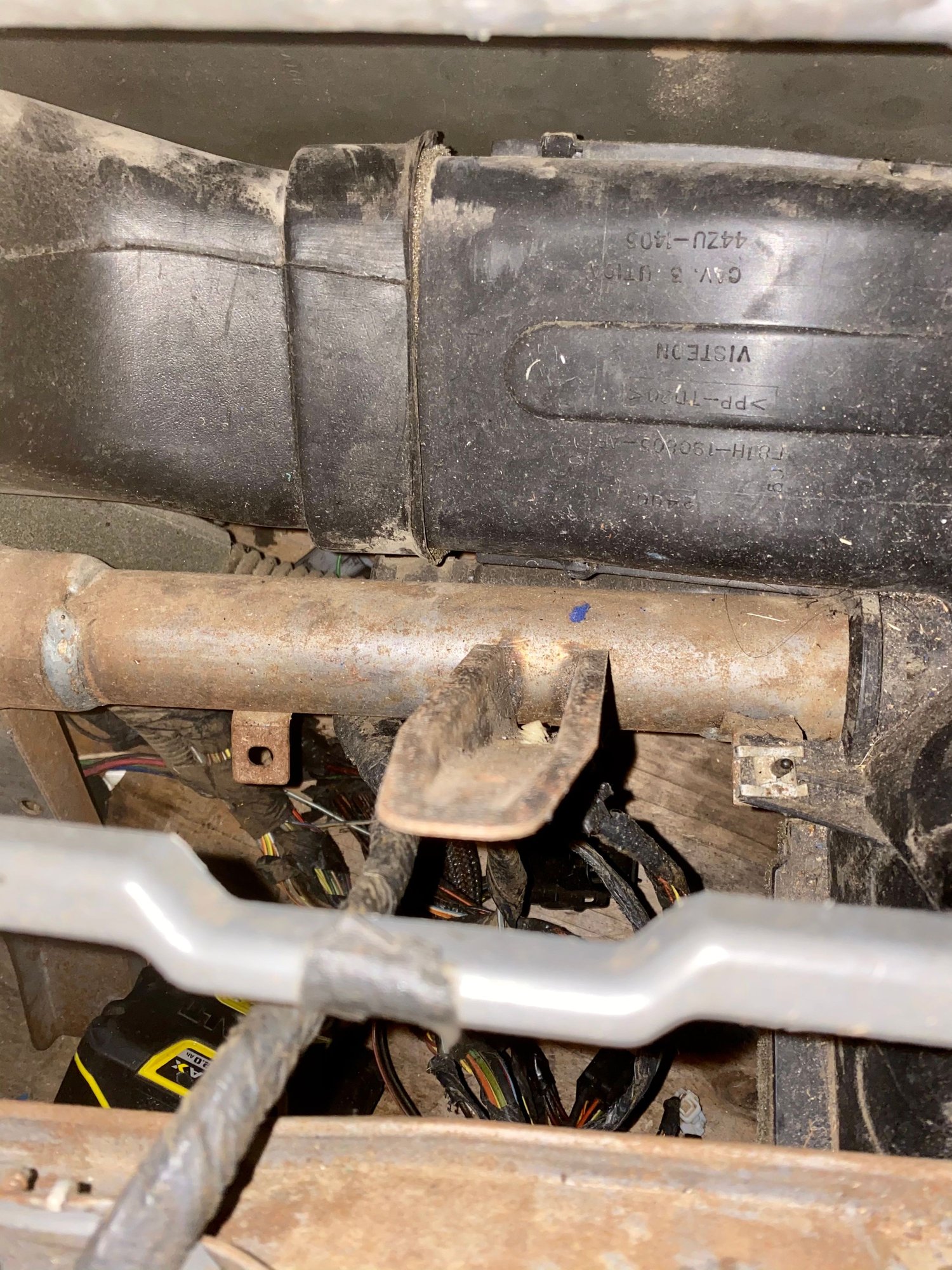

I'm not that into head units (I even removed the stock radio in my truck, it is just an empty hole, so move along thieves, nothing of value in here, and yes, you already found out that the truck won't start after you broke in the last time) but if I were, then I would likely consider relocating the HVAC controls to either the cubby hole position, the indash cup holder position, or in an F-650 manual transmission lower dash position.
With the HVAC control unit thus dispatched, I'd have a contiguous triple DIN space to work with (perhaps 3.4 DIN), into which I would position a 10" or larger diagonal screen oriented vertically, with the end result appearing as if the instrument panel cover was originally designed that way, due to bar between the factory head unit and the oem HVAC control pocket being recessed from the final textured surface of the IP panel, making it a snap to cut away that dividing bar for a combined cavern to accommodate a larger vertically oriented screen.
The more significant cutting would be all the plastic structure behind the IP cover. But since those cuts would be entirely hidden, there would be no fiberglass work involved with trying to make the appearance seem more finished.

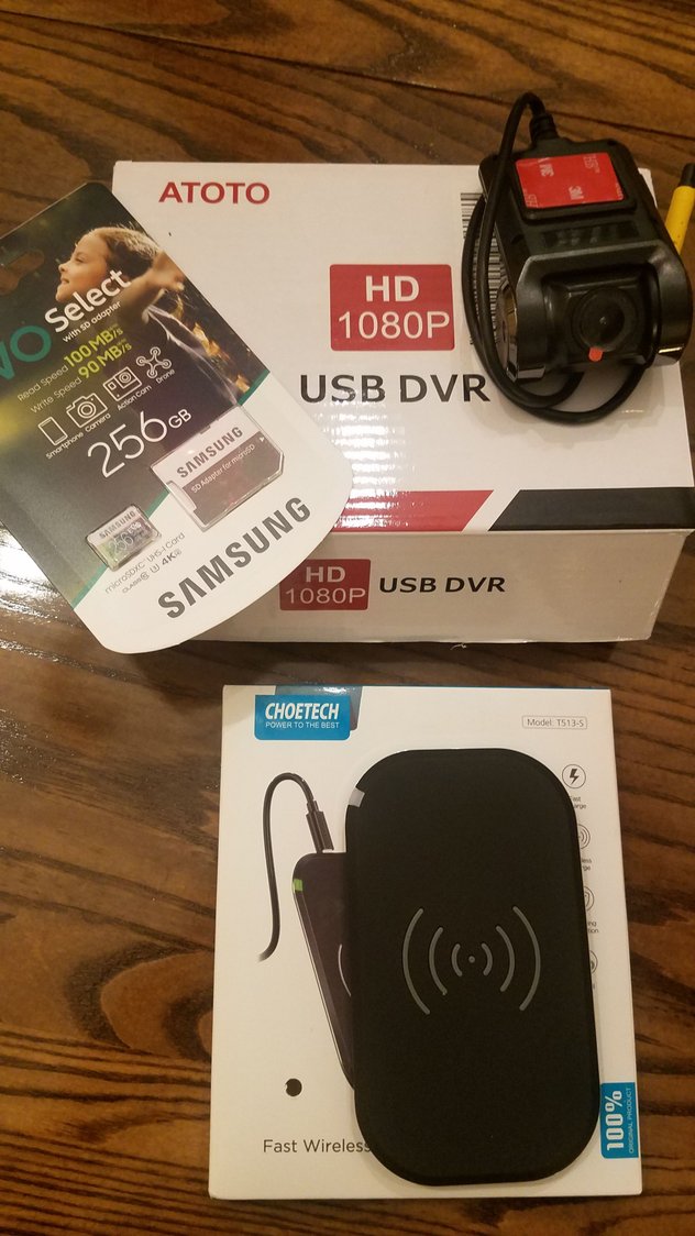

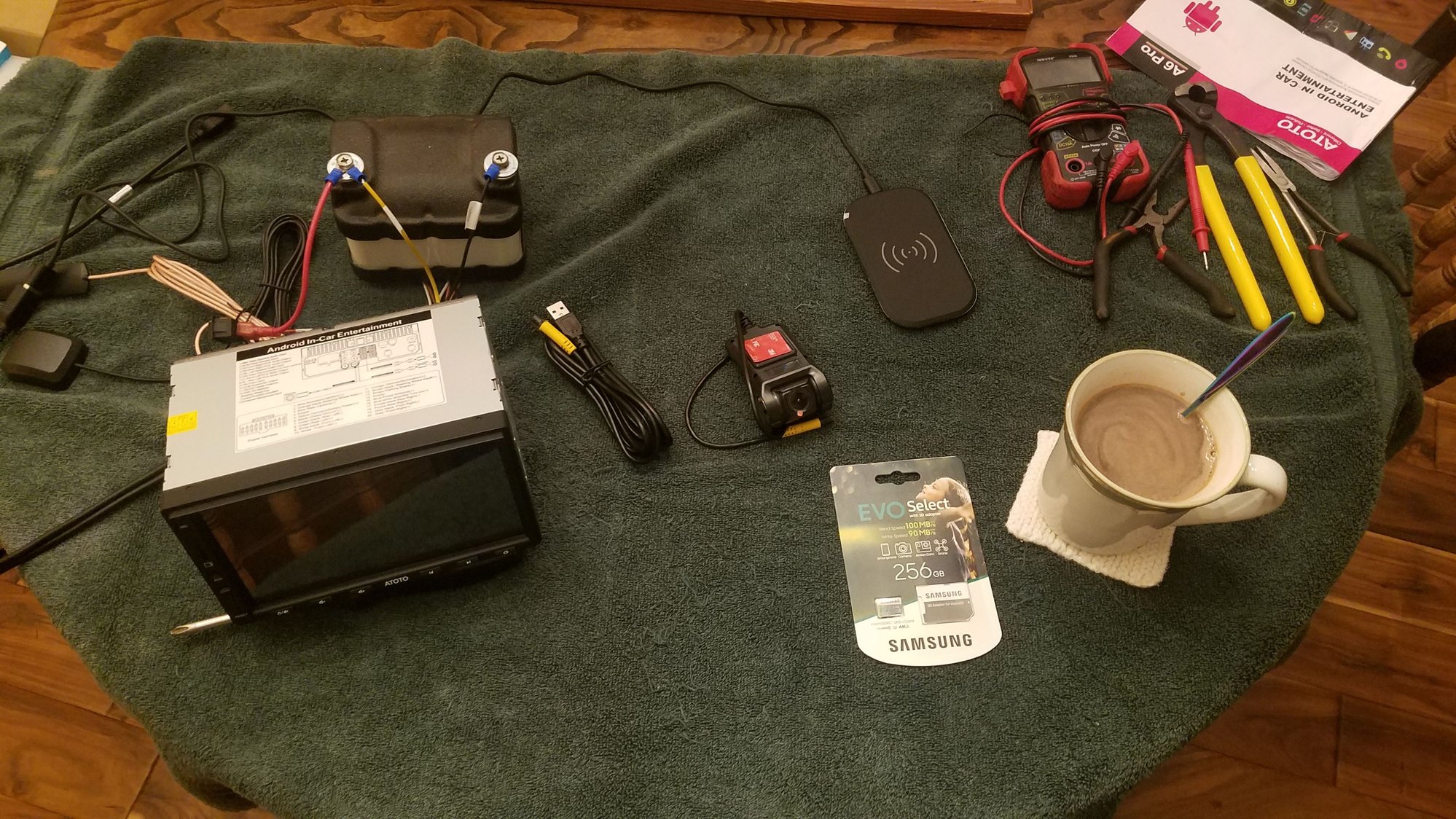

More gadgets came in the mail today. I was originally going to put these on my wish list to Santa, but decided not to wait that long. Also, as seen in the spreadsheet above, I got great deals on the prices! So much so, that some of this stuff ends up being free.
GFML!
USPS dropped off the following items.
  • 256GB microSD card
  • ATOTO dashcam
  • Choetech wireless charger
Turns out the wireless charger does not quick charge from the head unit like I had hoped, but it charges at normal rate so I am OK with that. This is hooked up to the USB line in the back labeled "quick charge". The "Quick Charge" app seen below should be used to select "standard charge".
I setup my test bench on the table again in order to test the dashcam and wireless charger. This way I would know what to tweak/adjust before having everything in the dashboard of the truck.
Test bench complete with hot chocolate!
I need to format the microSD card and fire up the dashcam.
More updates to follow.
