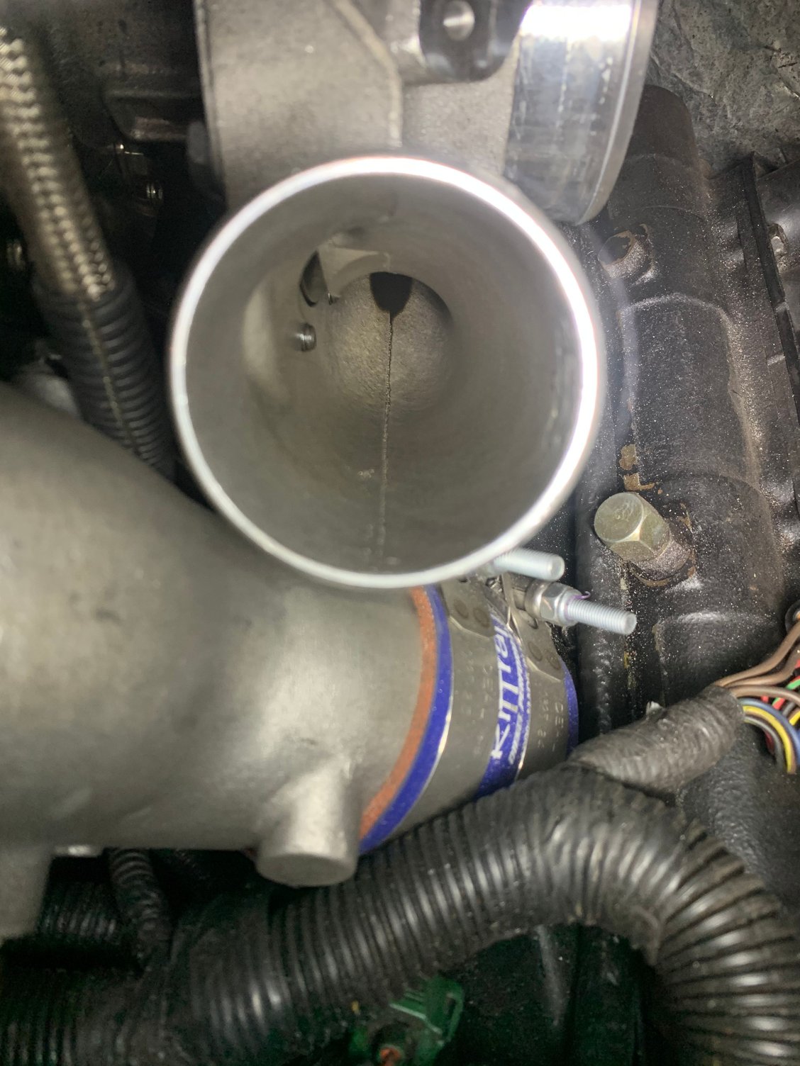

Don't discount moral support. It helps more than you know. I have one possible cause for the shaft breakage and that is that I have noticed what sounds like surge if I'm boosting and I get off the go pedal abruptly, like when a lady in a BMW SUV (Dan, this is the BMW I was telling you about) cuts into my lane in front of me without looking. If that is the case, a blow off valve may be in order. Either that or get a turbo that doesn't have to spin so hard to make the boost.
And now for your viewing pleasure, pictures of carnage.
Valley is dry. Pedestal quad rings are holding up.
No aluminum shavings in the compressor outlet which is good.
First view of turbine outlet after DP removal.
In case you're wondering, yes there is supposed to be a turbine there.
Oh, that's where the turbine is.
