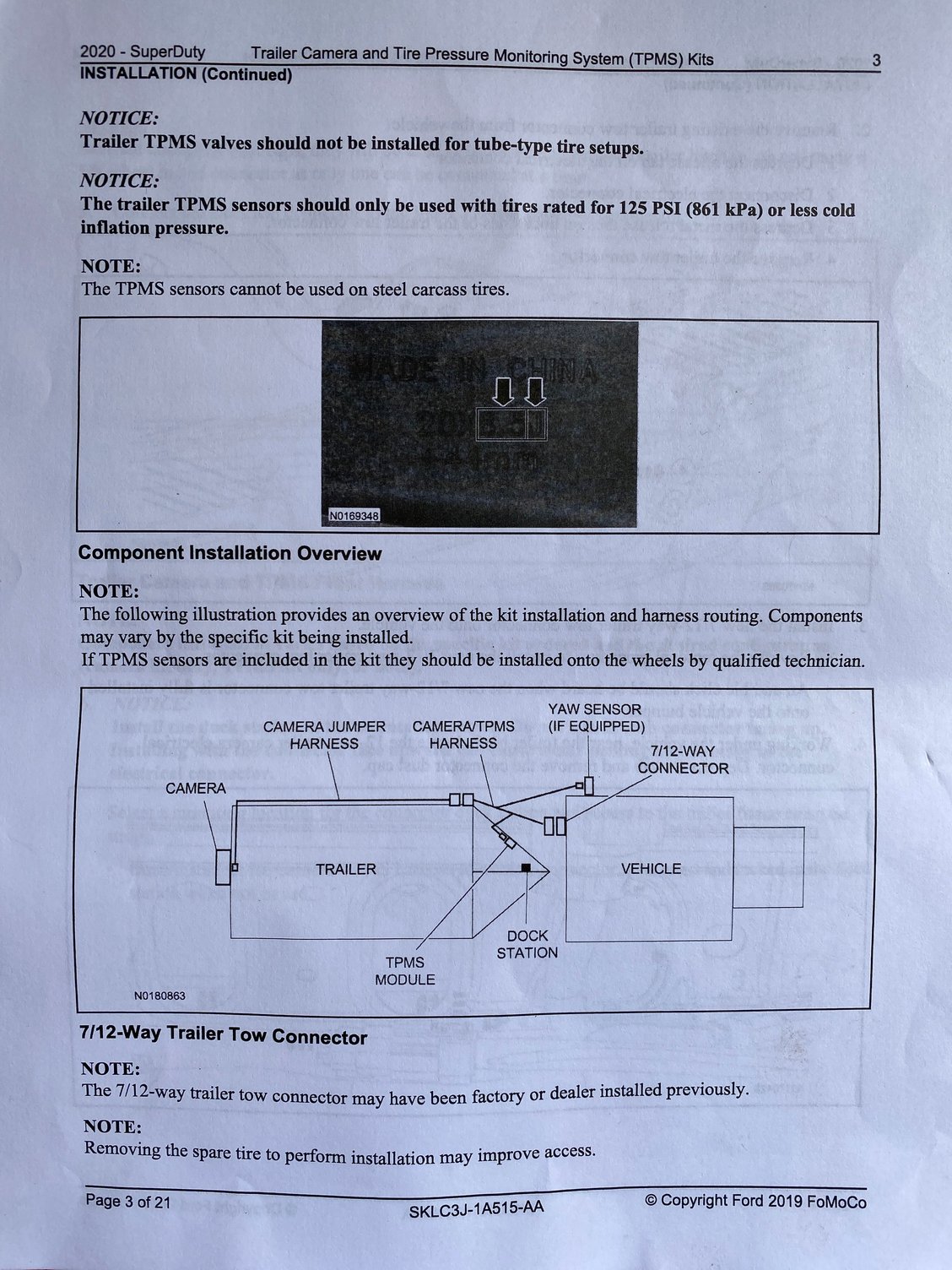

YAW Sensor
I have a 2020 F 450
No instructions for the y’all
sensor. I thought it should mount on the trailer but the diagram shows it to mount on the vehicle. Could someone please tell me the correct way.

Originally Posted by Jerry Peek
I have a 2020 F 450
Thank you so much!
Jerry
That drawing is ridiculous. Yes, the YAW sensor mounts on the trailer. On a 5th wheel it goes on side of the pin box. There should be another instruction sheet in the plastic bag with the YAW sensor and its harness. I think that what the drawing is showing is the bed mounted 7/12-pin connector being used for the YAW sensor and the camera/TPMS connected to the bumper 7/12-pin. That was probably before they had the 3-way harness so you could connect everything at the same time.
What all you you going to connect?
