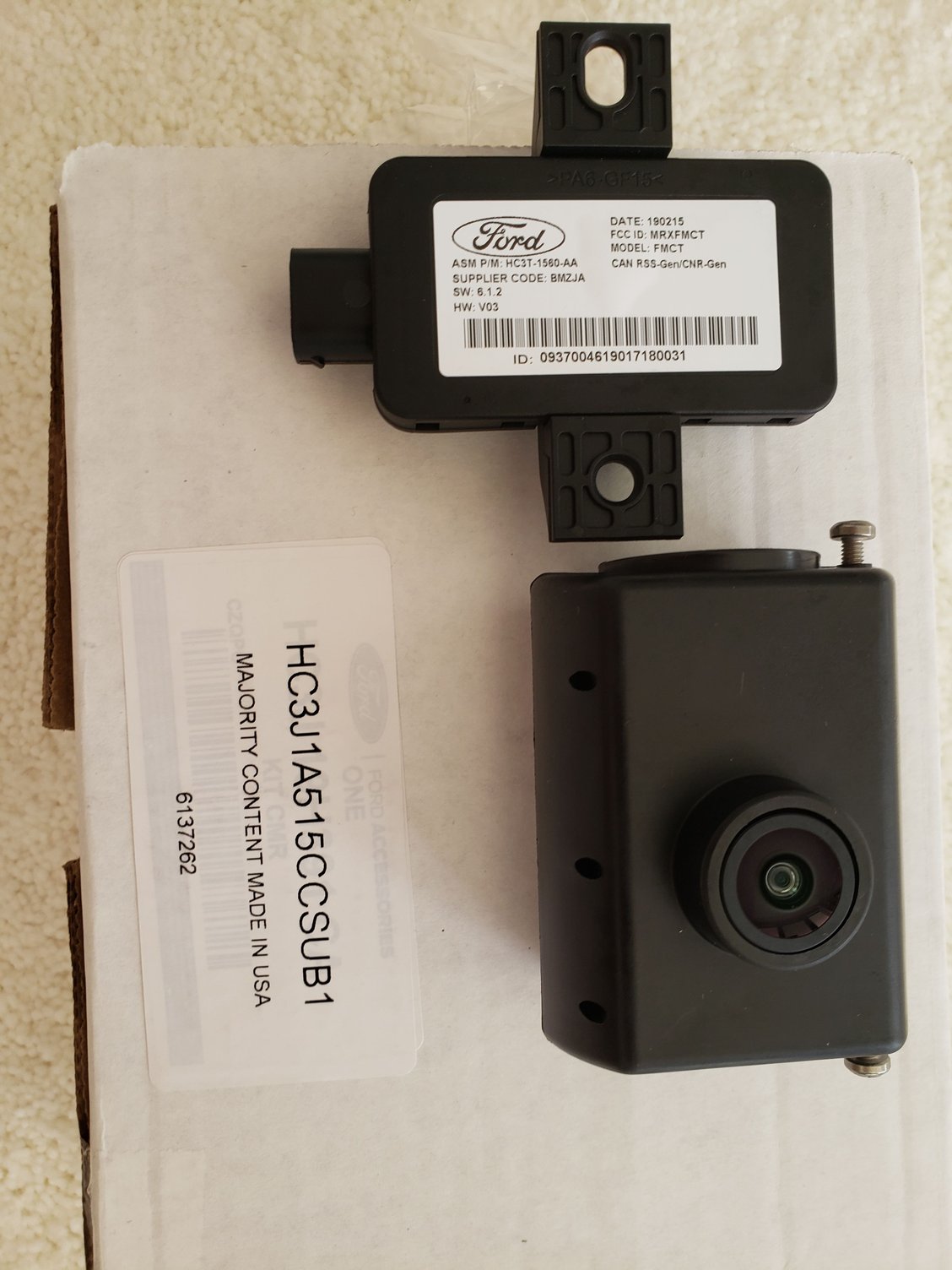

BertSCHB
Below is a picture of the camera, the box that it came in with the mount, and the TPMS sensor turned over so you can see the part number. The TPMS sensors are part number HC3J1A515ACSUB7

Originally Posted by Rich53
BertSCHB
Fantastic! Thanks a million! Now if I can just find somebody that has one...
