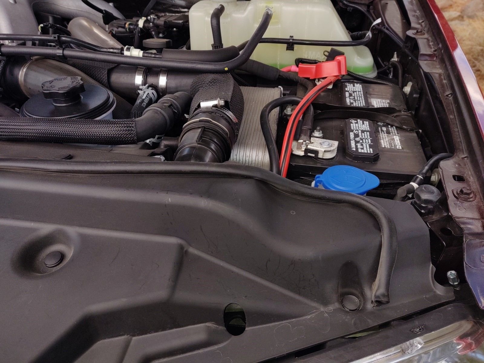

Hey MH, can you do me a favor? Can you look under your hood and see if there is a rubber like filler piece on one side or both sides. It's above the head light between the front top edge of the fender and the hole where the air intake is for the air filter. My truck only has it on the passenger side and I'm wondering if they forgot to install it on the drivers side or if its only supposed to be on one side, seems like it should be on both. thanks
I only see the rubber piece on the passenger side. This is a F-450 and I understand that there may be differences with duallies. Please see the pictures below.

perfect Thanks MH. That's the same as my F450. the only thing I can think is that they are trying to keep water from running along the fender and then wrapping around into the air intake area. Blocking/diverting it with the rubber piece to force it to drip off behind the air intake.
No problem. That does sound like a good reason. Glad that they thought about it (or maybe fixed a known problem).
