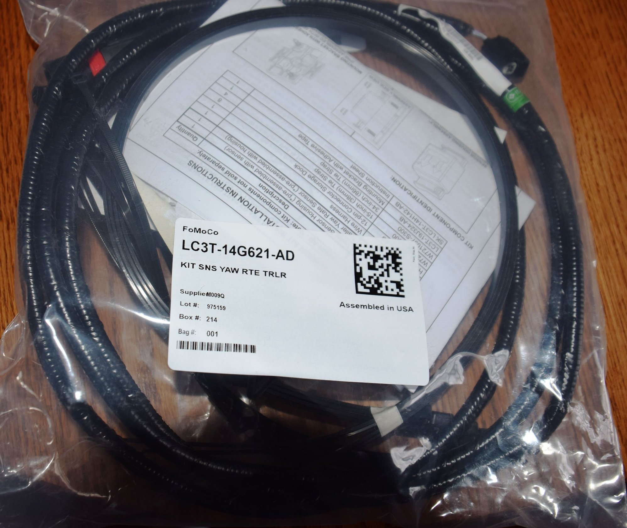

Here is the YAW Sensor kit that comes with the 5th Wheel Prep Kit. My truck was built in 10/2020. Like was stated above, this was on the back seat and the TPMS kit (I ordered without camera) came to the parts department a few days later. I had the salesman follow up to let me know when it arrived.

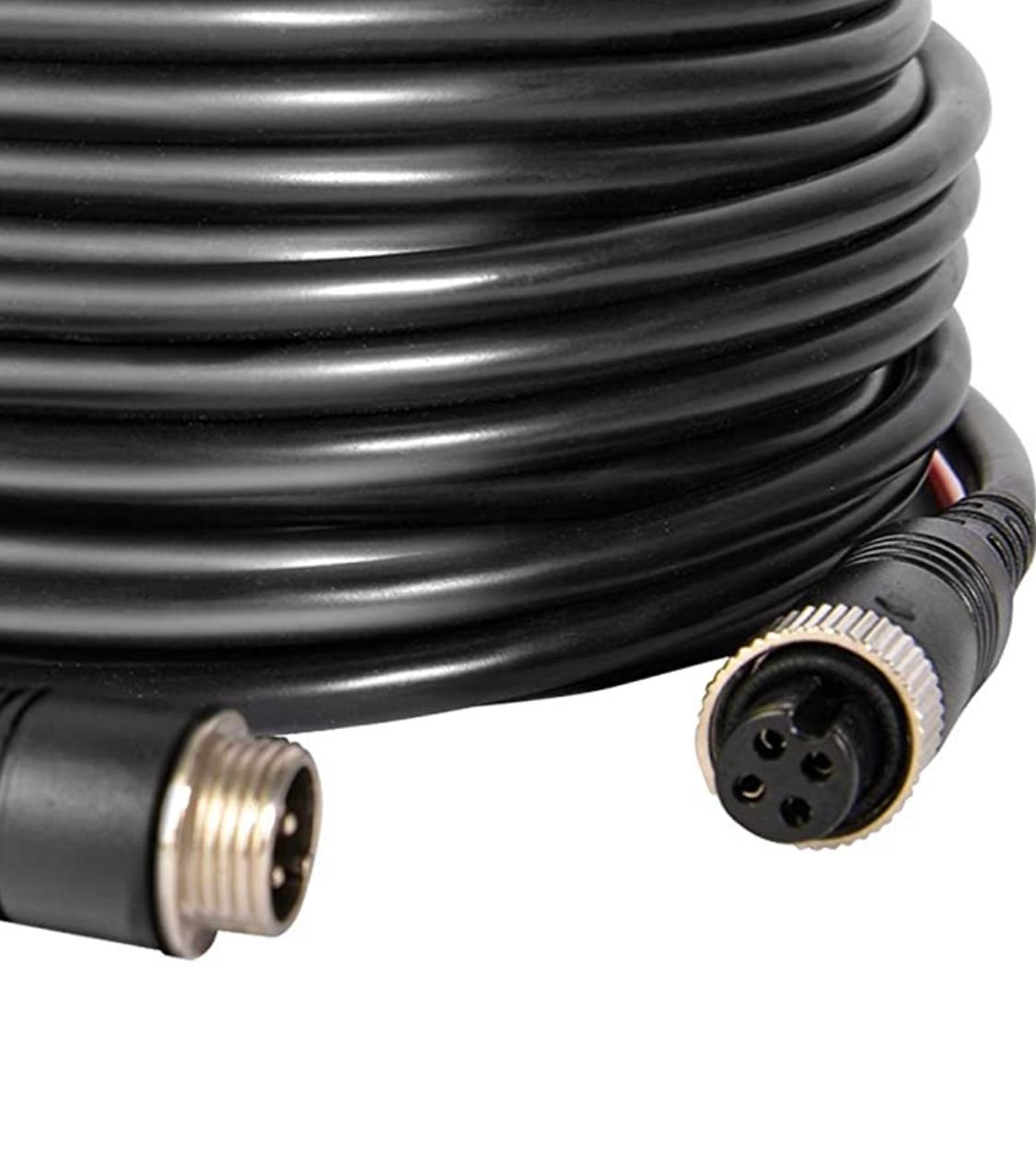

I sure wish I had found this thread earlier. I spent last night pulling the housing off the pins.
i have fifth wheel prep with the ultimate camera package and PTBA. I have the harness that has only the YAW sensor. My plan is to buy a cheaper than OEM camera and install it. The camera has a 4 pin cable. I’m assuming all I would need to do is obtain some pins, splice this camera wire, and install them in the correct holes on the harness. I will attach a picture of the cable type that comes with the camera. If this will not work please advise.
Finally, does anyone have a diagram of which pins are for the camera only? I currently have 4 pins taken up by the YAW sensor. I have only seen pictures above that include the TPMS as well as the camera of course. I’m not sure which of those pins are specific to the camera.
Any help is appreciated.

I just read this entire thread on my phone and you and the OP on your link solved my problem in 2 minutes. I really appreciate it.

Hopefully your problem was fixed, and your up and running. I to had originally order my truck with the trailer back-up system and then wa told they no longer offer it. I did get the trailer yaw sensor kit and added it tot he trailer, unfurtionity ly, while driving I puller the cable out of the connector, pins and all. As seen in some of the photos, they do not use all the pin holes for the yaw sensor, so it would be possible to add the additional wiring you need to complete the trailer back-up camera. I had to order another Yaw sensor for a different trailer, and I used that plug to see where my wires needed to go back in. The Yaw sensor part number is LC3T-14G621-AD and about 160.00. You do not have to have one for each trailer, but it is very convenient.
