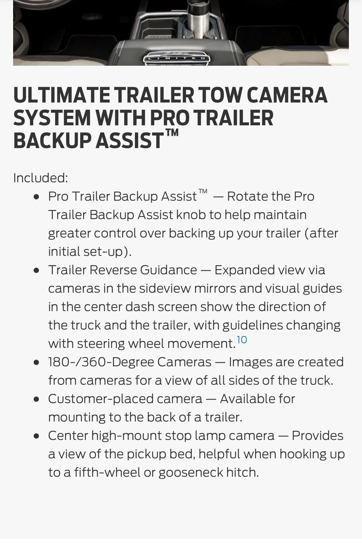

I just want to know if the dealership owes me anything. Because when I look online, on Fords website, it states “customer placed camera included”. I’ll attach a link and show a picture. Just wanting to know what else I’m missing.
Link——> https://www.ford.com/trucks/super-du...otrailerbackup

I have a 2020 Limited and it still doesn't come with everything, does not include the trailer camera, you have to order that separately.
Although a 450 does automatically come with the 5th wheel prep and the in bed 7 pin and 12 pin connectors.
The secondary 12 pin connector accepts the trailer harness with any of the one to three options on the trailer you place, TPMS, the 5th wheel yaw sensor and the camera.
Your linked graphic states "customer placed camera - available........"

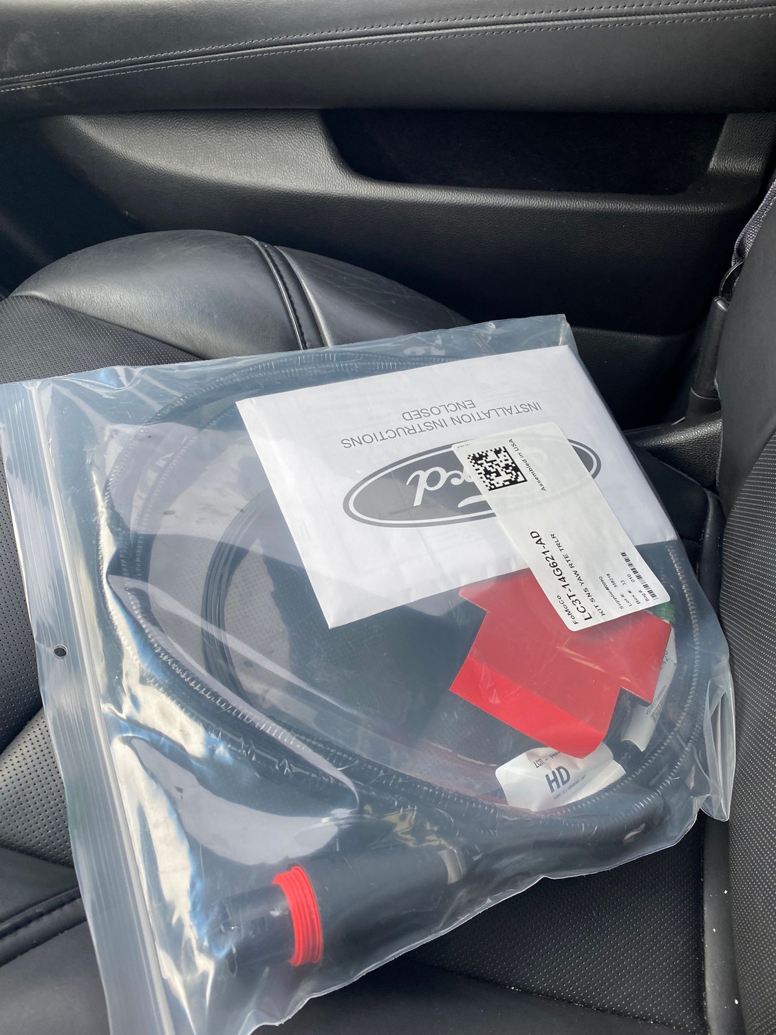

i just picked mine up. All the superdutys with Pro Backup assist come with the Yaw control harness.
I’ll add a photo of the harness you need for 2020 and above.
