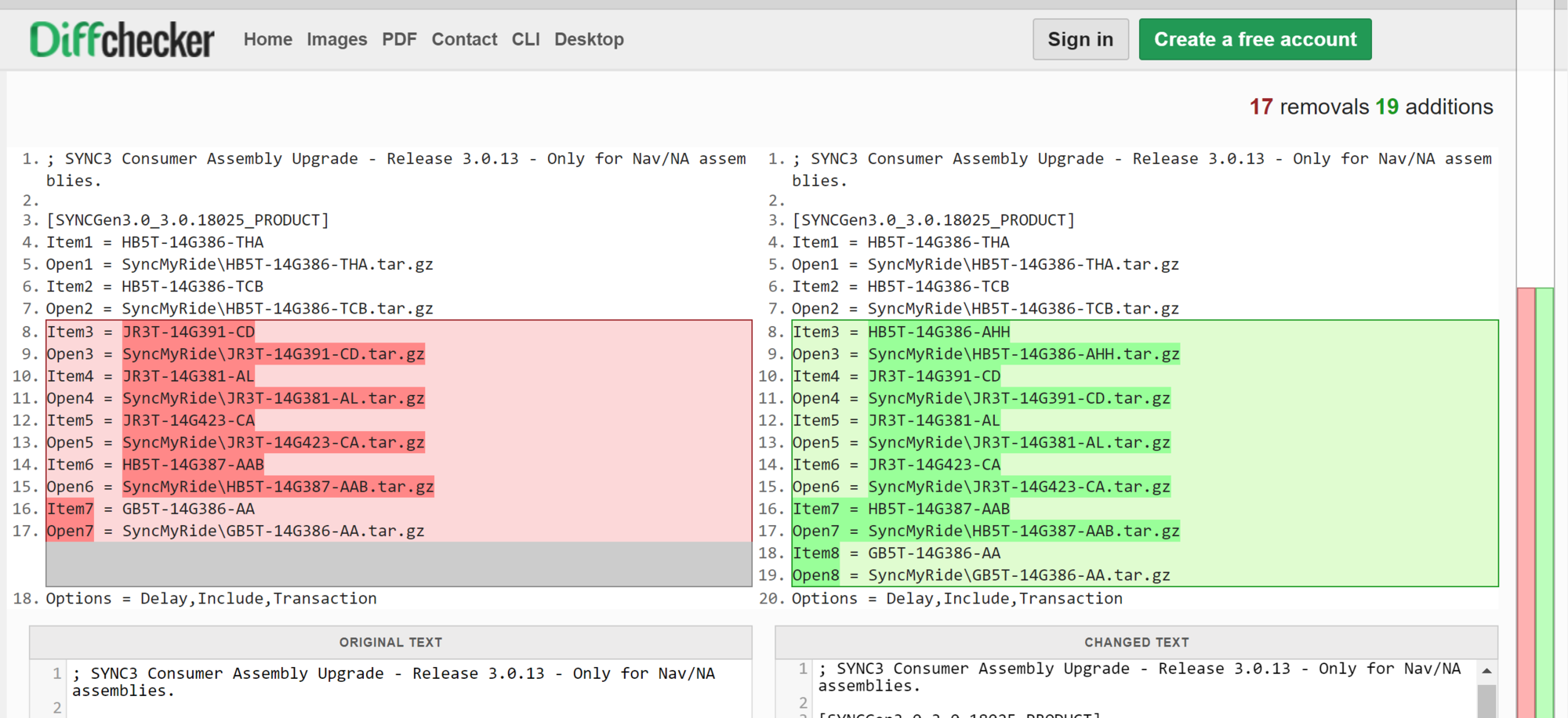

Originally Posted by SoylentSaxgod
no it isn’t. But I’m not here to argue. Take it or leave it.
(What number does the original end on?)
i removed the file that does the version check from the order and updated the other numbers to correspond.
Yeah, I looked at the two sets of data and noticed the one command line being taken out. Rather than remove that line myself, I followed the instructions and replaced the works. Thanks again, SolylentSaxgod. Nice work!
I used an online file diff program and it said it was identical. Perhaps I cut and pasted the SAME info. Will check again. Didn't intend to argue, just contribute.
Edit: When I copied and pasted the original from the text file, it must not have copied to the clipboard and I just pasted the same thing twice. I just did it again and it does in fact show a difference. Again, no argument intended. My bad.
