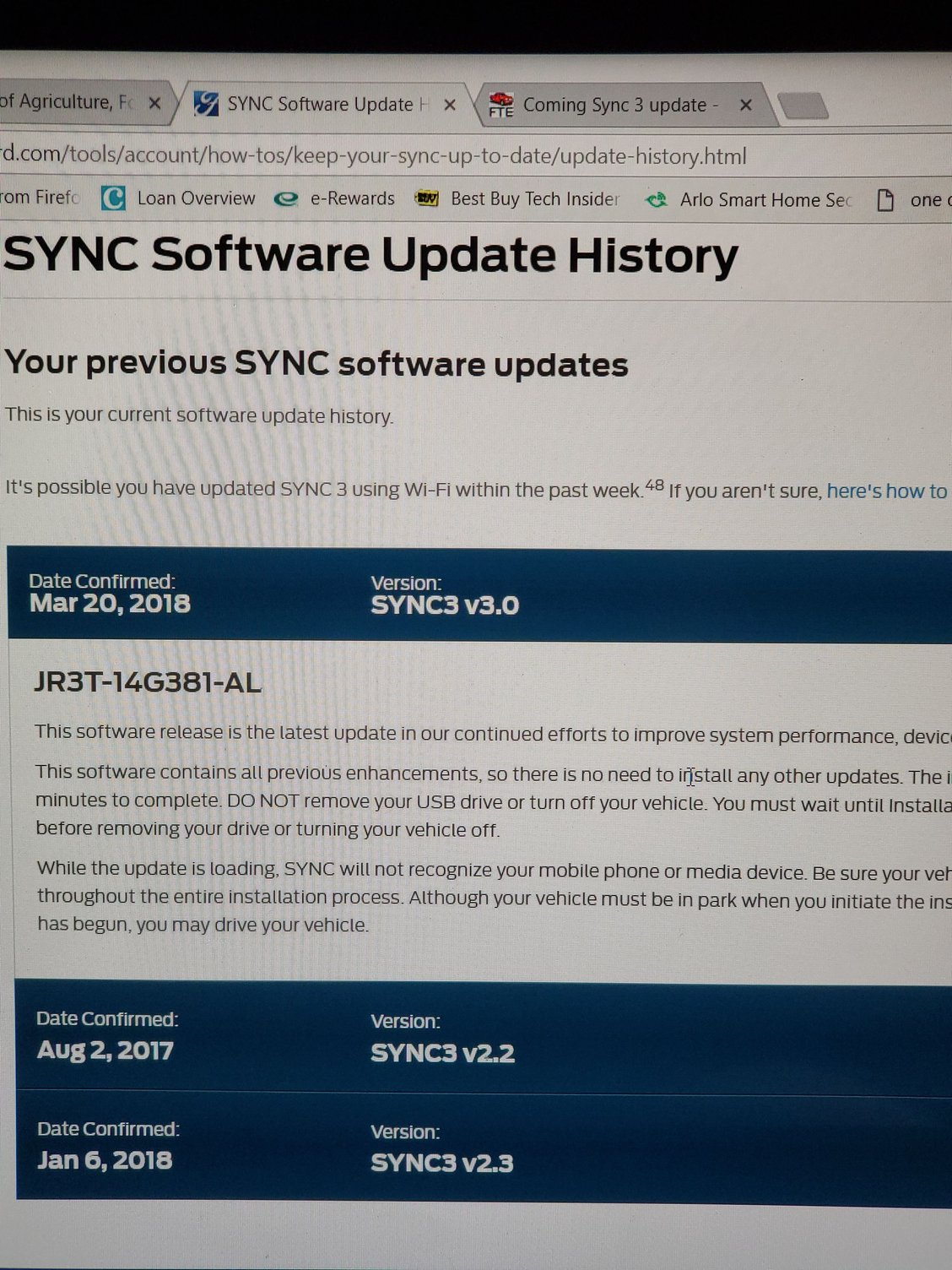

I think this is interesting, but I dont know what it means I wish Ford would share more information.
The sync 3.0 version I downloaded from the Ford site last week was JRT-14G381-AL
The version my truck tried to download this afternoon over wifi is JR3T-14G423-CA
I'm not sure what the difference is. Ford owner site still says I have the latest update

Posts: 57
From: Kentucky
Originally Posted by wb6anp
Mine is doing the same thing but doesn't seem to want to download it, maybe its a patch, Did yours ever dl?
I left mine for about an hour with the truck turned off. When i came back, the download bar was gone and the last update check went back to March 3. I cant find any indication that an update has taken place. As you can see from the pictures, ford still has my update history on a different version than the one it was trying to download. I guess the short answer is .... probably not, but it is no longer trying to
