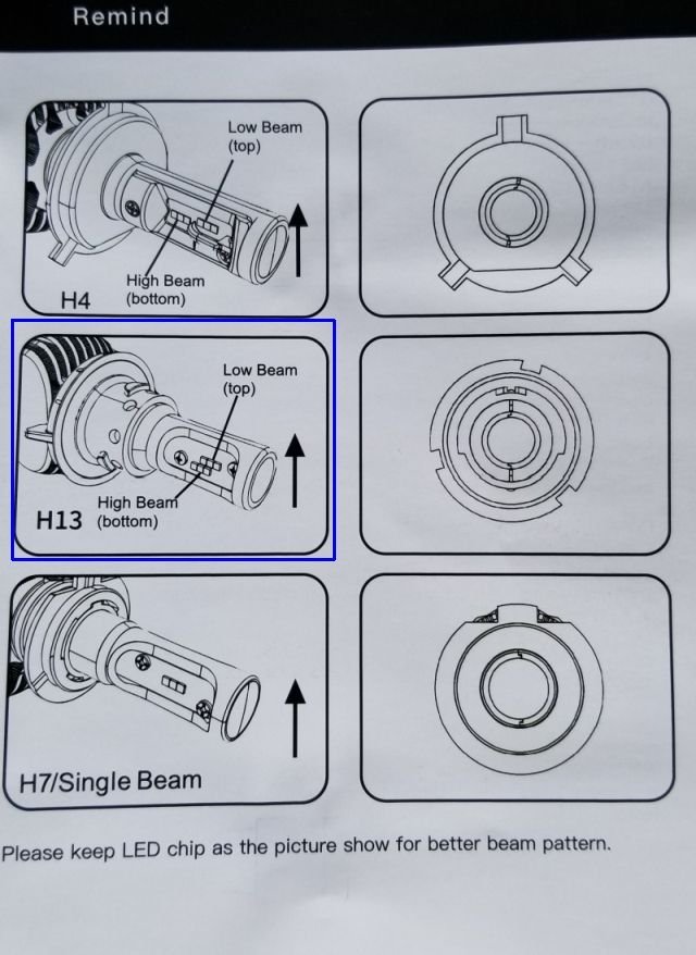

Originally Posted by h20camper
Should be like this:
Dude perfect!!! Thank you...going to check mine and see if thats my issue.
Old Aug 18, 2020 | 05:54 PM
  #830
barry1me's Avatar
barry1me
Posts: 255
found my one upper bulb was upside down...just swapped it...going to try again tonight to see how bulb coverage looks...it was horrible before.
Old Aug 18, 2020 | 08:40 PM
  #831
barry1me's Avatar
barry1me
Posts: 255
update on a 2020 STX with the beamtech 10k lumens..after making sure proper alignment vertically, and the low/high beam LED chip in correct orientation. The low beam has a decent beam, not much flood, the high beam is extremely spotty. Im considering putting stock bulbs back in, I don't think the Beam-tech 10k lumen bulbs work well in my bulb housing.

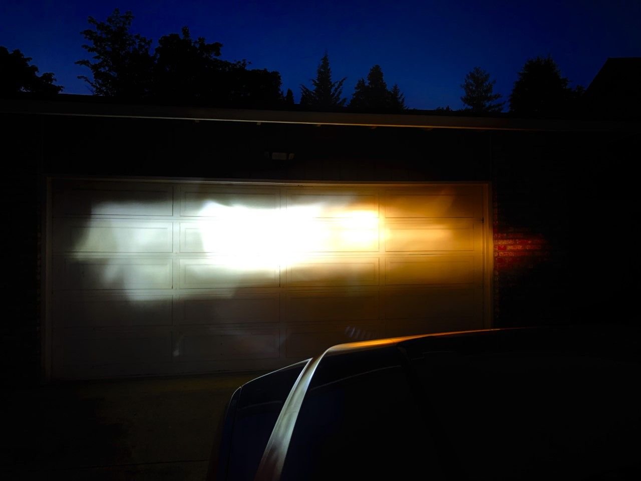

I went with these,
Amazon Amazon
It seemed like the beamtechs could be hit and miss so I did more research. I got in contact with some of the reviewers and got real feedback. Couldn't be happier, WAY brighter than stock halogens. Beam pattern almost exactly the same, auto brights working fine. No flickering after two weeks. No one flashing me, no error codes. Fingers crossed they last.
Old Aug 19, 2020 | 02:40 PM
  #838
barry1me's Avatar
barry1me

2020 f250,
no FM interference.
no high low beam comparisons (struggled to get a good picture. But here is a comparison of the LED vs Halogen (both low beams, I have a really steep driveway).
Old Aug 19, 2020 | 05:35 PM
  #840
Thevol's Avatar
Thevol
Joined: Jul 2020
Posts: 370
Likes: 87
Originally Posted by Scott Roemmich
2020 f250,
no FM interference.
Thanks for the pics, lo beam looks good. Does the hi beam look pretty good too, when I have used LEDs bulbs w/ reflectors in the past the hi beam is usually underwhelming and doesn't have much reach?
