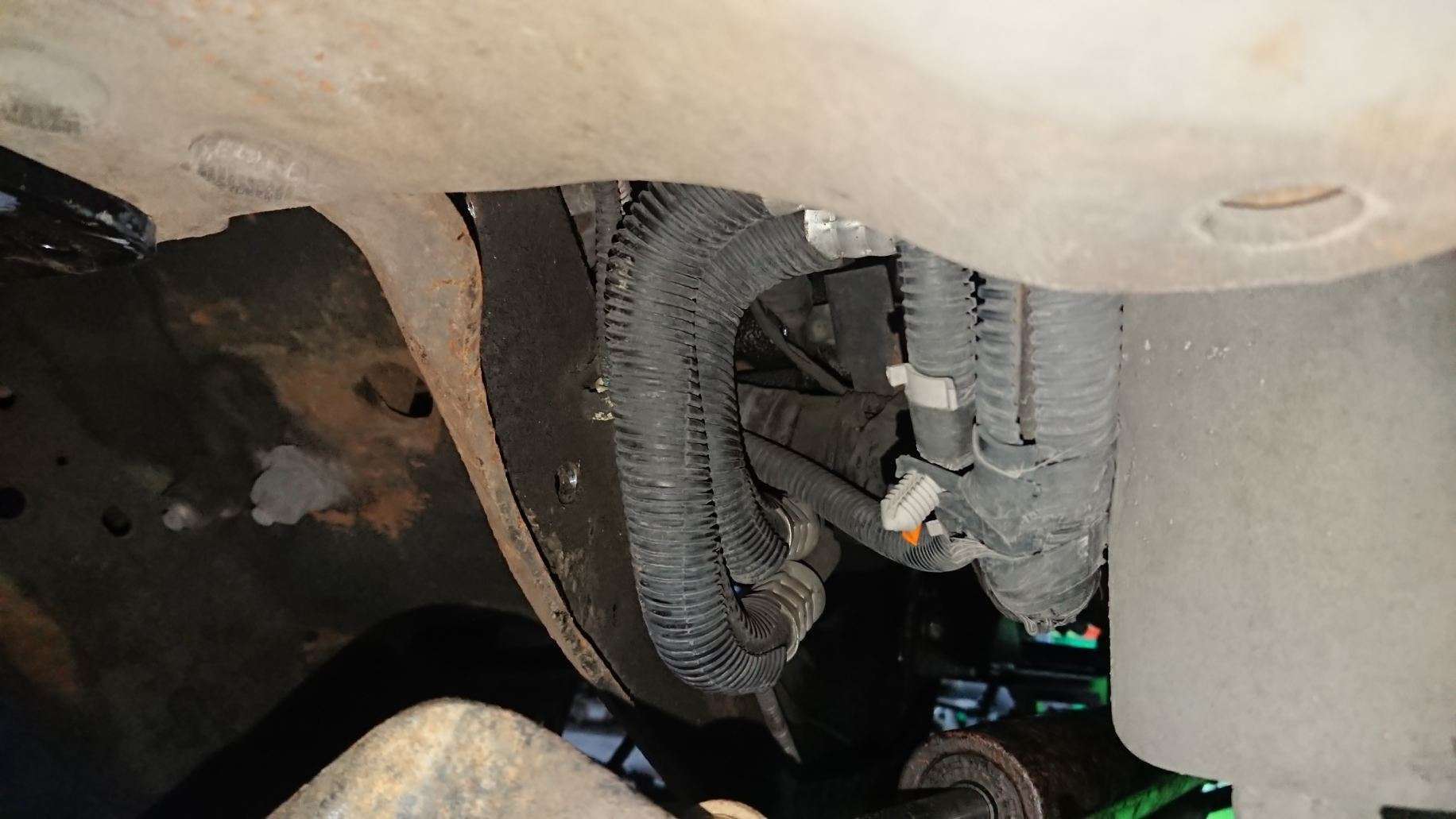

v1.5 complete
Mike,
My axles are finally installed. They ended up not using the donor MC, mainly because they couldn't find where they put it. One thing that we ran into and I am not sure if this is different since I have a 6.0 but the trans cooler lines are in the way where the steering damper shock bracket mounts to the cross member. The easiest solution in my mind to this is to just remove the stock damper and replace it with a dual steering stabilizer kit, which I planned to do since I am looking to run 35's.
I will say it rides a lot better and definitely turns sharper. I didn't notice a ton of difference on the brakes, this could be in part to the rust on the rotors so I might end up replacing those in the near future.
I went with axles out of a 2006 F250. Front has a level kit and now my rear is sitting about 1.5 inches lower than the front. I plan to do some mods on the springs but need to figure out how I will retain my airbags. Wheels are tires will change once I get the 2015 clip done, it heads in for that next week.

Great news! I do not have trans cooler lines there on my 7.3, so it is likely a 6.uh-oh thing. The truck looks good in the pics. Sorry they lost your newer MC. I have one somewhere if you want to switch to one later. You really should have the larger MC to go with the larger pistons/calipers.

Transmission lines go through that area on most of the SD's, lines for my ZF6 go thru there but run under the stabilizer, but the rubber lines going up to that filter system is a 5R100 thing.
Ok that make sense. We still mounted the bracket and it works. The shock just rubs the lines a little bit when cranking the wheel. It also rubs the lower radiator hose a bit. The shock is pretty rusty and I am guessing it’s the original so rather than replace it I’ll put the duals on.
