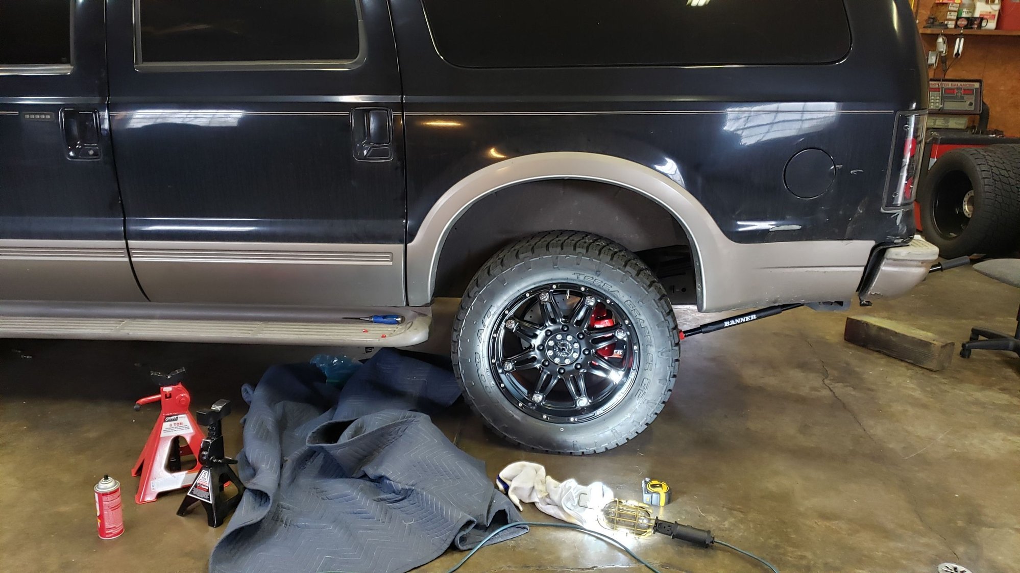

Here we go
And so mine begins! So much thanks to Mike!
Won't bore you with the rear install details other than a pic and to say the only thing I did differently was using the rear flange of the donor driveshaft on the Ex driveshaft and when I rebuilt the parking brake I used the older lever style so I could reuse existing cables.
