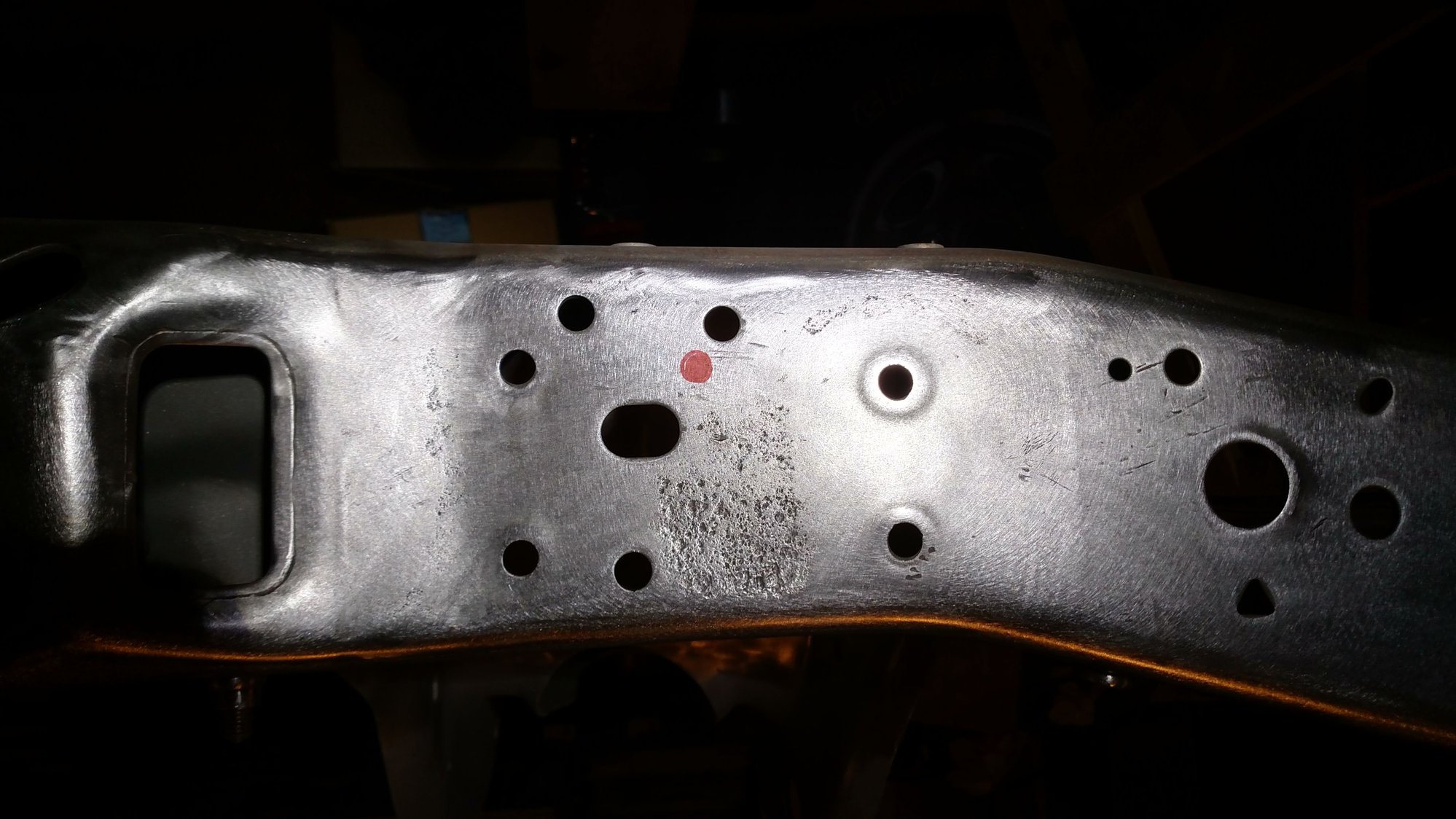

Finally getting around to posting some info on some differences on a MY 2008 F250 front axle donor (build date 06/07). Back on June 16 I went to the Gold Mine with Mike to pull my axles for my 01EX axle upgrade. First of all, that is some tough work, especially in that Texas heat. I'm not sure if I helped Mike or hindered him. If he has pulled axles for any of you, you need to thank him again. That was a full day of work.
On to the differences.
1. Coil buckets have a locating dimple on them.
This is the corresponding locating dimple in the frame on the 08 donor F250
This will not fit our EX frames and must be removed. I know Mike's intention was to keep this cheap and simple for the driveway DIYer. However My father-in-law has a metal fabrication business, so this is my fix
Remove the dimple with a plasma cutter
Cut out a washer with the plasma cutter to fill the hole and weld it in
Then grind it smooth(ish)
After I got these home I realized I shouldn't have had the hole burnt in the middle. I should have just had a blank welded in and used an existing hole in the frame. If I would use the hole in the washer that was welded into the coil bucket, the frame would get another hole where the red dot is.
I'll probably just use the hole above and to the right of the red dot.
