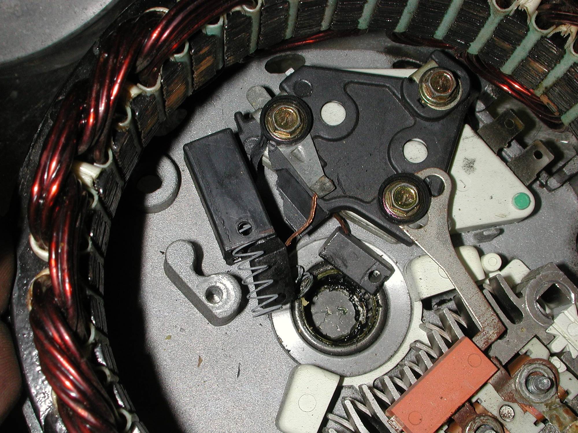

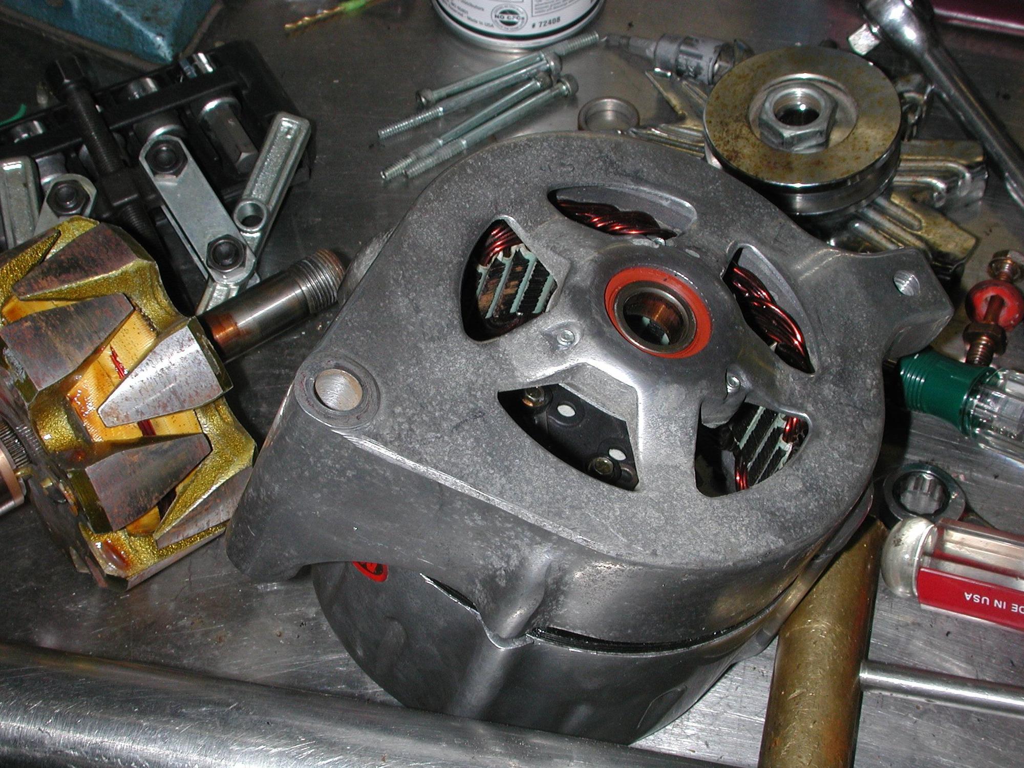

Pulled the alternator today. It is a Powermaster 8-67141 and is shown as a one-wire upgrade for Fords with a max output of 140 amps.
As said, it doesn't have any output, and I was hoping it was either the style that allows you to short a terminal and kick it into full output for testing, or that it has oiled-up slip rings. Neither is the case. In fact, I don't know what kind of alternator it actually is. I've included a couple of pics below in case someone knows since I need to rebuild it since the brush housing is broken, which I probably did in disassembling it. And don't know what parts to buy since I don't know what alternator it is. I have a call into Powermaster, but who knows if they'll call back.

Well, Chris from Powermaster returned my call. Turns out they don't sell a rebuild kit and you are supposed the send it in for repair - but they don't charge for labor, just parts. However, he did tell me it is based on GM's 12SI alternator but with special parts.
