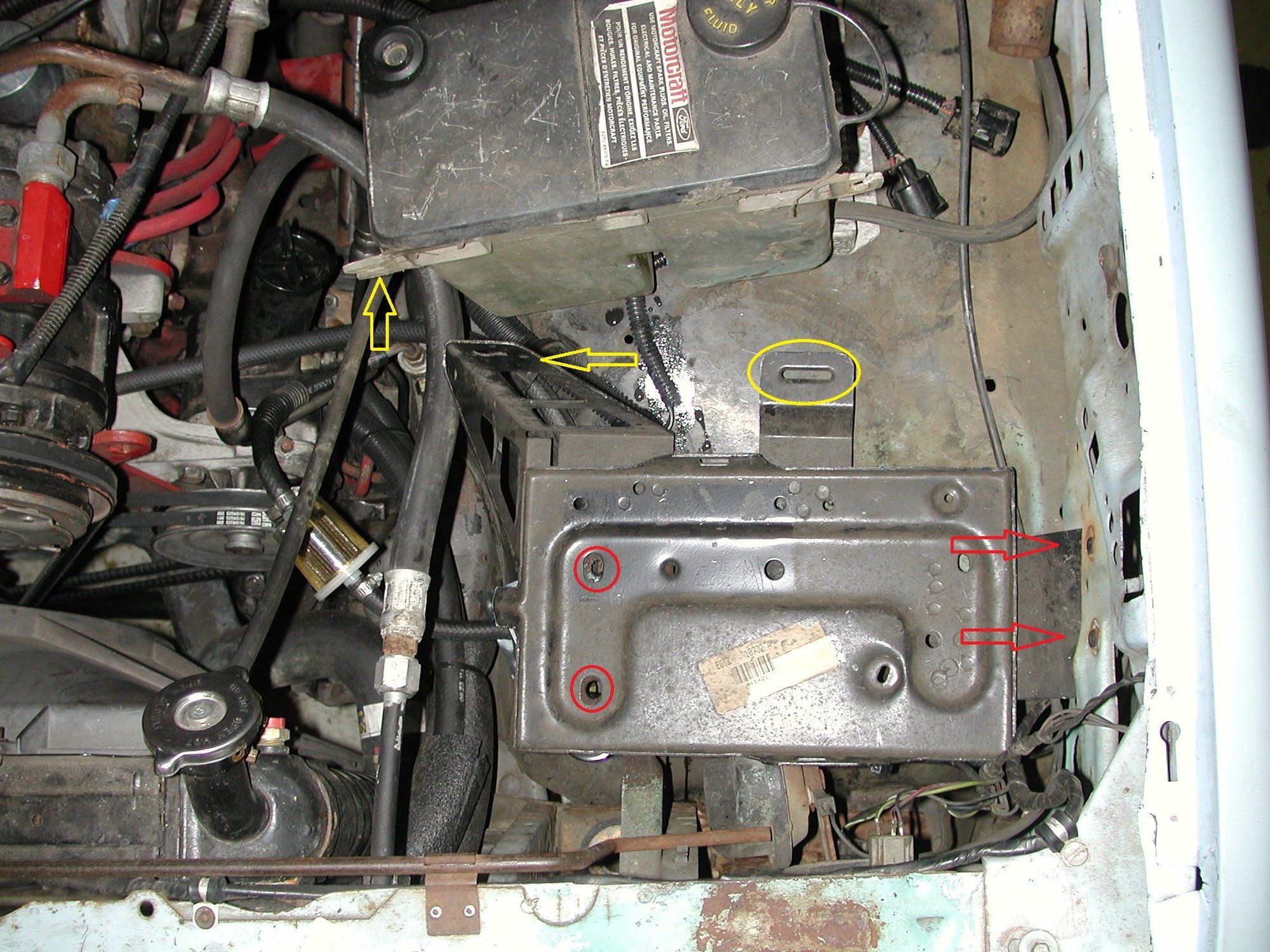

Mike - Thanks for your input. I got it figured out! Here's a shot of the aux battery carrier sitting where it is supposed to go.
  • The red circles indicate where the N605892 bolts go through vertically. And, by the way, I found a neat web page that explains that those bolts are M6-1.0 x 22.5mm.
  • The red arrows show where the N605892's go through horizontally.
  • The yellow arrows show where the ear on the reservoir bolts to the carrier
  • The yellow oval shows where a tab on the reservoir is supposed to sit. However, this reservoir has the tab broken off, although you can see what the tab looks like at this neat web page, and it is shown within a yellow oval - oddly enough.
Maybe just the difference in model years, or maybe specific to dual battery setup, but my on my '82 the hose from radiator to coolant reservoir goes in at the top of the reservoir, not the bottom. There is no nipple on the bottom.

Mike - I think the bumper sticker should read "I'm not through peeling this onion, so from time to time I have to stop and peel another one and cry a bit."
On the reservoir, it is a difference in model years. Go look at the "neat web page" link and you'll see the difference as well as how to swap to the later one. And, I highly prefer the later one as I find it much easier to keep the radiator full with them.
