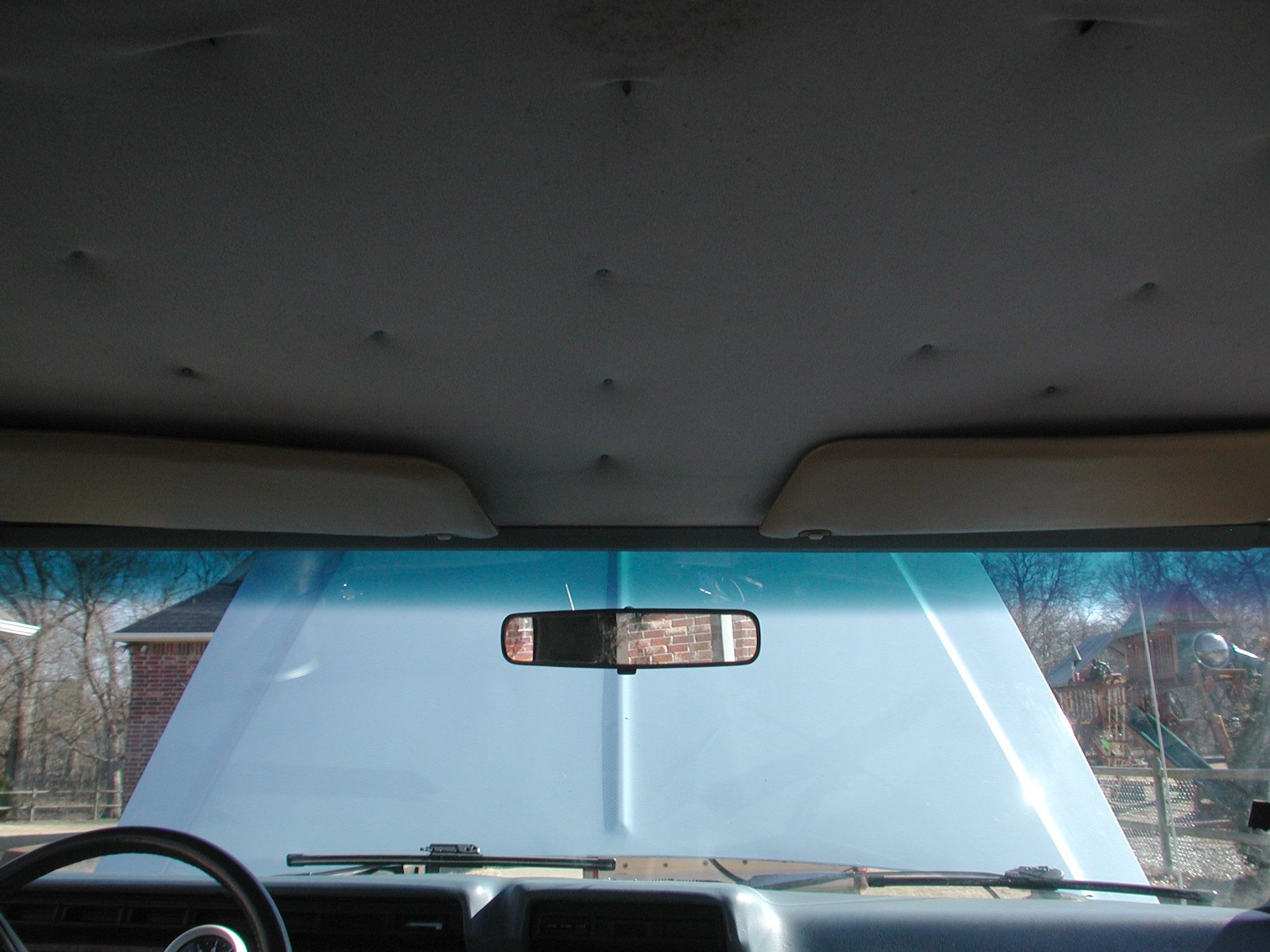

Here's a pic of the rear view mirror installed as well as the "new" sun visors - note the clips just above and either side of the mirror. The visors on the Bullnose trucks are one of my few pet peeves for these trucks, and the newer ones fix the problems. (Yes, they are brown, but I can paint them later or find some blue ones.)

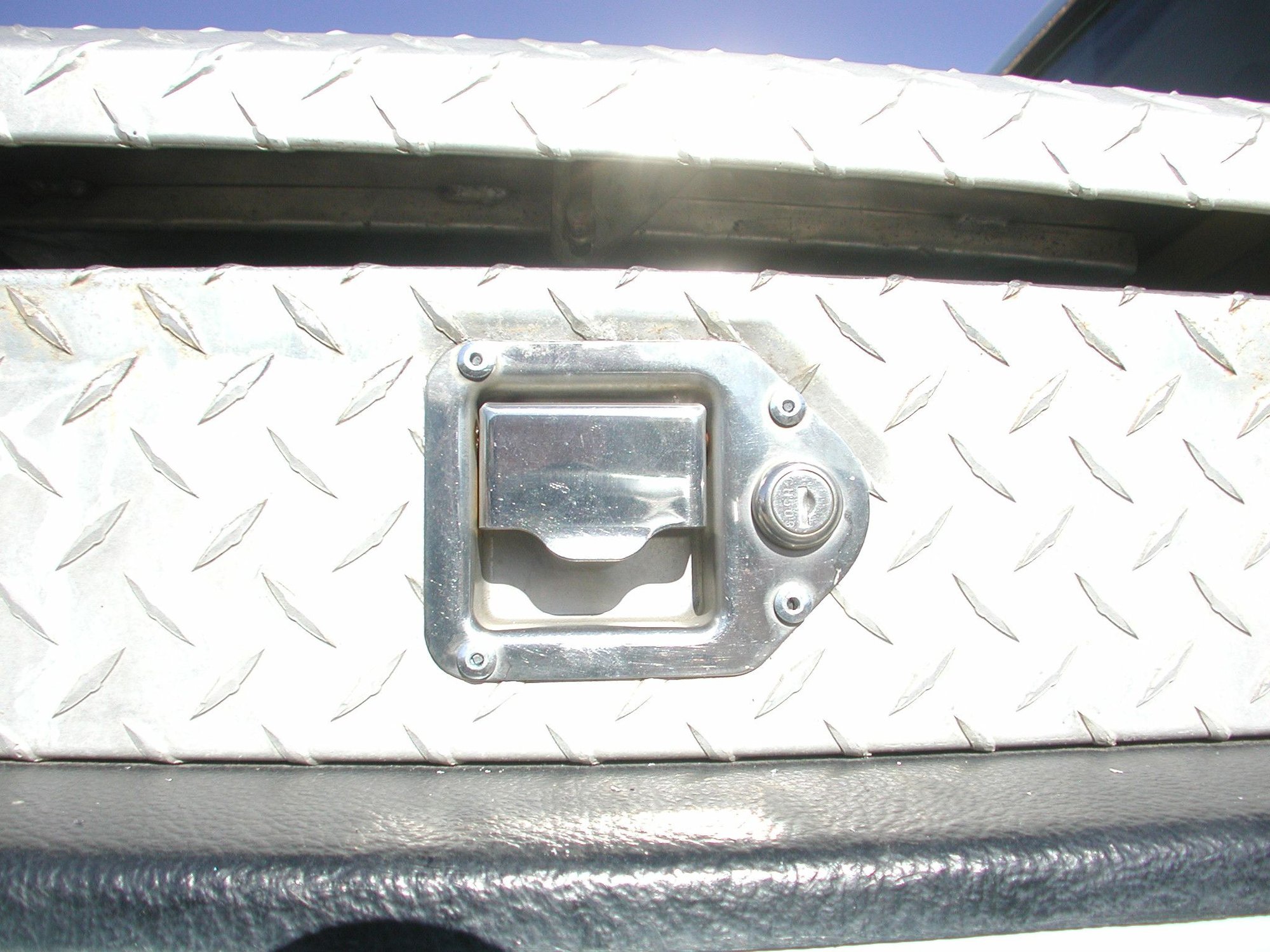

And here's the latch for the tool box. Somehow all 4 rivets were broken, but I had the right ones as well as the backing plates, so we are back in business and can lock the box.

Looks great, Gary. Where did you get the visors? Is like to do that too.

I don't think I've ever seen a tufted headliner before.

As for the visors, they came from Bill Vose's son, and I think he got them at a salvage but I'm not sure. But I'm pretty sure they are from an '87 or later F-series truck. It is an easy upgrade.
Jim - The headliner has to be replaced at some point, but not too soon.

Good info on the visors! I found the original type in a J/Y to replace my very shot ones last year or so but always wished the truck had those with inward clips.

On the visors, you'll be drilling through the "ceiling" of the truck in order to provide a hole for the locating spike of the clip and one for the screw that retains the clip. And the clip should angle a little bit as the visor will be at a bit of an angle when it hits it. But it isn't precise as there's a bit of wiggle room. Just do it.
