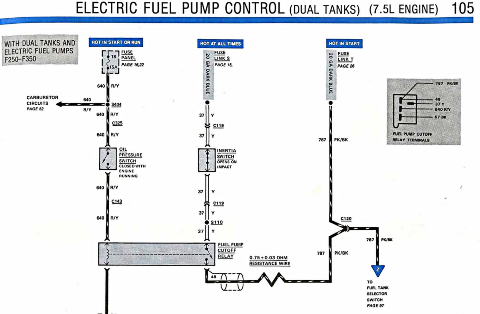

Like I said, some of that foil covered sleeve would probably be a big help preventing vapor lock.
Gary, you are mistaken about the inertia switch.
It DOES handle the full load of the fuel pumps.
It is the oil pressure cutoff that pulls the relay shut.
(go back and have a look at Subford's schematics)
Just getting the PM.
Let me take a pic for you in the AM

Jim - You are right, I am wrong. See the schematic below. I guess the only thing they've done, besides the relay, is losing the .75 ohm resistance wire. But, I'm not sure how much difference that would make.

1987 evtm
My '87 manual shows the inertia switch 'downstream' of the relay, and no selector relay
(It's all done in the switch)

Jim, it changed in 1987 then, Gary's picture is from my 1986 EVTM. Ford was changing the electric pump system every year I think. 1986 was the first without the tank selector relay as far as I know. The 6 port selector valve is only powered on those if the pump power is on, you can turn the key on and change tanks and nothing happens until you either crank the engine or it is already running.

Gary, i don't think the in-tank pumps are meant to run on full voltage (except while cranking)
Why would Ford add a resistor if it wasn't needed?

And, I plan to put the stock wiring back in service, so the resistor will be in place as well.
