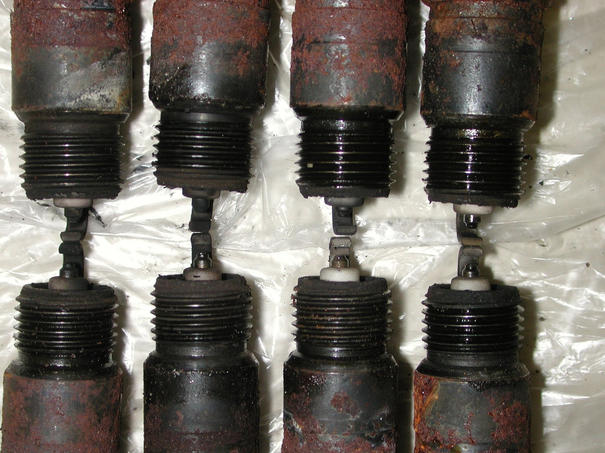

Did a bit of investigation on the engine today. Put a breakover on the crank bolt and turned it. Boy, was it stiff. So, I pulled the plugs, as shown below. Some show it had run fairly rich, but not too bad. However, when I then turned it over w/the breakover gas shot out of some of the cylinders. I then pulled the dip stick and either there isn't enough oil in it or the oil is so diluted you can't see it on the stick. But, what you get on a rag sure smells like gas.
This kinda fits with what we noticed when we were loading it on the trailer. In one case we turned the key to On rather than Acc and heard the fuel pump running - continuously. And we smelled gas, but didn't see any on the ground. I'm thinking the way the pump is wired lets it run all the time and it filled the engine.
I'm hoping it didn't really hydro-lock but just had so much gas in it that it couldn't possibly run. However, I'd like your thoughts.
And, here are the plugs, with #1 being top left and #8 bottom right:

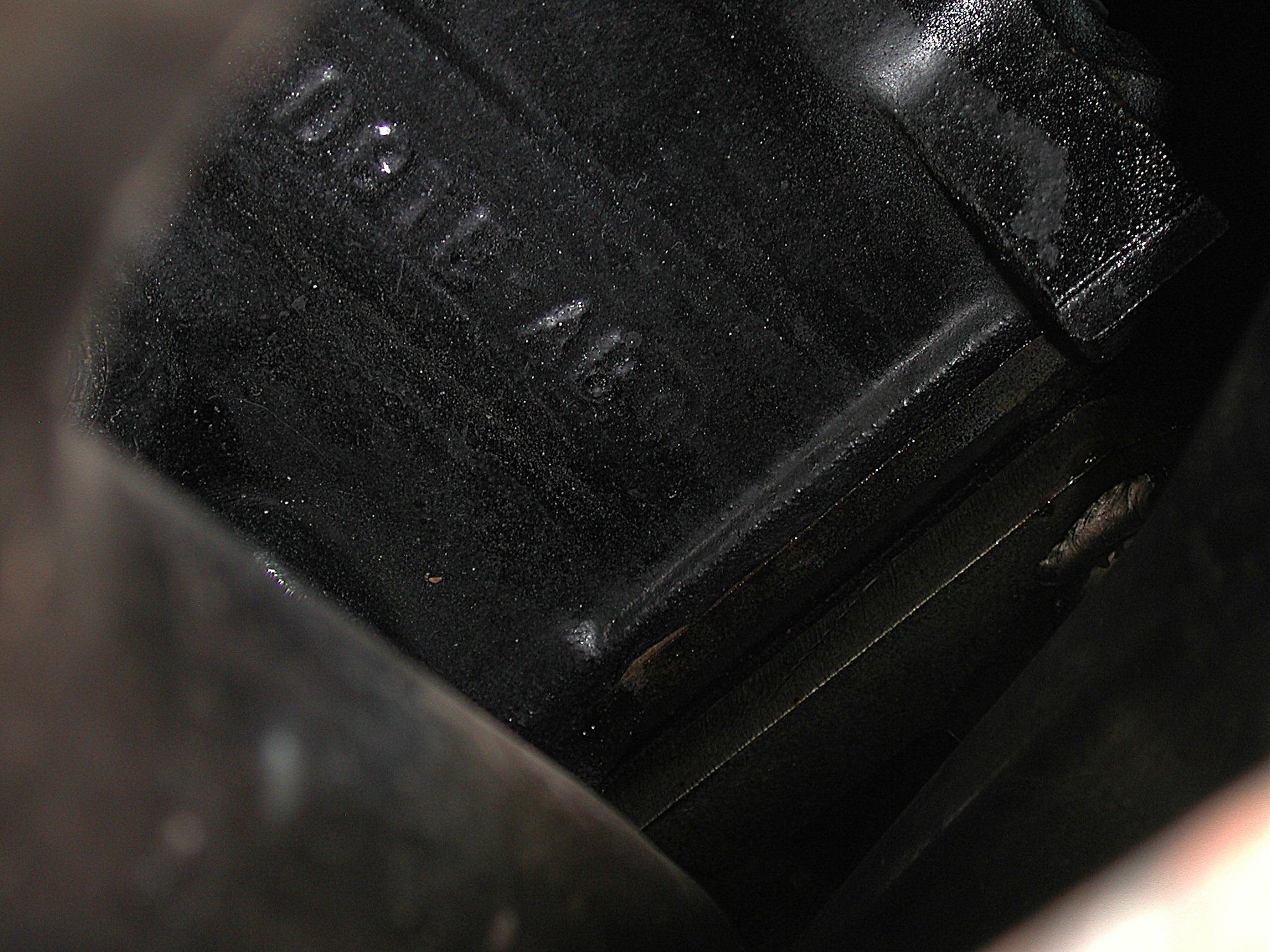

Here's the block #, which looks to me like D8TE-AB. But, is that what you see? If so, is that a stock block?

If its 'TE' it is a D9TE '79 & later truck engine
Everything prior was an internal balanced Lincoln block C or D with V as the third digit.

Likely wasn't damaged.
it turned over but you didn't get it running.
Change the oil and plugs.
Fit the regulator and fire it up.
