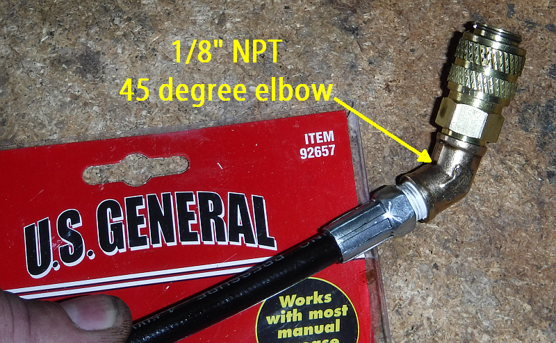

Oil rests around the neck of the GP. I have never been able to pull out a dry glow plug.
This is what I added to my HF compression test kit. The 45-degree elbow aims toward the valley and everything fits.
Yes, I did the same. The QC is about 23/32". My 10mm 1/4-3/8 adapter is 20/32". I could turn GP with the 3/8 adapter but it was rubbing on the round part of the rocker arm. When I switched to 1/4" extension all was well. It seems that even if I could muscle the quick connect on, there will still be significant interference with the rocker arm.
I wonder if you managed to get a narrower quick connect in your kit - something closer to 1/2" OD?

OR
do you drop the QC down closer to the injector than the rocker arm and then move it over UNDER the round end of the rocker.
From what I could tell, it seems like the QC would still end up next to the round ball on the rocker, not under it. That when I called it quits....
