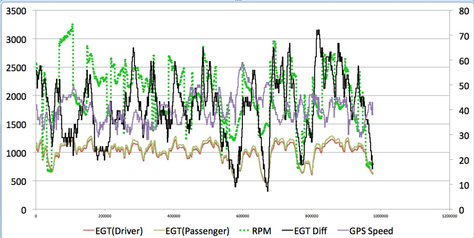

I think the truck may be more gutless after it's been driven for a while. Also, I know someone asked about manifold temps. At the time I was seeing manifold temps about 10 degrees above intake temps - I think this was with the truck warmed up, WOT but not a huge towing load.
After driving for 5 or 6 hours, towing 8,000 lbs, I ***THINK*** I see manifold air temps in the 160 to 180 degree range. The reason I'm saying I **THINK** is that these data logs are from DashCommand and I have not yet verified that the PID is providing the same values that Torque would for manifold air temp.
Do those temps sound reasonable?
If no does this point to a candidate for may low boost, bouncy EBY and high EGT issues?
I had to back off the throttle to 35 MPH on a 6-7% grade in some cases to keep the passenger side EGTs under 1250....

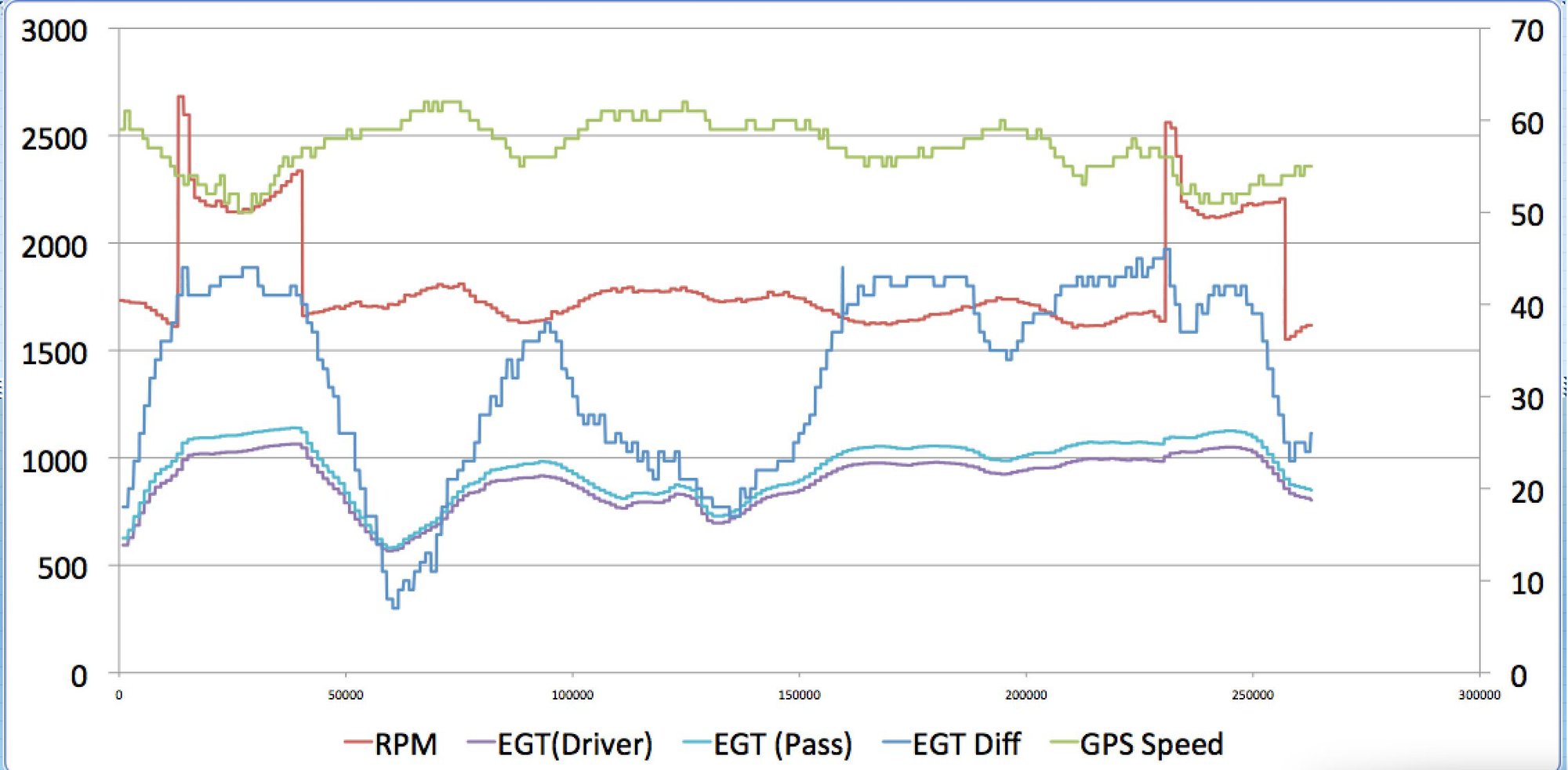

I'll have to find just a cruising log. Here's one where it's working hard:
Here's cruising, it may be up a smaller hill....:
I think passenger sensor is biased 20 degrees hotter than the driver side one to start. I have another log file from a much less hilly road and the EGT diff varies from about 10 to 45 degrees (see above).

Nah, nah, nah.... If your sensors are accurately portraying what's going on in there, that is precisely what a bad hole looks like. You'll see anything from dead-even to about 75 degrees F differential, depending on the driving conditions. This calls for a laser thermometer that can read up to 600 - 700 degrees F. Aiming at each outlet on the manifold, it's hard to spot a bad hole during idle, but you'll see about 20-40 degrees difference.
