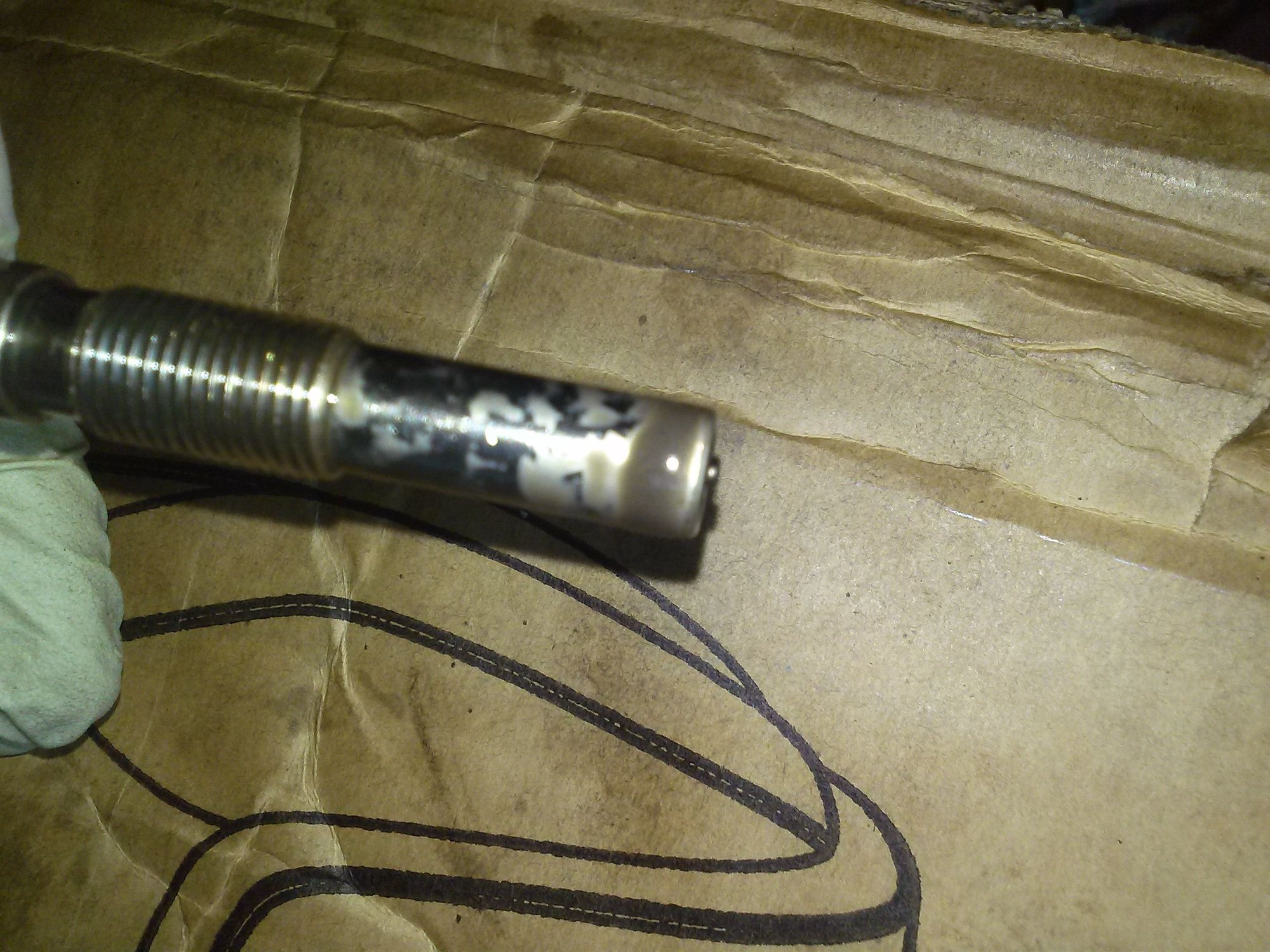

Here's the only strange thing that I noticed. On cyll7 the glow plug adapter had a brownish fluid on it after the test. I did not notice anything on the glow plug.
It's Almost like an oil and water mix. My coolant is red, so I don't think it's coolant.
