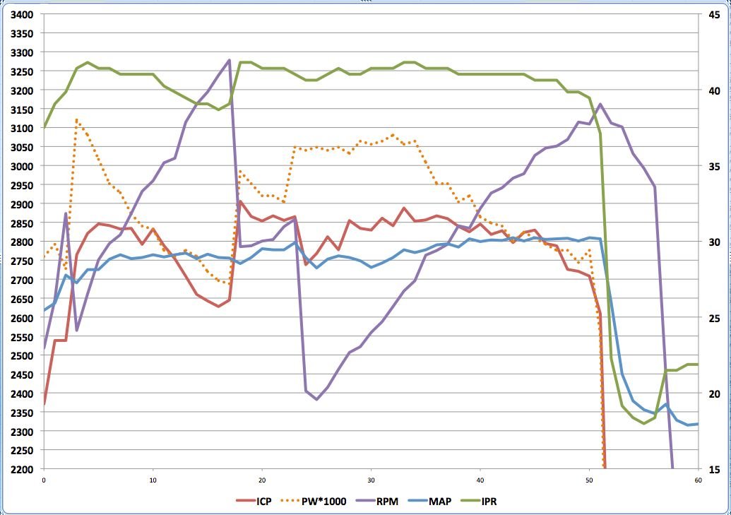

In the chart below, I hit 30 on MAP. The mass fuel desired is dropping as the MAP increases though. If the truck was really running all out, wouldn't the mass fuel desired stay high as well?
Also, I figured mass fuel desired would be directly related to ICP and pulse width. However this doesn't seem to be the case. Or would it be ICP, pulse with and RPM?
[EDIT] ICP Is actually dropping off as boost is still going up, it's just not as obvious as with the mass fuel curve [/EDIT]
Here's a zoomed in version of the above data (PW multiplied by 1000). It seems to me that my max boost might be limited by fueling here???

I don't mess with MFD or VFD - the tuners tweak this so bad that it can lead one down a garden path right-quick. I'm sure they are useful on a stock truck, but I have not set myself to learn what to expect here.
I see what looks like defueling, but I don't see the IPR or RPM numbers. When I look at fueling (and the results of the fueling), there is a whole list of parameters that need to be taken into account: RPM, IPR, ICP, FIPW, MAP, and EBP.

Don't have EBP in this. I can do another with that.
FYI I did a test the other day with EBP unplugged and didn't note any performance difference.
The RPM drop is the TC lockup in 3rd gear.....
