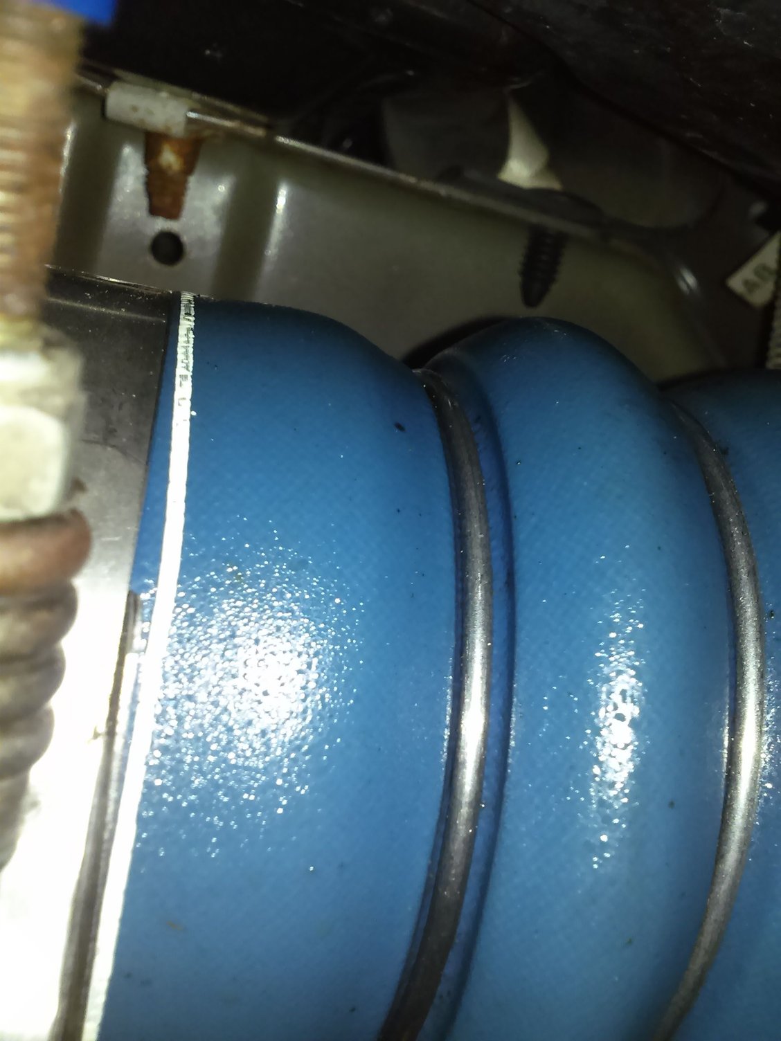

Oil sheen on the tube:

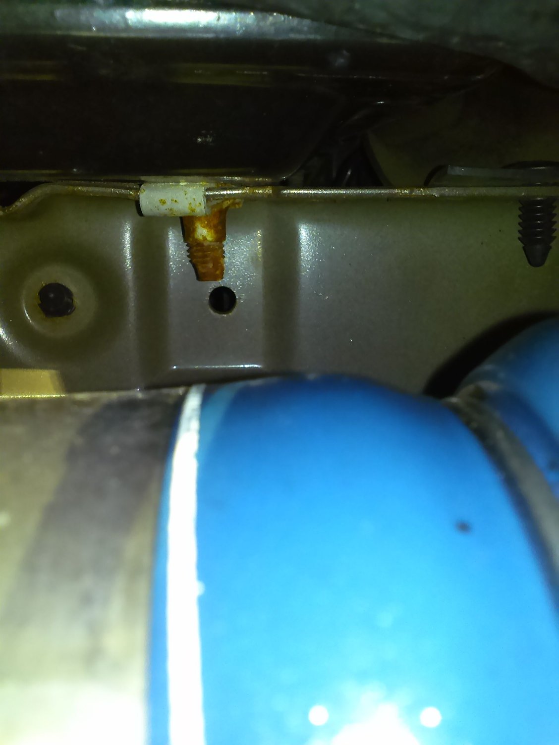

Maybe some made it to the sheet metal (I think this is by the battery - but I'm not positive).
The only oil found at the clamp, but the insulation on the pipe **seems** dry.
How hot does this pipe get?
Can I tie some paper towels around it with a string and see if I get a wet spot?
