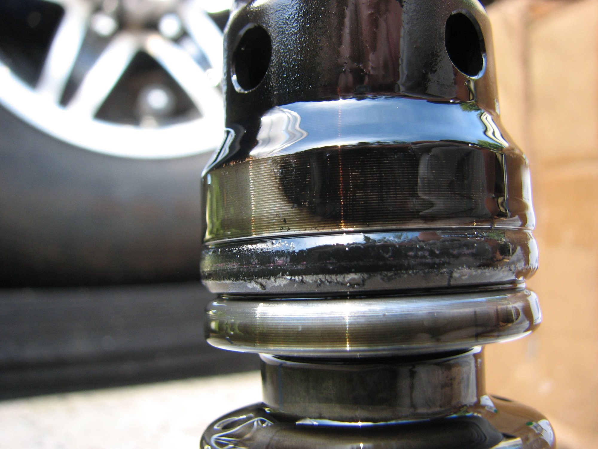

Did you remove these bolts?
no
Could this impact boost and egts?

See the dark brown and black burnt areas? That can mean combustion gasses coming past your copper washer/seat.
Possibilities: Loose injector, worn orings and copper washers, bad cups (I think, my cups were okay)
Don't worry about the fuel bowl, you'll want to change your oil anyways
Scott's giving good advice, so I'm filling in the stuff I'm most comfortable with saying

Those O-rings are shot. I don't think that will impact boost and gets (that is usually a leaky up-pipe or loose boots) Those O-rings will impact the way the motor runs/sounds/vibrations.
