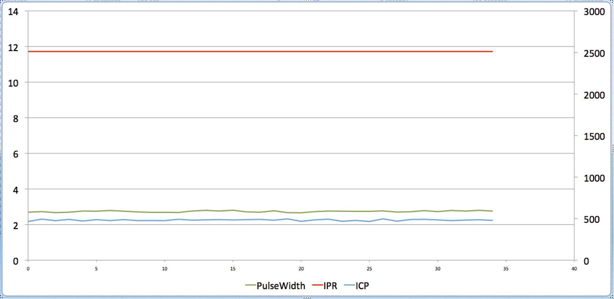

Originally Posted by tjmike
At Idle
IPR is 11.72
Pulse Width 2.66-2.88
ICP 466-497
Isn't that a LOT of fuel for idle?
At Idle
IPR is 11.72
ICP 466-497
Could you change the scale on the right for ICP to 0-3000 psi, with it set the way it is it makes it look jumpy.

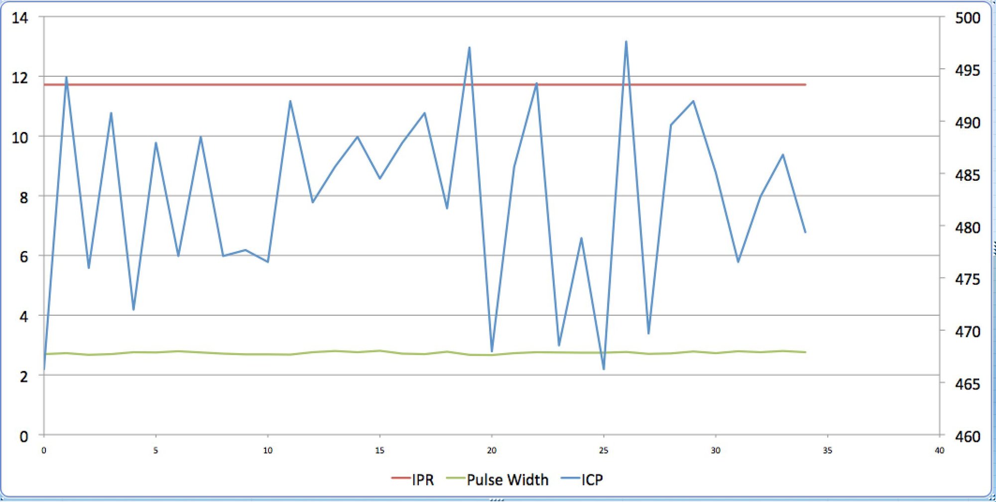

Better?

Your idle graph looks good to me. I sure would be tempted to rebuild the turbo but I still don't get the high EGT's.
