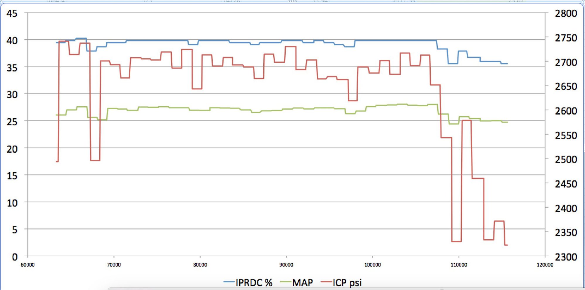

Here's some PERDLs and IPR data:

With that data, your ICP is not exactly where I'd want to see it with the IPR you show. I'm starting to suspect injector O-rings or a bleeding stick in a big way. What's your idle IPR?

At Idle
IPR is 11.72
Pulse Width 2.66-2.88
ICP 466-497

Did my idle IPR reveal anything helpful?
