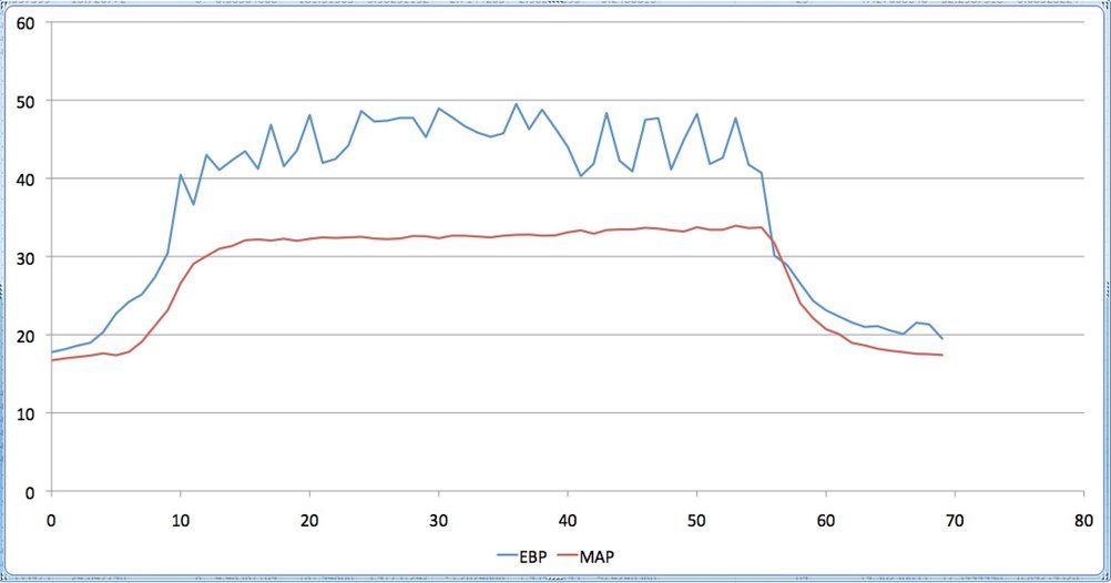

With the red tube plugged onto the CAC tube clamp (so no waste gate) what is the max backpressure I should be seeing?
I've seen it in the 47ish range taking into account the EBP noise. I'm trying to figure out what direction to go next. I don't want to just throw all new injectors in or a new turbo and pray they fix this.
I'm trying to focus on EBP because a partial blockage will address these issues right:
1) Lack of max boost
2) High EGTs under load
3) Bouncy EBP (could be a red herring though - example below)
I know when the engine is off the EBP is fully open - at least the lever is against the stop. However, I don't have any easy way to see if it's moving for some reason when running at WOT.
It's hydraulically actuated right - so is there some failure mode where the hydraulics might partially close the EBP?
Also, to make sure I understand. The waste gate will always be fully open well before max boost, so looking into wast gate issues shouldn't matter.
http://cimg6.ibsrv.net/gimg/www.ford...f5f4b77a0f.jpg

Those EBP readings would make me start looking at a possible bad EBP sensor, a cracked EBP sensor tube or a boost leak. I would also take the turbo out and take a look. It's not too hard at all. Definitely easier than the work you just performed.

Watch the "diagnosing by the numbers" thread, you'll see some very different results there. 40 PSI EBP and 21 PSI boost with his red line capped on a stock truck/tune. The EBP still rises and falls, but you can clearly read the value. Don't look too hard at the degree of rise and fall unless you compare the waveforms on the same scale.
I think we're looking at a bum turbo, a lying EBP sensor (they read high when they fail), or a weird dynamic in the exhaust. The EBP/boost ratio is just not in line, and your EBP is plenty high enough to make gobs-O-boost. Even with a stock tune, I was able to get my truck to defuel (just over 22 PSI boost) with nothing more exotic than a 4" exhaust and an AIS.
