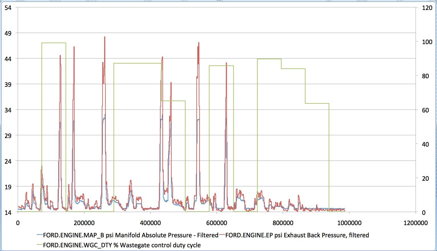

Adding Wastegate duty cycle
I have some wastegate info. These are very short WOT runs and the sampling rate is lower than on my previous charts. X-Axis is milliseconds.
I don't yet know how to interpret this, but it seemed strange to me for it to be going between zero and 99 percent like that.
I think that at 100% the waste gate is closed (so max boost) and at zero the waste gate is in max bypass mode. Is this correct?
Also is this driven by MAP, Boost, EBP or some combo?

What happens if you cap the red line to the wastegate actuator?

Red tube capped:
Zoomed:

Forget those wastegate graphs. The PID is only getting sampled every 70 seconds or so. I'm not sure yet if I can control the sampling rate for different pids.
