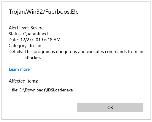

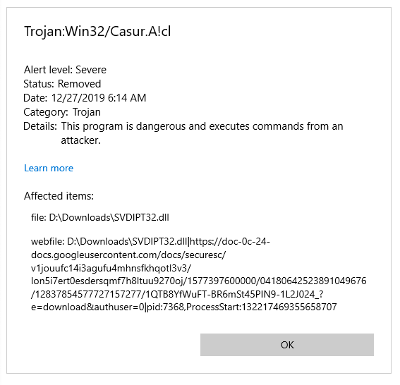

Thanks again for putting in the time to get this figured out. What is the advantage of upgrading to V116?
FYI, Windows Defender flags both of the files required for the update as trojan viruses.

@DungBeetle the benefit of upgrading to 116 is I believe that it supports the newest vehicles and you don't have to keep adjusting your system time if you use the laptop for more then just servicing your truck like I do. The adjustment of the system time will keep most all of the websites working due to the servers report a different time and date that your computer has.
Is your Windows Defender updated? I just ran the entire folder through Windows Defender on Windows 10 Pro 64 bit and mine shows no problem with either of these files. I even downloaded them from my Google Drive and tested that copy just to check. Depending on what sources you test them against you will see false positives.
I believe this is a false positive on both files because of how this program works and your virus definitions not being updated. IDS Loader and SVCI have to do things in order to make IDS work, to my understanding it is bypassing the license and also enabling the J2534 controller to work. Running the original and the copy I have on my Google Drive through VirusTotal.com will show IDSLoader and SVCI have reports saying it is suspicious. Ran the files through https://virusdesk.kaspersky.com and it shows they are clean as does my copy of Windows Defender. Google Drive would of also blocked the file as it scans for viruses.
Full system scan showing clean
Showing newest version of virus and threats are updated, well 1 day old

That's interesting. Would you mind telling me where you got the files from?
I always have some reservation about files coming from China.
