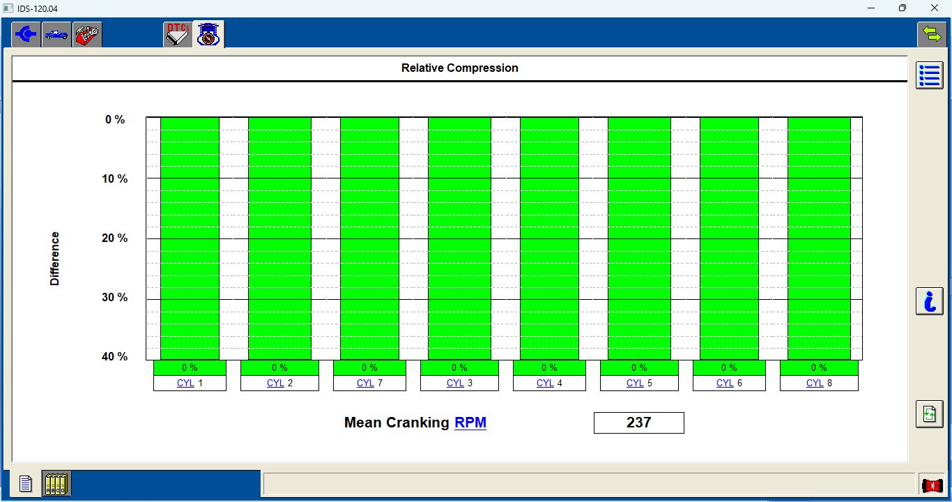

This evening I officially 'returned to stock' using the LiveWire 9600 device. I let it get up to full operating temperature and took it for a short drive. My butt-cheek dyno could tell that it did not have as much acceleration power, but it still is decent power. Maybe I'm crazy, but the exhaust seemed to have a different smell to it as well. I re-ran the injector contribution test again and it came out very flat again. I tried the WOT method for the relative compression test and it started up again...so I just pulled the FICM relay and it worked fine. Great results, but seems almost too good to believe. I would have expected a slight variation somewhere.
I decided to pull codes with IDS since I had it hooked up and now with the 'stock' PCM tune I generate a P0407 code for EGR missing. I've never had that show up before. Note that even IDS say the the MIL (check engine light) is turned off for this code. How did someone get into the core of the stock tune and turn off ALL my MILs? I really don't like that.

Was that hot or cold? I've seen others with all at 100%. My old engine had one at 5%.
That was with the EOT at full 190*F temp for at least 20 minutes.

I'd run a relative compression check cold then too. Keeping the FICM relay out is a good idea. If you run the batteries down during the test, it won't then try to operate the FICM at low voltage and could possibly damage it. Or make sure there is another battery jumped, or a high-output charger connected when doing the test.

I just re-ran the test. Got 0% across the board again. Average cranking rpm dropped down to 207 instead of 237 this time, which makes sense.

Then you are perfect! Warm expansion can hide a little thing.
