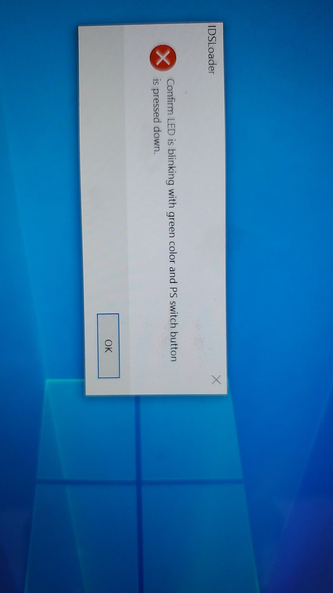

Het just wanted to give a heads up, my FDVI device seems to have broken. It's seems to be a hardware issue in contacting the manufacturer. I sent them a screen shot of the error message I am getting and answered a few questions through their online chat and they said send it back the device is broken. Nit sure what happened but I am going to look into sending it back. Just have no idea how long that will take. Might just order a new one.
Old Apr 1, 2020 | 09:01 PM
  #309
Motohead911's Avatar
Motohead911
Joined: Aug 2018
Posts: 934
Likes: 248
From: CA
Also the LED was flashing green, that is why the manufacturer said it is defective, and told me to send it back.
