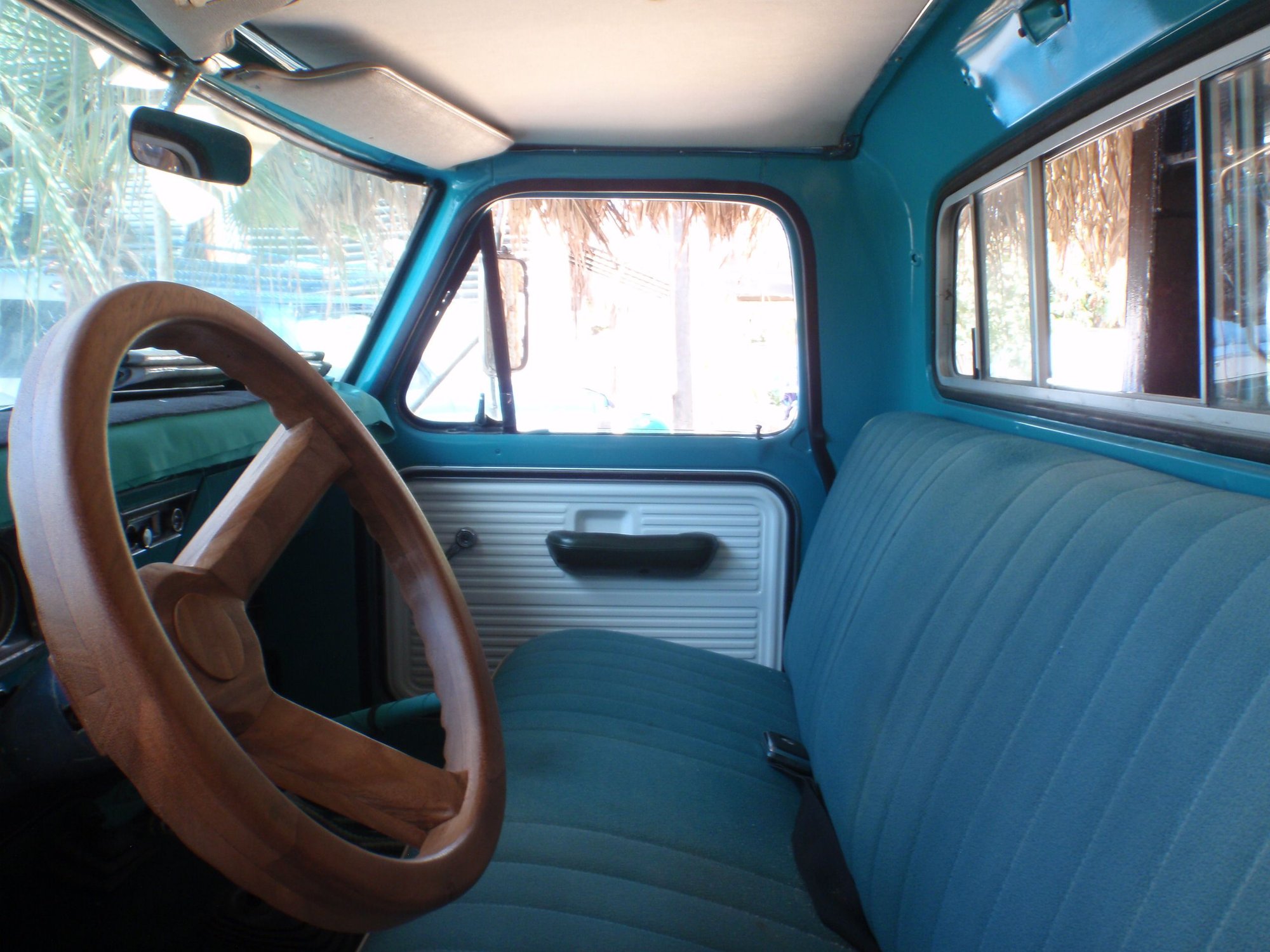

I have toyed with the idea of changing to a tilt column, but have questions like the one you just answered. But, with the tilt column....
1) Does it really give you more room behind the wheel? And, (2) is their a column-to-firewall difference for the manual shift columns? No neutral switch problems I take it. I still like your brake lines with the line shields. Plenty of dirt & gravel roads in Baja, and in fact, my little village only has 3 paved roads. Directions always start with "Turn off the paved road"... I actually had 40 yards of gravel (3/4" minus) spread in the road in front of my house. It keeps the dust down some, announces visitors, and the wandering cows will not walk on my side of the street. The system here is to fence the cows OUT of your fields, and free-range them to fend for themselves. Slow driving, and big bumpers are common ways to avoid hitting one. But, I digress...
Baja
Baja
I'm not a real big guy but with my previous fixed column and stock 17" diameter steering wheel, there wasn't much room between the bottom of the steering wheel to the top of my legs.
This is just a personal preference/opinion but, I'm not a fan of the stock steering wheel that was in my truck. Now that the truck will have power steering, it's rather pointless to have a big 17" steering wheel. Its leverage was needed with the manual steering gear box but now, my leverage will come from the power steering pump/gear box so, a big steering wheel won't be needed to turn the front wheels.
I replaced the stock steering wheel with a 13.8" diameter Momo Monte Carlo steering wheel ('Monte Carlo' is the series name of the wheel -- not that it's for a Chevrolet Monte Carlo).
MOMO MCL35BK1B MOMO Steering Wheels - Free Shipping on All Orders @ JEGS
Just the change to the smaller steering wheel reduced the diameter by 3.2". This alone gave a good bit more clearance between the bottom of the steering wheel to the top of my legs, when sitting in the drivers seat, without the column being tilted.
I'm not sure if there were tilt columns for manual transmissions with the shift lever on the column (I don't THINK there was but could be wrong about that). I do know there were tilt columns for manual transmissions with the shifter in the floor but, I believe they are somewhat rare.
Here is a link to some information about the '78/'79 tilt column.
How to Install a Tilt Steering Column - FORDification.com
The type of steering gear box (Ford/Bendix or Saginaw) also has a direct affect on what column to use or, modifications (shortening) that may or may not be required. --it just depends on what components you're using.
How to Install Power Steering in a 2WD F100/250/350 - FORDification.com
This photo shows the difference in the column to firewall seals. My '69 manual steering column seal on the left. 1978 PS tilt column seal for a Saginaw gear box on the right.
I don't like cutting the wiring if it's not absolutely necessary. Since I'm having to back track on the column seal, I haven't gotten to the point of figuring out what I'll do about the NSS/backup lights switch. That's something to deal with at a later date.
Old Nov 17, 2014 | 09:46 AM
  #120
bajafishnut's Avatar
bajafishnut
Joined: Nov 2005
Posts: 2,694
Likes: 45
From: La Ribera, Baja, Mexico
I have been thinking lots about the tilt steering column, but have not wanted to spend the money for the ones on Evil Bay. My truck is a mix of '67 to '72 parts, with a '67 cab, and a '72 Highboy chassis. I am with you on the steering wheel not being my favorite in the world. I removed all the hard plastic, as it was sun/age cracked, and covered the steel with a Mexican jungle hardwood called 'Paroda'. It looks way better than the plastic, but it is still the big diameter wheel. You are right about the big wheel not being necessary after adding power steering. Also, having a manual 4 speed trans, on the floor, I have un-answered questions about the swap to tilt.. Guess I will cross that bridge when I get to it... First, is to find a '78 /'79 tilt steering column in a JY... OK here is the first version of my wooden wheel...
Baja
